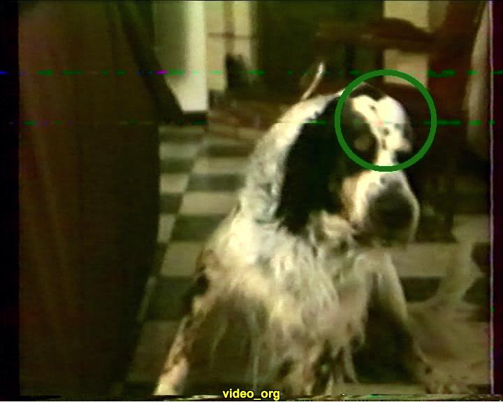

    And here is an example of the problem I'm facing. Original source on the left (video_org) , restored video on the right (video_restored). The dog in this scene is moving, and you can see that the scrathces lines are removed, but the black spots on the top of the dog's head are missing :
    What can I do in this script to soften the post processing? The main goal is to remove the scratches lines and to keep the blak spots.
    Unfortunatly I can't provide any video example, only this still image as the video is not mine.

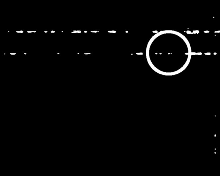

  7. Originally Posted by Hunk91 View Post
    I still have some white/bue/red lines appearing but they are reduced compare to the original.
    You can use stronger settings and an alpha mask to get rid of more "dirt" while protecting other areas. Using the single frame from your sample image:
    Original image:
    [Attachment 64055 - Click to enlarge]
    Alpha mask of red and purple areas:
    [Attachment 64056 - Click to enlarge]
    Original image with red and purple areas replaced with green:
    [Attachment 64058 - Click to enlarge]
    I used green for "fixed" areas just so you could see what areas were changed and what areas weren't (without a video sample I can't really fix those areas). With the original video you would just use very strong RemoveDirtMC settings -- settings that are so strong they damage other parts of the image, but since the areas are protected by the mask the damage isn't passed through to the final output.
    ImageSource("scratches.png", start=0, end=23, fps=23.976)
    Crop(102, 56, 720, 576)
    ConvertToYV24()
    # build a mask of moderately saturated red areas with MaskHS
    redmask = MaskHS(StartHue=80, EndHue=125, MinSat=20, MaxSat=150).ConvertToYV24().mt_expand.Blur(1.4).GreyScale()
    # build a mask of moderately saturated purple areas with MaskHS
    purplemask = MaskHS(StartHue=0, EndHue=20, MinSat=20, MaxSat=150).ConvertToYV24().mt_expand.Blur(1.4).GreyScale()
    # add the red and purple masks together
    rpmask Overlay(redmask, purplemask, mode="add")
    # build an alternate version of the video that's all shades of green
    alt = ColorYUV(off_u=-256, off_v=-256).ColorYUV(off_u=100, off_v=100)
    # replace all the red and purple areas with the green video
    Overlay(last, alt, mask=rpmask)
    I know you also have some white streaks so you would have to add those areas to the alpha mask. But again, without a sample that shows those areas I can't really show how it would work. This is why it's important to provide video samples.
