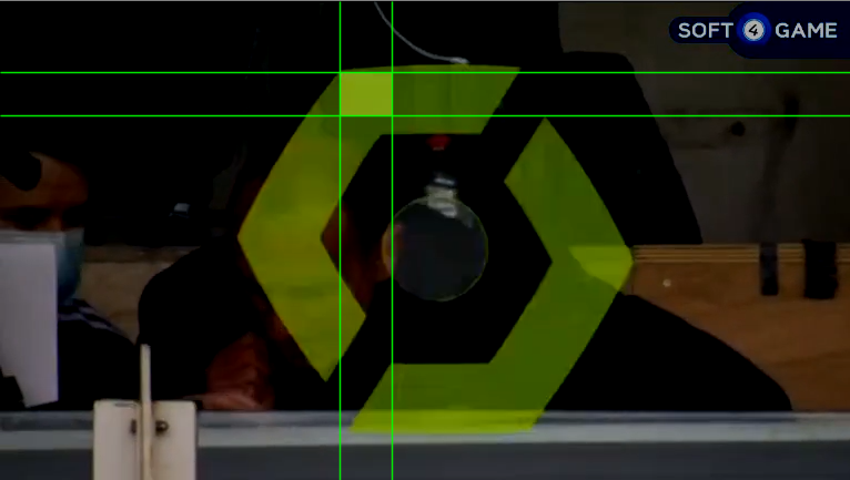

    Hello:
    I want to know if you use MS-Paint to locate the coordinates, and if you use the red squares as I indicated in the picture, then I found the coordinates in my picture seems different from your code.
    Can you show me a picture like I did that you used in your code for crops?
    By the way, do you have a utility for this kind of job to show here?
    Thanks,

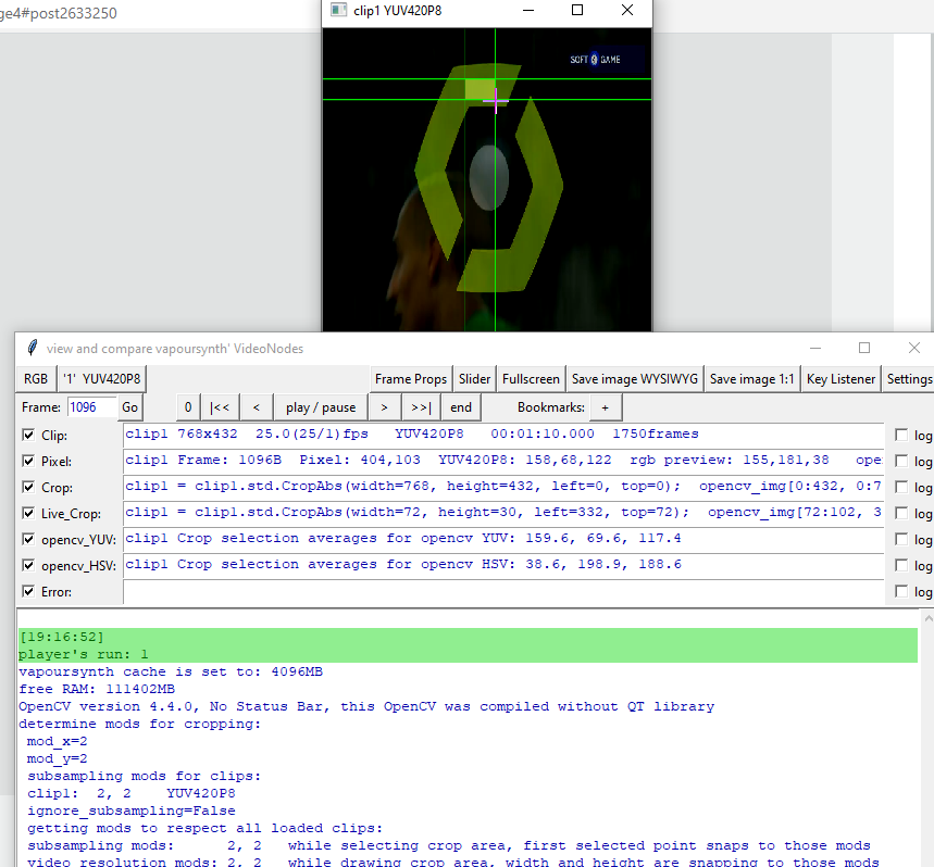

  3. the rectangles were roughly in same area as you posted, I use vapoursynth previewers, which you do not use, but whatever works
    I will post some utility, let me put it together

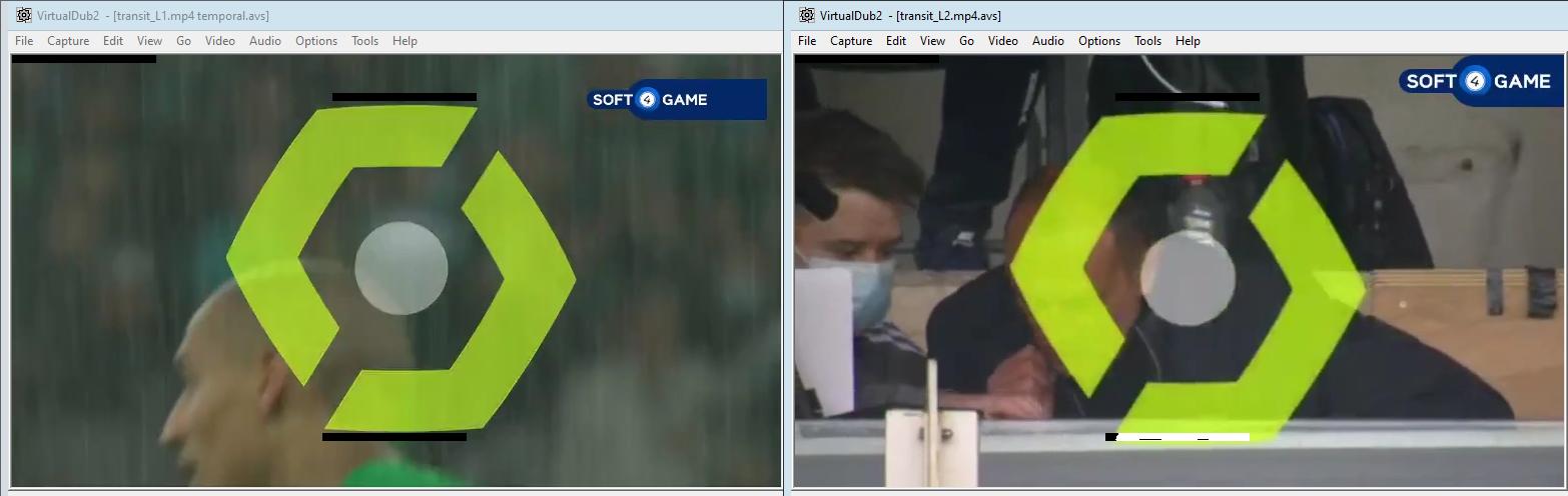

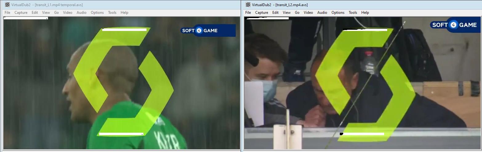

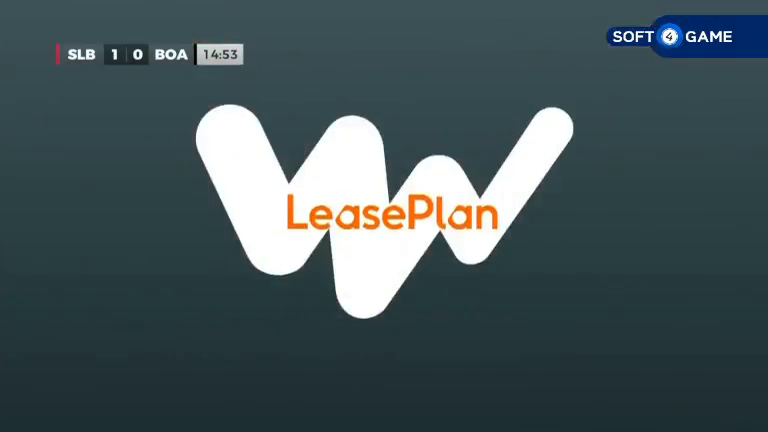

  7. Transit_L2.mp4 works with my script but returns an extra frame because the video has lots of duplicate frames; and one of the duplicates happens to be a match frame. Also the script is not optimal for L2 because the alignment of the logo is different. A frame where the logo is static (no match):
    [Attachment 60948 - Click to enlarge]
    On the left is L1. You can see that the test patches are just outside green logo. On the right is L2. One of the test patches is within the green portion of the logo and is a match. Overall it's not a match because the other patch is negative.
    On a frame with a positive match:
    [Attachment 60949 - Click to enlarge]
    You can see that both patches of L1 are just within the logo -- as the test was designed to detect. With L2 the logo is in a different position so one of the patches is partially outside the logo and the other is deeper within the logo. It still matches but it's not optimal. But even the two patches were in optimal positions there would still be two matches if there are two identical frames (as in the second time the logo appears in L2).
  8. I guess my choice was more lucky, rectangles fell in both transitions in the area, so to explain why it worked, example for first rectangle, not sure about second one, but guessing something similar happened:
    Actually, the principal of selecting only first found frame of the whole transition gives result of selecting one frame only.
    Sorry, that first sentence above could be misleading. Yes area fell in, but setting wider ranges and position that is shared with other frames causes to return more frames from that transition. The code ignores other found frames in a particular transition..

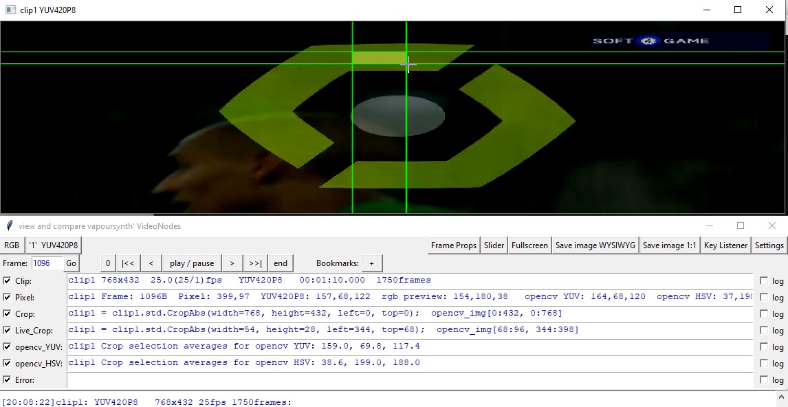

  9. just looking at those png's, Hue is almost falling into green territory, between yellow and green, looking into this picture:
    https://answers.opencv.org/upfiles/15186768416857101.png
    so easily this would work also, selecting hue from 30 to 40:
    lower = np.array([30,125,0])
    upper = np.array([40,255,255])
    when I was guessing a hue, I'd swear it was nice yellow hue, but it is almost green hue, something between yellow and green.
    That original hue selection was working as well, from 10 to 40, just saying, how our eyes sometimes could trick us.
    But yes, it depends on the background, so it was safe to select all yellow hue range.

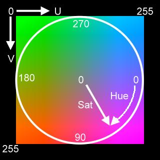

    I don't understand that image. A full circle is 360 degrees, not 180 degrees. Does opencv use their own definition of hue?
  14. In opencv Hue range is [0,179], Saturation range is [0,255] and Value range is [0,255]
    so those values fit 255 range, they just use it like that I guess because of computing, so it fits into one byte
  15. Originally Posted by _Al_ View Post
    Ah, thanks. So it's hue/2.

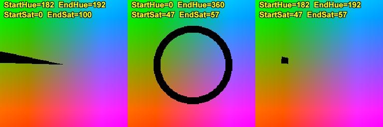

    Here's the relationship between UV and HS in AviSynth:
    [Attachment 60980 - Click to enlarge]
    And an animation using MaskHS to convert specified ranges to black:
    [Attachment 60982 - Click to enlarge]

  25. This time I just eyeballed it using the image in post #105 then narrowed the range until it covered just the areas in question. I also gave you a method using an Animate() script in post #80.
    Looking at the numbers in post #111 I think the software you are using is using the opposite rotation for hue.
  26. ok, I uploaded a utility that helps you tremendously to get all opencv crops and range values for you, so you just copy/paste them them in your python scrit,
    download: Comparator.7z
    unzip it into a directory it contains bunch of directories and loose files, it is portable setup, nothing is installed, and use Comparator.exe that you find in there after you unzip it, you can put its shortcut on your desktop. Utility is self sustained, you do not need to even have vapoursynth, opencv or python installed! But of course you have python and opencv for other purposes installed, actually using python code to come up with those frame numbers based on values obtained by Comparator.
    You can run it as is, without any file, it will load colorbars, so you can investigate how it works. You can play video, find frames, navigate in it.
    You can even load simultaneously more files, even vapoursynth scripts! Use Scroll on your mouse to zoom in or zoom out for convenience.
    Or you just drop your videofile on it, I will explain the workflow with your transit_L1.mp4 file
    1.drop your transit_L1.mp4 on Comparator.exe or use command line: Comparator.exe transit_L1.mp4
    of course use correct paths if using command lines
    2.set it up as on first image, find first clear transition graphic, I found 1096 frame, then on that frame use your mouse and select crop approximately as image shows.
    Copy that opencv cropping data from GUI (select in GUI and use Ctrl+C) and paste it for that first rectangle in your python editor in your code. Then investigate average values from GUI, this time for opencv_HSV, for that selection and use it in python code for lower and upper. If it says H average is 38.9, then something 30 Hue value for lower and for upper 45. Saturation average is 198.5, so I've chosen 125 to 255. HSV values are (Hue, Saturation, Value)
    That python editor, where you paste those values from GUI, is whatever you will have in your PC to edit python code. That is your app that you will put on screen as well. I used IDLE, but you can use whatever else, IDLEX and others.
    3.On the same frame, select other rectangle, again use mouse to choose another selection and then again paste those crop coordinates from GUI and then come up with lower and upper values based on average values in GUI.
    In our example lower and upper values are the same for both selections, but different color transitions gives you something else. Like that transparent soccer ball from your previous videos, we used two different colors blue and purple.
    4.run python code, it will return:
    1095
    1543
    used code, as seen in images:
    import numpy as np
    import cv2
    first_found_frame = -11
    def process_img(img_rgb, frame_number):
        r1 = cv2.cvtColor(img_rgb[74:94, 324:366], cv2.COLOR_BGR2HSV)
        upper = np.array([45,255,255])
        mask1 = cv2.inRange(r1, lower, upper)
        if np.average(mask1) > 140:
            r2 = cv2.cvtColor(img_rgb[304:332, 460:492], cv2.COLOR_BGR2HSV)
            mask2 = cv2.inRange(r2, lower, upper)
            if np.average(mask2) > 140:
                global first_found_frame
                if abs(frame_number-first_found_frame) >10:
                    first_found_frame = frame_number
                    print(frame_number)
    vidcap = cv2.VideoCapture(r'D:\downloads\transit_L1.mp4')
    frame_number = 0
    while True:
        success,image = vidcap.read()
        if not success: break
        process_img(image, frame_number)
        frame_number += 1
    vidcap.release()
    ##https://answers.opencv.org/upfiles/15186768416857101.png
    That utility is quite elaborate so ask whatever you need to know how to work with that, I just made it on the top of vapoursynth previewer.
    Also opencv loads video using BT601 always, and RGB to YUV is full to full so those values that you can read consist with that, so running calculation later are correct.
    If using it without opencv intensions, for other purposes, uncheck opencv_YUV and opencv_HSV to speed up things, because there is a lots of arrays to handle on the top processing opencv
    Also I forgot to default AVI files to load with ffms2 source plugin, I left it to use AviSource, which needs a codec in windows system. Later I will change it to ffms2 so those codecs are not needed. For now for example if using DV.avi it needs DV codec in PC etc. BUt on the other hand, if using Avisource it can load frame server avi's like from Sony Vegas or Premiere, I see no reason why it would not work. But perhaps not your problem or case.

    Thank you so much for your such intelligent work. But I need some time to learn how to it.
    I copied the Transit_L1.mp4 to the same folder as comparator.exe, and run this command:
    C:\SoccerVideos\Python\Comparator>Comparator.exe transit_L1.mp4
    I visit the frame# 1096, and crop a small area, look at the picture.
    I want to know how I can read the coordinates for this crop area?
    Is it: corner: (332, 72) with size of (72, 30)?
    It seems not as shown in your Python code.
    Let me know if I understand correctly?
    Or if you can see the picture clearly enough, let me know what you think the coordinates for the corp I made.
    Thanks,
    [Attachment 61106 - Click to enlarge]
  28. Your coordinates are out of screen for me, grab the right of your GUI and stretch it to the right. Readings are on the right side in "Live_Crop" line . It is something [72:102, 3...and I cannot read the rest. Of course values will be different than mine, because you select your rectangle!
    Also:
    player does not always keep aspect ratio, that is not important with this kind of work.
    By pressing "R", that will set pixels 1:1, correct aspect ratio, app also remembers last sizes and positions for windows when closin, it remembers even last frame shown, last clip index selected (if more videos for comparison) etc.
    App uses hot keys, R for reset image to 1:1, Space Bar to start and stop playback and many more ...
    If player is still small, grab a corner and increase the size of it, whatever you like. Key "R" always sets it to 1:1 with correct aspect ratio.
    Also if grabbing the corner of a selection and holding SHIFT, it keeps aspect ratio for selection same as video.width/video.height
  29. you can always zoom-in into video , use mouse scrollbar to zoom-in or out,
    and then choose selection
    also you can fine tune selection by
    -grabbing either the whole selection (clicking inside of selection) and then moving it as a whole
    -by grabbing a corner and stretching it
    -by grabbing a single line to move it

  30. Member
    Sep 2021
    Valencia
    Hello:
    I tried again to make the image bigger, and let me know if you can see it.
    Let me know what is the coordinate for my crop.
    Thanks,Image
    [Attachment 61108 - Click to enlarge]
