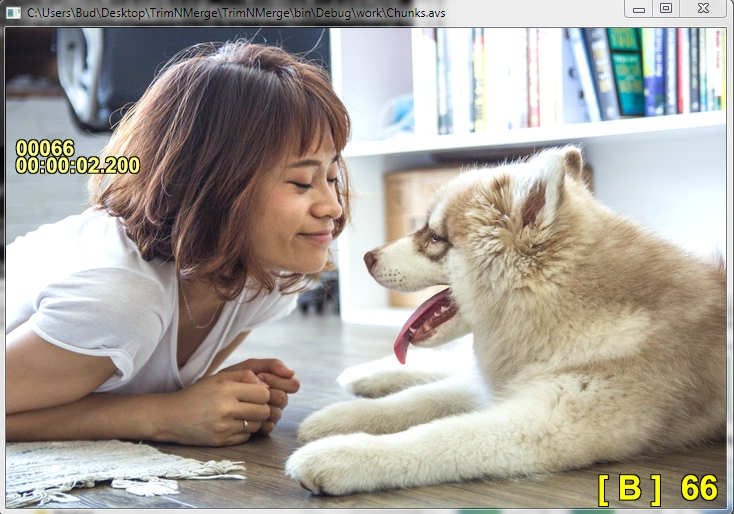

    Personally, if you have Avisynth installed, I use the following script and save it as .AVS and then drop on my favorite player with frame by frame capabilties.
    Just need to adjust the Pathe and name of video and change Atrack to -2 if there is no audio.
    ffmpegsource2("C:\Users\Bud\Desktop\Slide.mp4", atrack=-1).converttoRGB
    x = float(Width) / float(Height)
    last.LanczosResize(round(x * 480.0 / 4.0) * 4, 480)
    ShowFrameNumber(scroll=True, x=10, y=127, font="Arial", size=24, text_color=$ffff80)
    ShowTime(x=72, y=144, font="Arial", size=24, text_color=$ffff80)
    ScriptClip(Last, """Subtitle("[ "+Chr(FFPICT_TYPE)+" ]"+"  " +String(current_frame), size=(Height*56.0/720), align=3)""", after_frame=True)
    You receive a video that you can find the frame number, what the frame type is etc. to make cutting easier.

  13. Originally Posted by Budman1 View Post
    [Attachment 63563 - Click to enlarge]
    Tried it. PotPlayer does not open it.
    VirtualDub2 says:
    "test.avs does not have a video stream"
    Avisynth+3.7.1 installed.

  16. Member Budman1's Avatar
    Jul 2012
    NORTHWEST ILLINOIS, USA
    VirtualDub2 says:
    Be sure you use complete paths. If player can't find it, it will have no video and report as such. Just a note as to why it might not work...
