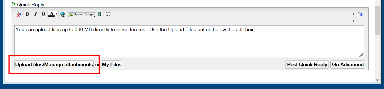

  15. You can upload files up to 500 MB directly to these forums. Use the Upload Files button below the edit box:
    [Attachment 63283 - Click to enlarge]

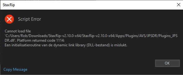

    After Enable the option QTGMC Medium I got a error.
Name:	StaxRip Error.jpg
  25. "Cannot load file"
    Check that "plugins_JPSDR.dll" is present in that directory location
    I do not understand the other part of the error message translation
    Does "mislukt" mean "missing" ? Google translate says "failed"
    I just downloaded StaxRip-v2.10.0-x64, and put in a random PAL DV-AVI file with QTGMC and it worked ok . But I have separate avisynth install, not sure if it's using that, or the portable version with staxrip

    An Initialisation routine of the dynamic link library has failed.
  27. Too early windows version?
  28. Member
    Feb 2022
    Amsterdam
    W10Pro, H21H2
  29. Member

    Now I have tested StaxRip at my test PC (i5-3570k) with some samples and I got the same error when I enable the Field QTGMC option.
    Error at line 839 and line 1044 in QTGMC.avsi.
    Enabling the others options, then OK.
    Before running StaxRip, I have also installed AviSynth.
