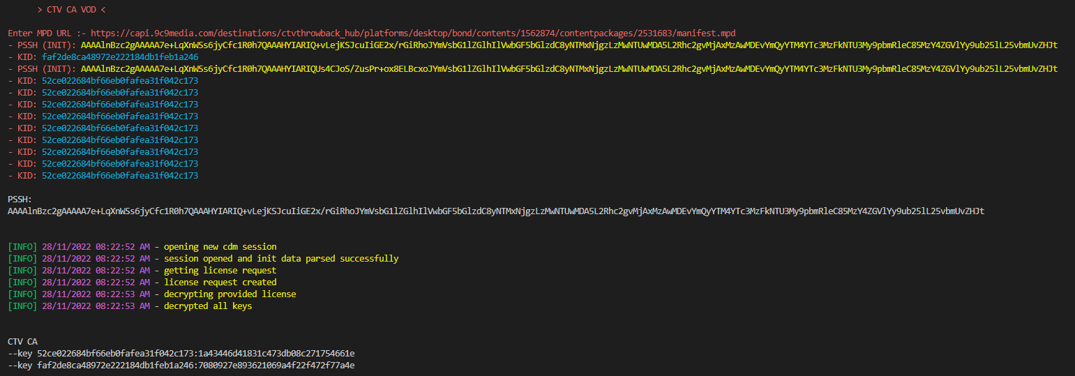

  8. the pssh is in the init.mp4... use the WV pssh Elcap gave and use axinom tools to analysis it to have a better understanding of it. lots of info in the forum to help you.
    [Attachment 67879 - Click to enlarge]
    Putting all the tools together!

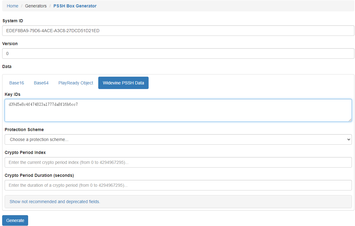

  21. Thanks, piaohua!
    I tried the axinom tool, but obviously I was doing something wrong.
    When I input the KID into the "System ID" field, I get this for "Generated PSSH Box" (Base64): AAAAIHBzc2gAAAAA051ejE9HSCOhd32o8WtsxwAAAAA=
    What am I leaving out?
    Thanks!
  22. Member piaohua's Avatar
    May 2023
    中国
    [Attachment 72758 - Click to enlarge]
    Like this!

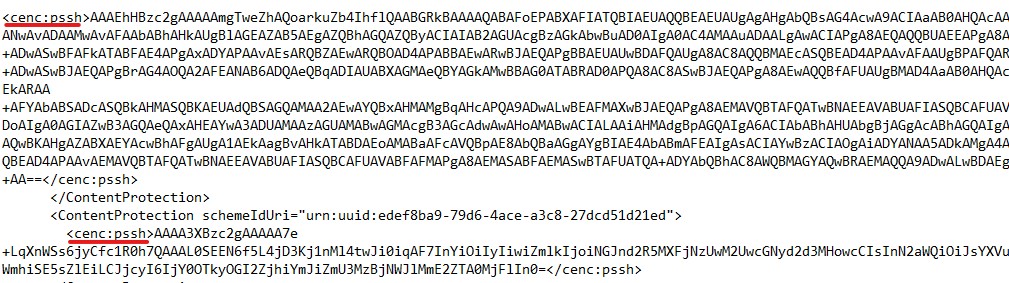

    Hi I'm newb, I found there are two PSSH vaule in the mpd file which one is very long and other one is shorter. I tried convert both to Hex and they're start with 8 digits+7073, so I'm wonder which one is vaild one. Pls kindly help to look it. Thanks.
    [Attachment 72839 - Click to enlarge]
  25. use the short one ... 7e+ in the characteristic signature of widevine
  26. Originally Posted by chinn216 View Post
    Originally Posted by ridibunda View Post
    PSSH system ID (for Widevine, EDEF8BA9-79D6-4ACE-A3C8-27DCD51D21ED)
    use the one that matches the widevine system id, ie. the shorter one
  27. Originally Posted by ElCap View Post
    Thanks for you both

    https://tools.axinom.com/generators/PsshBox
    not more free
