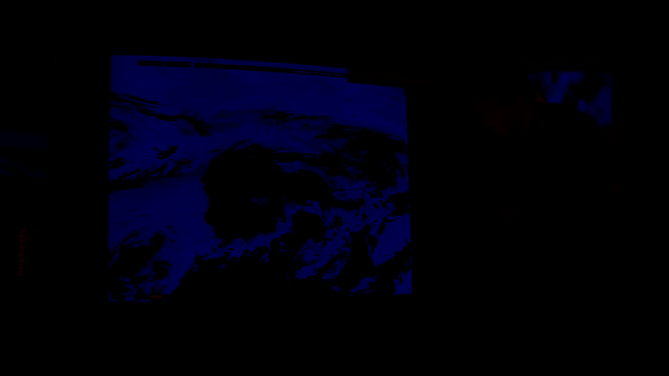

Hello. I am trying to use Vapoursynth's KNLMeansCL plugin to denoise a 1080p 8-bit source, and I'm running into issues. My goal is to take the 8-bit source, denoise, and convert it to 10-bit to use with x265's Main10 profile.
Initially, I was running into the same problem Selur posted about on the KNLMeansCL GitHub page: https://github.com/Khanattila/KNLMeansCL/issues/42.
There, the plugin author states:
The easiest and fastest thing is to promote a video from the YUV420P10 to the YUV420P16 and work with it. Then if you prefer you can go back to 10-bit.
With that information, I then tried:
YUV420P8 -> YUV420P16 -> Denoise -> YUV420P10
Which runs, but the test video's luma appears to be messed up, and is really dark:
[Attachment 62947 - Click to enlarge]

				Results 1 to 14 of 14
	Is the source "normal" SDR ?
 Is that screenshot the encode or the preview before the encode ?
 That's a screenshot of the encode

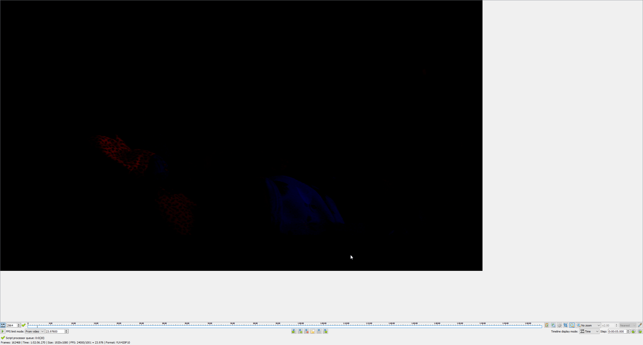

 Does the script itself preview ok without encoding ? e.g. in vsedit ?
 Good call. I was nearly certain I checked this earlier, but after running it again, there does seem to be a runtime error:
 Error forming pixmap from frame. Expected format CompatBGR32. Instead got 'YUV420P10'.
 If I comment out the conversion back to YUV420P10:
 Error forming pixmap from frame. Expected format CompatBGR32. Instead got 'YUV420P16'.
 VSEdit script check passes, though, for whatever that's worth. I'm not quite sure what this means, but I can infer that it is expecting RGB and instead is receiving YUV?

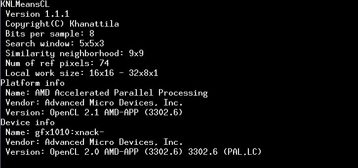

 Temporarily comment out the YUV420P16 line, and for KNLMeansCL, add info=True and to see if device_id=0 is the correct GPU device and that platform info looks correct when previewing
 Awesome, thank you for the tip. I will try that right now.
	Those messages are for the preview generation in vsedit (they get converted to RGB for display , the underlying data, script is not affected)
 Are you using R57, API4 ? If so, vsedit requires the mod version
 https://github.com/YomikoR/VapourSynth-Editor/releases
	I am on R57, but I did not have that mod - much appreciated! Here is my output from Info (looks like it is pointing at my AMD card as I have an Intel chip):
 [Attachment 62957 - Click to enlarge]

	If you comment everything out, except the source filter, does preview look "normal ?" ie. Just the source loaded
 If it's still off, did you try other source filters ? ffms2 ?
 Is the source "normal" in a media player ? Just playing it in mpv, vlc etc...
 Commenting out everything but the KNLMeansCL filter looks like this:
 [Attachment 62963 - Click to enlarge]
 I think this is what you were asking? Let me know if I misinterpreted.
 I tested every line independently, and then turned them on 1 by 1. It seems the common denominator is KNLMeansCL.

	1) To be clear - I mean does video alone look normal , with that source filter only. ie. Does it ever look normal in vapoursynth/vsedit - or is it a source filter problem to begin with ?
 Code:in_src = r"M:\Source\Source.mkv" in_cache = r"M:\Source\Source.lwi" clip = core.lsmas.LWLibavSource(source=in_src, cachefile=in_cache) clip.set_output()
 2) Also try the other openCL device (intel), device_id=1 , to rule out some driver issue with AMD
 3) What version of KNLMeansCL ?
 If you haven't tried, try the dualsynth version , pinterf
 https://github.com/pinterf/KNLMeansCL/releasesLast edited by poisondeathray; 18th Jan 2022 at 11:36.
	Oh I see. Sorry. Yes, the video looks normal in preview, unless KNLMeansCL is introduced.To be clear - I mean does video alone look normal, with that source filter only. ie. Does it ever look normal in vapoursynth/vsedit - or is it a source filter problem to begin with ?
 Small rant - I changed to device_id=1, and received an error that no OpenCL supported device was found...fine. I tried to download the OpenCL runtime from Intel, jumped through their insane account creation process/requirements, and it says my login info is incorrect. So I haven't been able to test this.Also try the other openCL device (intel), device_id=1 , to rule out some driver issue with AMD
 1.1.1, which appears to be the latest.What version of KNLMeansCL ?
 Awesome! I was unaware of this, I will try it. Thank you again. If you have any other suggestions, please let me know. The source is horribly noisy, so I want to test with a proper denoised clip to compare.If you haven't tried, try the dualsynth version , pinterf
