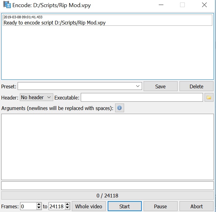

  1. i have a vpy script i have to run on DVDs and some mp4\mkv files, i have a seperated script for each.
    all of them need to be , x265 , 10bit , crf18 , 720p , mkv .
    what would be the best way to do it so it would look like in the VSedit preview?
    [Attachment 48317 - Click to enlarge]
    if so what do i type in?

  4. and encoding directly in VS Edit it seems to work as well, it is convenient, you can save your preset in there
    script:
    import vapoursynth as vs
    from vapoursynth import core
    input = r'C:\path\your.input.mp4'
    clip = core.ffms2.Source(input)
    clip = core.std.SetFrameProp(clip, prop="_FieldBased", intval=0)   #making sure it is flagged progressive
    clip = core.resize.Lanczos(clip, 640, 360, format = vs.YUV420P10)   #changing resolution, or not, but changing it to 10bit
    clip.set_output()
    I selected executable and then put this into that UI:
    --y4m
    --frames {f}
    --input-depth {bits}
    --output-depth {bits}
    --input-res  {w}x{h}
    --fps {fpsn}/{fpsd}
    --crf 18
    -o "{sd}/{sn}.h265"

    when i open the preview in VSedit , what do i see? do i see a lossless image of the source + the filters?
    will there be differnce in quality between the methos? or will they essentially look the same if all are "crf 18"? (vs edit encode , .py , staxrip)
    i like the .py method , as i created a script for each instance and just have to click on it and wait .
  16. Originally Posted by zanzar View Post
    Yes. That preview is before lossy compression is applied
    It's analogous to previewing an .avs script in avspmod, or vdub
    If the same script, same x265.exe version is used, same settings - it should be the same

    i dont know if you mentioned it , but it seems that the x265.exe needs to be at the same folder as the .py execution code.
    also i downloaded the x265 you provided here , what could be a reason to change it?
  18. x.265 executable should be in directory where the .py Vapursynth scrip is that imports the other encoding py, or in the PATH, check how to add an executable to PATH for windows
    not sure why there is a problem, cmd lines are the same, what comes on my mind atm is that I use Python 3.6 and also having older version of Vapoursynth to match that Python 3.6 Version. Which means that output() function might need something else, not sure, I will observe it closely or when I upgrade.
