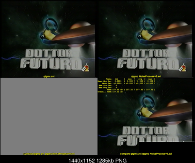

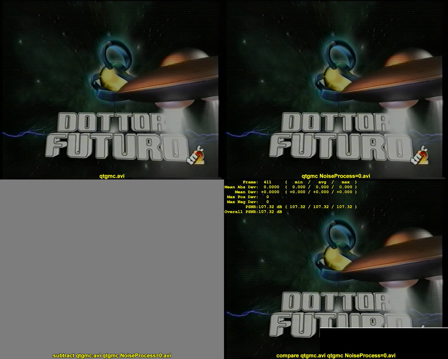

  13. QTGMC at its default settings makes all of my videos with heavy grain look like crumpled cardboard.
  14. Out of curiosity, can someone post before after images of such an occurrence? (I normally deal with content that doesn't have much noise and use QTGMC in mode 'Fast',...)
    Cu Selur
  15. Member wright96d's Avatar
    Feb 2021
    Kentucky, USA
    If you want to disable the noise reduction and sharpening, then disable the noise reduction and sharpening. This is what I use and it produces a near flawless output.
    SetFilterMTMode("AVISource", 3)
    SetFilterMTMode("QTGMC", MT_MULTI_INSTANCE)
    AVISource("$inputFile")
    AssumeTFF
    QTGMC(Preset="Slower", EdiThreads=4, NoiseProcess=0, Sharpness=0, SourceMatch=3, Lossless=2)
    ConverttoYV12
    Prefetch(16)

  17. Member Skiller's Avatar
    Oct 2013
    Germany
    Like I explained in post #6, the noise reduction in an inherent side effect of how the core of QTGMC works. There is no simple switch to turn it off. SourceMatch and Lossless settings help, but there is much more to it.
  18. Member wright96d's Avatar
    Feb 2021
    Kentucky, USA
    You're wrong. NoiseProcess=0 turns it off completely. It's called bypass mode for a reason. If there is some amount of noise reduction remaining, it's completely imperceptible.
  19. Isn't some noise reduction unavoidable (!and wanted!) when bobbing due to the nature of interpolating/upscaling (call it what you like) from fields to frames?
  20. Member wright96d's Avatar
    Feb 2021
    Kentucky, USA

    lossless bob versus QTGMC: https://imgsli.com/MjYxMDcx
    lossless bob versus QTGMC(NoiseProcess=0): https://imgsli.com/MjYxMDcy
    and finally QTGMC versus QTGMC(NoiseProcess=0): https://imgsli.com/MjYxMDcz
    compare with metrics image:
    compare with metrics movie:
    compare.avi

    [Attachment 78808 - Click to enlarge]
    [Attachment 78809 - Click to enlarge]
    1. Then what's the point of the bypass mode? It's not my fault that the guide is wrong.
    2. I suppose that means SourceMatch and Lossless are the more important settings. I did a test and excluding them produces a horrible quality output.
    3. That junk in your example is more field to field flicker than noise.
    4. Can you share the source file?
  24. Captures & Restoration lollo's Avatar
    Jul 2018
    Italy
    RTFM again, check the source code (QTGMC.avsi) and think twice before saying to knowledgeable users like Skillers that they are wrong
    Redo your test
    It was chosen in purpose to highlight the outcomes; in addition, the noise intra-frame and inter-frame is well there.
    here: https://drive.google.com/file/d/1_Ckp3NJzJ1U39RO0m_V_YLiIoUkwaymZ/view?usp=sharing
    let us know your findings
