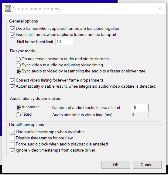

    I captured the original clip on my laptop as I was out of town but now I'm back home and I wanted to show you two different tapes with the exact same settings, so I recaptured the same part of that high school video yearbook plus a different part and I also captured a VHS-C tape home video that I think shows the quality with these settings can be acceptable (test.avi and test2.avi).
    I normally deinterlace and double the frame rate of the home videos but I didn't this time since I wanted to compare apples to apples.
    Settings:
    Sony SLV-688HF composite out
    Dazzle DVC100 (driver 2020-10-22) (still buggy on Win10. Inserts null frame every 5 secs but otherwise okay)
    VirtualDub2 build 44015 Dec 2019
    Capture filter: NTSC_M
    Capture pin: 29.970, YUY2, 720x480
    Compression: UTvideo YUV422 BT.601 VCM
    timing settings:
    [Attachment 62071 - Click to enlarge]

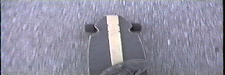

    The inserted frames occur precisely every 128 frames (~4.3 sec) and are followed by 1 good frame and then a dropped (missing) frame. So there are two motion stutters each time, and it looks worse when double-rate deinterlaced because the fields end up jumping back and forward in time when there is an insert. Having said that, the camera is shaky enough in these clips that you may not notice.

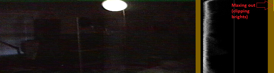

    Your brightness and contrast are both set too high. The floor has been raised without recovering any dark values, and you're hitting the ceiling. The darkest pixel in each video is Y=24 and you're routinely brickwalling whites at 255. The goal is 16-235.
    [Attachment 62073 - Click to enlarge]

    test.avi starts out okay, as far as line stability. Not perfect; reasonable.
    [Attachment 62074 - Click to enlarge]

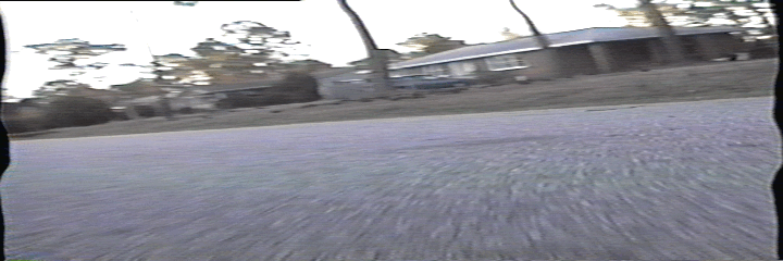

    But toward the end, when the camera is presumably getting bumped more, it gets really wavy / ripply. (Animated GIF)
    [Attachment 62075 - Click to enlarge]
    With (proper) line TBC, the black borders at the edges of the image should be perfectly straight throughout, and those tree trunks would be straight. There are also some lines in the center of this image with incorrect chroma (green tint). Line TBC should help with this too.

    Yeah the null frames every ~4.3 seconds are not acceptable but I can't do anything about that currently. It's a Win10 driver issue. I meant other than that. But I didn't think about the brightness and contrast. Does that need to be corrected on the VCR or can I do it in the video proc amp or some other setting in VirtualDub?
    If VDub's Video -> Levels menu works with your capture device, use that. It's a hook to the driver's proc amp controls, with the advantage that the preview isn't hidden when it's opened. sanlyn's post on DFAQ has good explanations of Histogram, Levels, and Cropping. (VDub's Histogram is only useful if you temporarily crop the borders, otherwise it will mislead you. Unfortunately it's really easy to forget to turn the crop off when you actually capture.)
