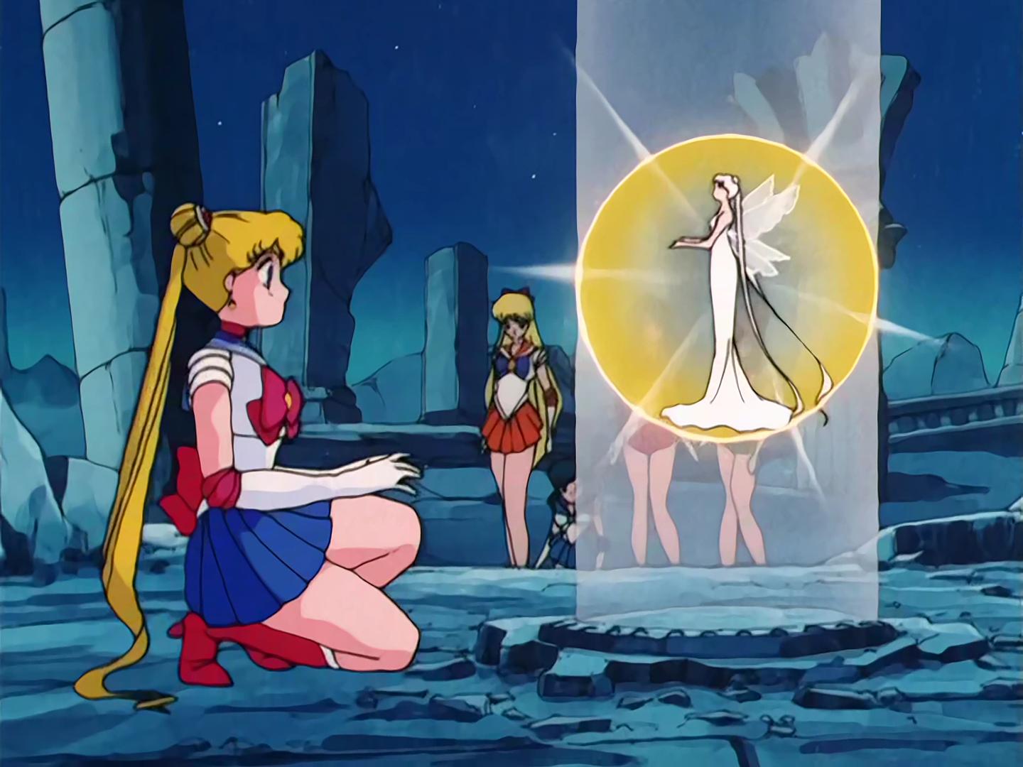

Something like ESRGAN "digital frames" series models ?
v2.1
[Attachment 61915 - Click to enlarge] -
That looks pretty close!! Do you have a link? I can’t see it on the usual wiki page of ESRGAN models.
They used to be on there...
The DigitalFrames series is trained by NKMD
https://nmkd.de/shared/ESRGAN/Models/Art/4x_DigitalFrames_2.1_Final.pth -
Here are a few examples using Vapoursynth:
(note that additional sharening, denoising, line darkening is still possible)
resized to 1920x1280:
using stepped resize using NNEDI3 + aWarpSharp:
