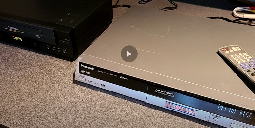

  9. Quick post:
    I bought a Panasonic DMR-ES10 (EU) and I did a little test you might like.
    No S-VHS machine, no proper capture card or anything, and uploaded to YouTube for convenience (and mangled by their compression), but the benefit of an ES10 is quite noticeable:
    https://youtu.be/xihMWvlSbyc
    That is all, feel free to carry on with your discussion...

    I was too engrossed in the movie to notice (I might get that and watch it)! Having that title split down the middle is great at showing the effect of the ES10. Thanks.

    Great comparison with all the titles.
    And it shows – no surprises here – that the ES10 helps with the usual VHS defects whereas others don't bother. Quite impressive how much better it handles the large drop outs in the last 15 seconds of the clip!
