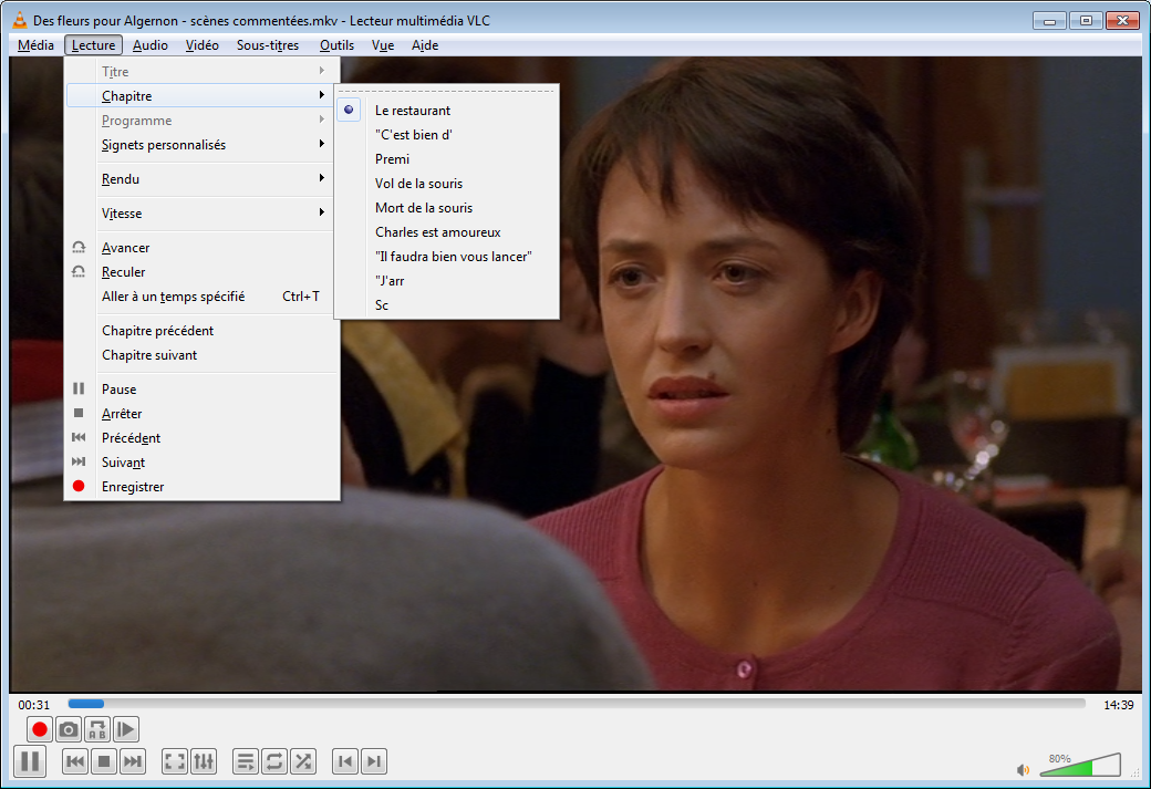

    In VLC Media Player, the titles get truncated at the first accentuated character :
    [Attachment 61591 - Click to enlarge]
    The chapters file contained this :
    ;FFMETADATA1
    [CHAPTER]
    TIMEBASE=1/1000
    START=0
    END=118040
    title=Le restaurant
    [CHAPTER]
    TIMEBASE=1/1000
    START=118040
    END=248240
    title="C'est bien d'être intelligent"
    [CHAPTER]
    TIMEBASE=1/1000
    START=248240
    END=311560
    title=Première piqûre
    [CHAPTER]
    TIMEBASE=1/1000
    START=311560
    END=487840
    title=Vol de la souris
    [CHAPTER]
    TIMEBASE=1/1000
    START=487840
    END=579440
    title=Mort de la souris
    [CHAPTER]
    TIMEBASE=1/1000
    START=579440
    END=652320
    title=Charles est amoureux
    [CHAPTER]
    TIMEBASE=1/1000
    START=652320
    END=710160
    title="Il faudra bien vous lancer"
    [CHAPTER]
    TIMEBASE=1/1000
    START=710160
    END=801560
    title="J'arrête le piano"
    [CHAPTER]
    TIMEBASE=1/1000
    START=801560
    END=879440
    title=Scène de fin
    Yet the names of the chapters appear correctly in the ffmpeg's log, and once I used the same method, with a chapter file that also contained accentuated characters, and the result was flawless (an older version of ffmpeg was used then).

  4. I solved the issue with the chapters / accentuated characters by myself : the metadata file has to be encoded in UTF-8 rather than ANSI.
