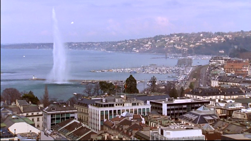

  3. Originally Posted by abolibibelot View Post
    There is a brief panning in the opening sequence (first sample, frames 265-451) which was formerly identified as being “phase shifted”. I was advised to use Avisynth's TFM() function. What is the actual difference between using setting “-1” (auto), “0” (bottom field first) or “1” (top field first) ? (I can see that “-1” and “1” have the same effect, while using “0” results in the displayed footage being seemingly shifted by one frame, although corresponding frames seem strictly identical, but frames 265-266 appear duplicated with “-1” or “1”, not with “0”, while the total frame count is the same at 141864, which is quite puzzling.) What are the rules which determine which setting should be used ?
    The order parameter tells TFM what field order to assume. If you set it wrong TFM will get confused about the temporal order of fields and may match them incorrectly. I recommend leaving it at -1 (auto), and if AviSynth doesn't already know the field order, use AssumeTFF() or AssumeBFF() before calling TFM().
    The scene transition at frame 265 (before any filtering) has an orphaned field. TFM has special handling for scene transitions and orphaned fields. It seems to me that it picked the best option, a duplicate frame. At the end of that shot (frame 451) there is another orphaned field, though it's very hard to see since the camera is no longer panning.
    In this case, since there is (apparently) only a brief shot for which this processing is needed, does the function leave the rest of the footage unchanged, only applying it where it's actually needed ?
    Usually. There are some circumstances when TFM's post processor misidentifies then horizontal lines as residual combing and applies its deinterlacer. That usually shows up as aliasing or moire artifacts. In cases like that you can disable the post processor (pp=0 or 1) or change the combing threshold to eliminate that. But either of those options might sometimes let a truly combed frame through. If you're certain that one shot is the only one with phase shifting you can just TFM() that one shot. Another possible fix is to provide your own deinterlaced frame using clip2=X. X may be something like QTGMC().SelectEven/Odd() or nnedi3(dh=true).SelectEven/Odd(). The post processor will still kick in but the final result usually looks better (as those deinterlacers are better than TMF's built in deinterlacers).
    When using TFM, I can see that there are remaining “combing” artifacts on the superimposed text from the credits : does it mean that the credits were added to the already phase shifted footage ? Or were the credits themselves likely created as interlaced video ?
    That usually means the credits were overlaid after the film was telecined. They could be interlaced or progressive (with a phase opposite that of the underling video). In this case they fade in/out at 25i -- 50 different fields per second.
    Also, using VirtualDub2, I can see that the image looks pixellated / aliased (if that's the correct word), while there is no such effect when reading the source VOBs with VLC Media Player for instance. Why is that ?
    In this video the title fades are causing false comb detection in the post processor. You can raise cthresh to 11 or 12 to eliminate that. Setting cthresh too high will let residual combing through but I didn't see any problems in that one shot.
    Then, if the goal is to obtain the best possible quality with a size roughly around 2GB (total size of source VOBs being 4.85GB), what would be the wisest conversion settings ? Is x264 with -crf 20 still considered as the best compromise for the conversion of “SD” video ?
    I usually use 18. Small defects are enlarged when watching SD video on modern large screen TVs.
    I was formerly advised to use QTGMC(InputType=1) to “clean” / “stabilize” the image — doing some comparisons again, specifically on that problematic panning, I noticed that the QTGMC processed footage appear slightly sharper in most areas, but some parts appear quite fuzzy compared with the unprocessed footage, especially around the text and near the borders. Based on the characteristics of the source, would such a processing be beneficial at all ?
    Yes, motion estimation doesn't work well at the edges of the frame, and at the boundary between moving and non-moving parts of the frame (panning behind the titles, for example). That causes QTGMC to screw up in those areas. You'll have to decide for yourself which is preferable.

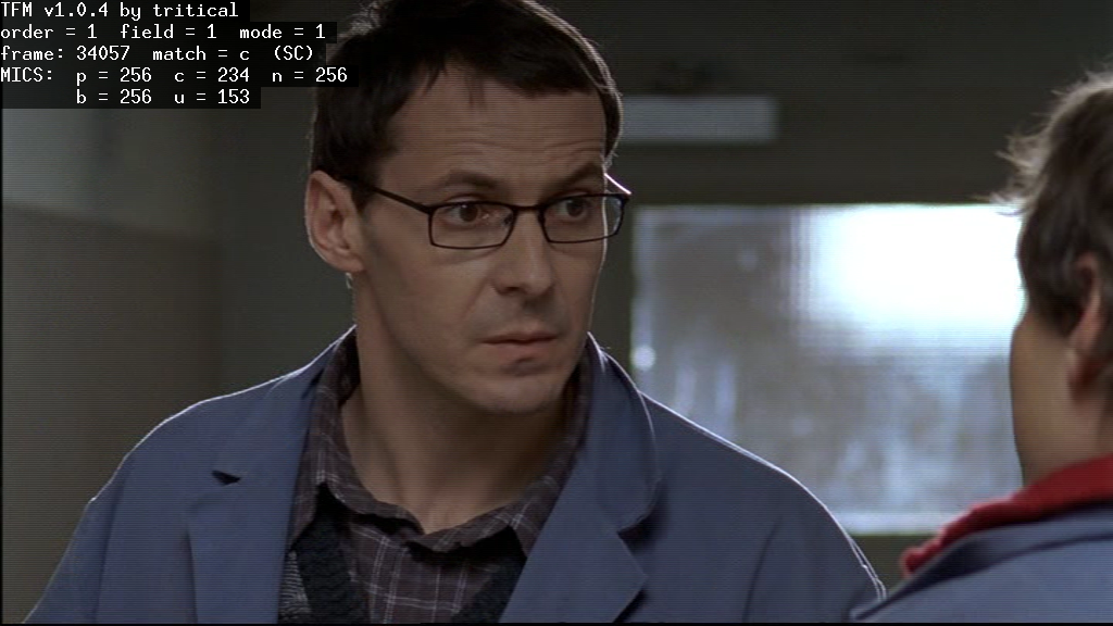

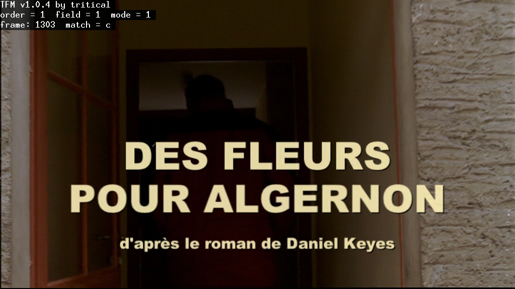

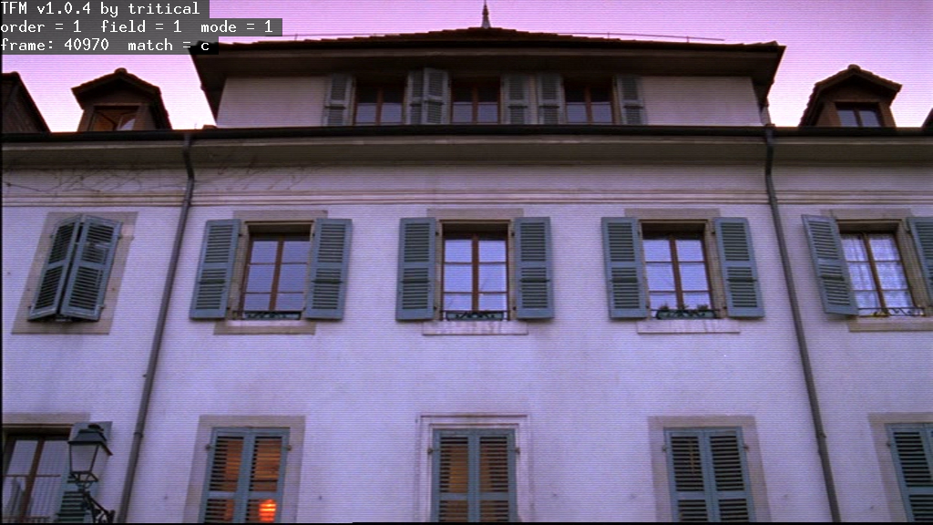

  8. Well, perhaps it'll be quicker to diagnose with screenshots...
    1303-1306
    Title fade, probably no processing required — right ?
    QTGMC(InputType=1) makes the combing effect more obvious.
    [Attachment 59372 - Click to enlarge]
    34057 & 78469
    Single combed frame at a scene threshold. Not sure what to do here.
    [Attachment 59373 - Click to enlarge]
    [Attachment 59374 - Click to enlarge]
    40965-40970
    Several combed frames at a scene fade-in. Same.
    [Attachment 59375 - Click to enlarge]

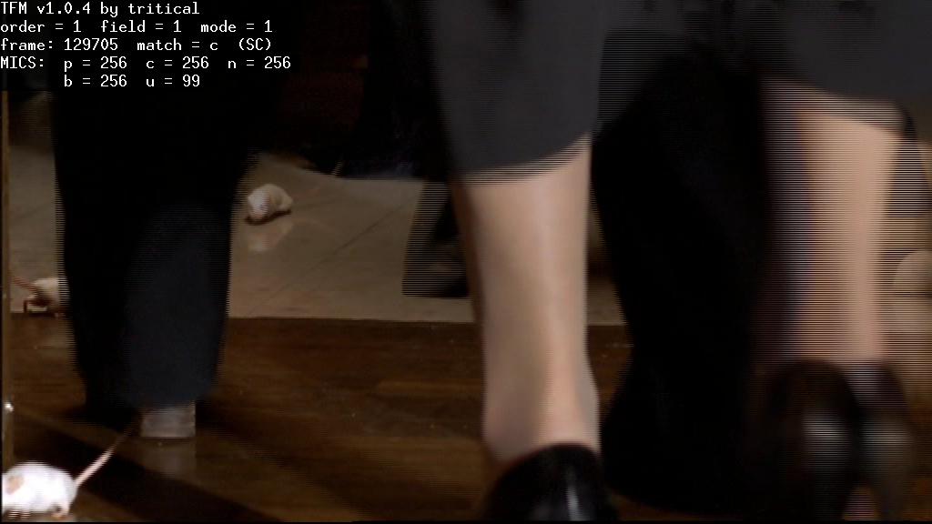

    129705-129781
    This is the most troublesome. It's a slowed down shot, about 4 seconds, with a lot of motion, I'm not sure if it's best to leave it interlaced (smoother motion), or do the field matching (to remove the combing, but with a jerky motion, while the first and last frames have an orphaned field if I understood this correctly so they can't be fixed this way), or attempt some kind of interpolation.
    [Attachment 59376 - Click to enlarge]

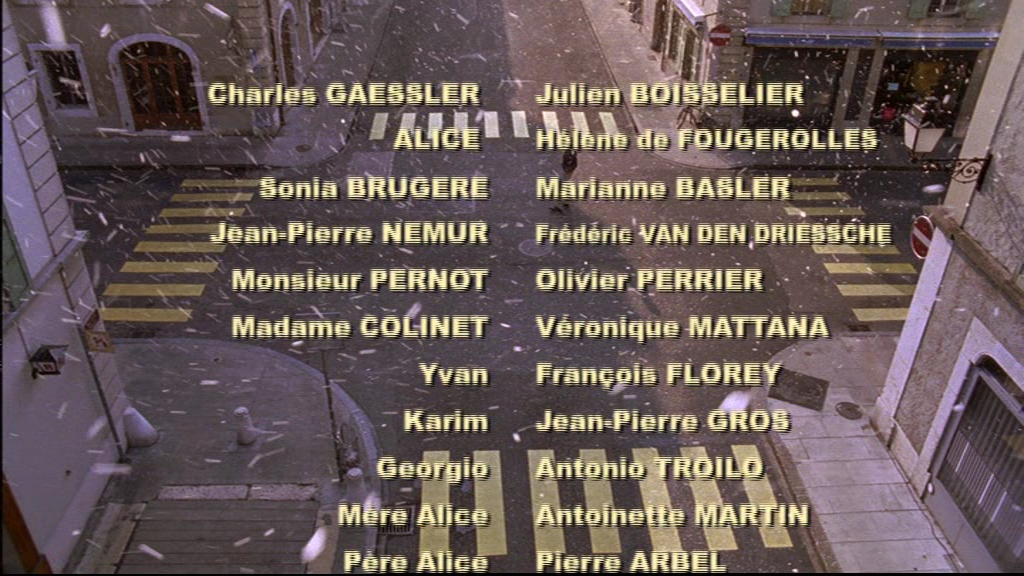

    139951-141719
    End credits, about 4 seconds over a moving picture, then over a frozen frame. Here TFM's deinterlacing works very well over the frozen frame, it's harder to say during the 4 seconds where there's still motion underneath as it's a wide shot with snow falling, so it's bound to be quite fuzzy anyway. If using TFM with default settings, then QTGMC(InputType=1) doesn't seem to do improve, in fact it seems to be treating snow flakes as noise. If using TFM with PP=0, then QTGMC(InputType=1) doesn't by itself remove the combing effect in the titles (probably because it does its processing frame by frame and not field by field in that mode). QTGMC(FPSDivisor=2) does remove the combing effect but it doesn't look good for the 4 seconds with picture motion, and likewise over the frozen frame it smoothes out the snow as if it were noise, whereas TFM's deinterlacer only processes the titles.
    [Attachment 59377 - Click to enlarge]
  9. Or not...
  10. Sorry, I didn't answer when I first saw post 7 because of all the samples and questions. But most of your ills will be taken care of with:
    Mpeg2Source("whatever.d2v")
    TFM(cthresh=11, clip2=nnedi3())
    vInverse() # blur away residual combing
    vInverse() occasionally mistakes thin horizontal lines as residual combing and blurs them too. You can reduce that problem with:
    # build a mask of areas where there are
    # alternating horizontal lines
    function CombMask(clip v, int "threshold")
        threshold = default(threshold, 5)
        Subtract(v, v.blur(0.0, 1.0).Sharpen(0.0, 0.6))
        GeneralConvolution(0, "
            0  8  8  8  0
           -0 -8 -8 -8 -0
            0  8  8  8  0
           -0 -8 -8 -8 -0
            0  8  8  8  0", chroma=false, alpha=false)
        mt_lut("x 125 - abs")
        mt_binarize(threshold)
        mt_inpand()
        mt_expand()
        mt_expand(chroma="-128")
    Mpeg2Source("VTS_01_1 0h27m15s.demuxed.d2v", CPU2="ooooxx", Info=3)
    Overlay(last, vInverse(), mask=CombMask(5).Blur(1.0)) # blur softens the edges of the mask

    That leaves just the issue with the scrolling credits. If you want to keep the full smoothness you'll have to encode at 50 fps. If you don't mind them being less smooth (but no less so than the usual 24p film to 25p video PAL speedup) you can use the sameTMF/vInverse code as the rest of the video.

    For those two combed frames at scene thresholds, since there's little motion, and since (in both instances) the luminosity is markedly different from the next frames anyway, remapping them to the next frame seems like the best option.
    RemapFrames(mappings="34057 34058")
    RemapFrames(mappings="78469 78470")
    For the 40965-70 interval, as it's a totally fixed shot, I tried the following : remapping each frame to 40971, then adding a similar fade-in over 5 frames. It's seamless and seems to look better than the TFM processing with or without vInverse.
    RemapFrames(mappings="[40965 40970] 40971")
    V = last
    V1 = V.Trim(0,40964)
    V2 = V.Trim(40965,0).FadeIn(5)
    V1 ++ V2
    But it increases the total frame count by 1 (“an additional color frame is added at the start/end, thus increasing the total frame count by one” from the dedicated page) so it's going to cause a slight desynchronization. Seems to work as intended with V2 = V.Trim(40966,0).

  13. Use FadeIn0() instead of FadeIn() to get rid of that extra frame. RemoverDirtMC(limit=10) will get rid of that spot.
