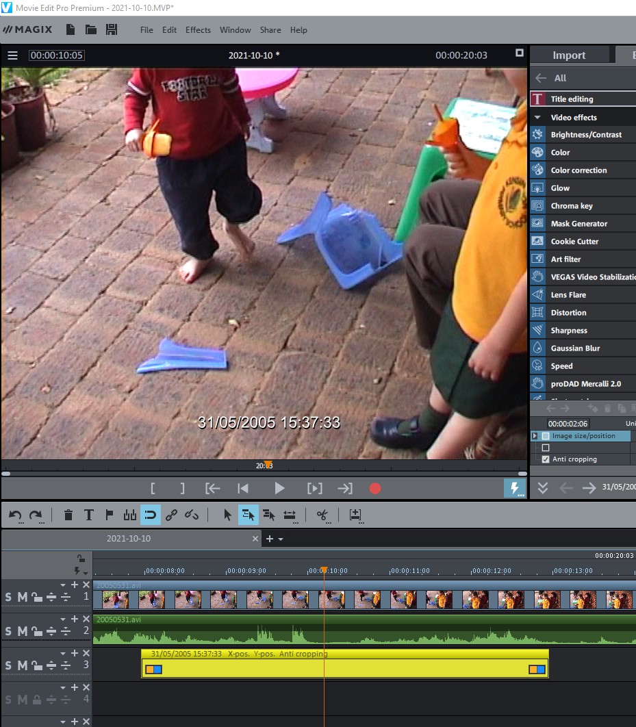

    Movie Edit Pro can create a title of the exact timecode for any point in a DV file:
    [Attachment 61212 - Click to enlarge]

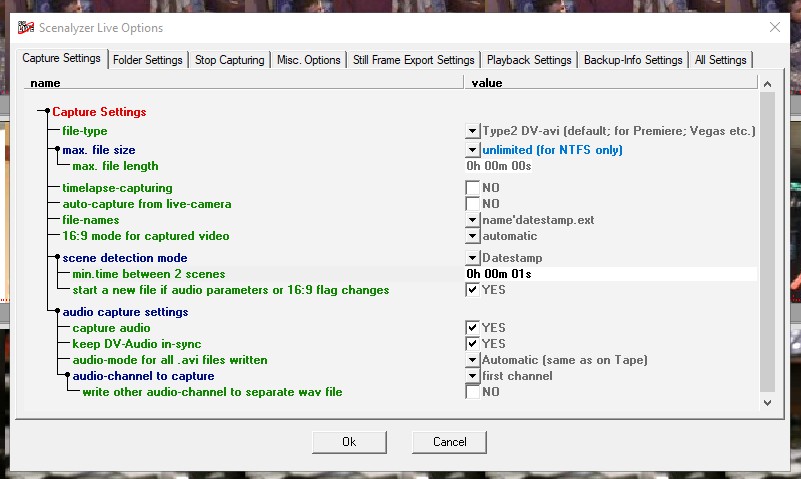

    Scenealyzer can be made to create the filename based on the exact time of the start of each clip:
    [Attachment 61213 - Click to enlarge]
    Set the Scene Detect to 1 second and each clip will be captured as a separate file, with the name of the file being the timestamp. That can then be used to create a title in your editor.

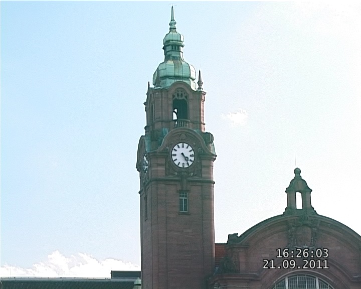

    For reference, since the original documentation of the DVAutoTimeStampEx plugin seems to be lost, here is what I could gather by looking at my old scripts.
    First, you need to set a path to the avi file in DV format to read the date codes from (obviously it should be the same avi just read by AviSynth without any trimming):
    "C:\DV Camcorder\MyCapture.avi"
    If you want to add the date code not to the entire video but only part of it you can use these two:
    firstframe=0
    lastframe=-1
    Sets the font to be used:
    font="lucida console"
    Effects to be used for rendering the font.
    g: Softens the font rendering
    b: Bold
    i: Italics
    f(frames, frames): Fade effect
    For example this fades the date code in and out for 25 frames and softens the font:
    effects="gf(25,25)"
    (There may be more effects than that but these were all the effects I could find in my old scripts.)
    size=22
    x=-64
    y=512
    Should be self-explanatory.
    Date format used for drawing the date onto the video:
    dateformat="{H:mm:ss}|{dd.MM.yyyy}"
    "|" breaks a line.
    For hours,
    H: 24 hour time format
    h: 12 hour time format
    For month,
    M: 9
    MM: 09
    MMM: Sep
    MMMM: September
    textcolor=$00FFFFFF
    halocolor=$00000000
    Text and halo color to use. The first two are the alpha level (00 = opaque), the last six are the actual color (FFFFFF = white).
    If you do not want the entire video to display a date, you can use these two to show a date for a given amount of frames (autolength) after a break in the time code (read: scene change) of "threshold" frames:
    threshold=10
    autolength=75
    For example, this code
    DVAutoTimeStampEx("MyCapture.avi", firstframe=0, lastframe=-1, font="lucida console", effects="g",
    \ size=22, x=-64, y=512, dateformat="{H:mm:ss}|{dd.MM.yyyy}", textcolor=$00FFFFFF, halocolor=$00000000)
    produces this output on PAL DV:
    [Attachment 61214 - Click to enlarge]
