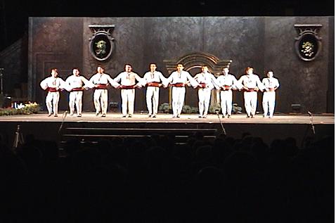

    Awesome link,DTS8888, I checked it out and noticed there is a AviSynth plugin for DVTimeStamp. So you can create a AviSynth video script for Virtual Dub that is a mirror image of your captured video, except it has a date stamp on it. You can use that as a reference, since you do not want the captured video to have the date stamp:
    With DVTimeStamp
    Without
    Of course, everyone knows how easy it is to whizz through Virtual Dub with the little slider.
