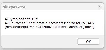

    I'm having the same issue. Here's my script (AVISynth+ 64bit):
    clip1=AVISource("H:\Videohelp\DMS\test trimmed.avi")
    clip2=AVISource("H:\Videohelp\DMS\iodata trimmed.avi")
    StackHorizontal(clip1.subtitle("Dazzle"), clip2.subtitle("GV-USB2"))
    Message:
    [Attachment 78277 - Click to enlarge]
    Both open OK in MPC (BE), both open OK in VDub2 64, and as far as I know, the LAGS installer does both 32 and 64.
    I'd be grateful for any ideas.
    In the meantime, I'll do the different source calls PDR referred-to.
    Thanks!

  5. Originally Posted by Alwyn View Post
    Message:
    Thanks!

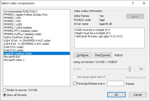

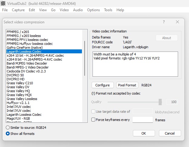

    Originally Posted by mammo1789
    Vdub2 comes with lagarith preinstalled as vdf file and sometimes conflicts with the lagarith codec trough install. Try in vdub 2 fastrecompress from lagarith to lagarith but select in compression the second one in the list lags try that file in avisynth with avisource it should work or if vdub 1 is oppening it and then from there fastrecompress ( not direct copy) because it is stuck in the vdub lags codec and nor avisynth nor any other editor is unable to open it but it should play in vlc
    This was it. I do have two LAGS in VDub's codec list. But I didn't create the AVI in the first place. It seems that @DMS, in the other topic, created the LAGS AVI with the VDub LAGS and not the real LAGS.
    Is there a way of removing the VDub2 LAGS?

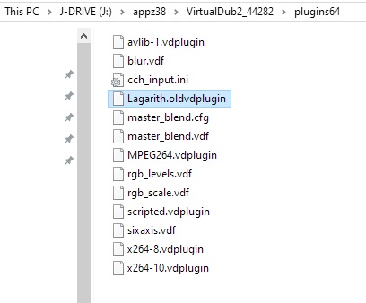

    Mar 2008
    Probably just remove the associated vdplugin files from the vdub2 plugin folders
    The file I created with the built in LAGS opened OK in avisource
    May 2005
    Australia-PAL Land
    Thanks Dave, did that, it's still there! Must be in the Registry somewhere...
    Mar 2008
    It works for me. Only the installed version is visible
    May 2005
    Australia-PAL Land
    Mine's still in the list but it fails on "Save Video..." because, I assume, I moved it out, so I can't use it.
    That will force me to use the proper, external one lower down. Bit of a nuisance for newbys though.
