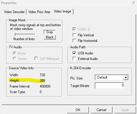

    I was more curious about the source video info, and if I am actually capturing at 720 x 576.
    Yes, definitely 720x576. With a bit of denoising it doesn't look criminally bad. It will be interesting to see the improvement with a better VCR.
    A couple of ways to check: open the file in Mediainfo (View>Tree); it will tell you the frame size. Beware though that because AVIs don't have aspect ratio data stored in them, the Display Aspect Ratio will probably be incorrect. In your case, the display aspect ratio should be 4:3. MediaInfo reports it as 5:4 (it just divides the width by the height). If you open your file in VDub, File>File information will give you the frame size as well.
    I think your capture is PSF (somebody can explain that better than me) and it all looks good from the Mediainfo report: standard colour space, 4:2:2, frame rate for PAL and normal file size for LAGs.
    Thanks Alwyn, much appreciate the reply. I’m keeping an eye out for a better vcr, my one is a basic Toshiba, so can’t expect much. I’m glad the capture is correct, and I’m curious about PSF now! I have also ordered a I-O Data GV-USB2 which seems more popular than the poor old Dazzle!

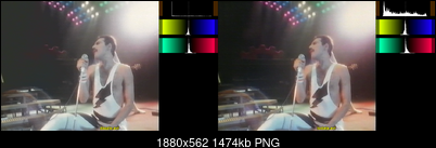

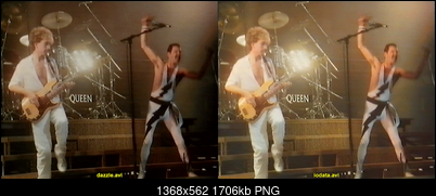

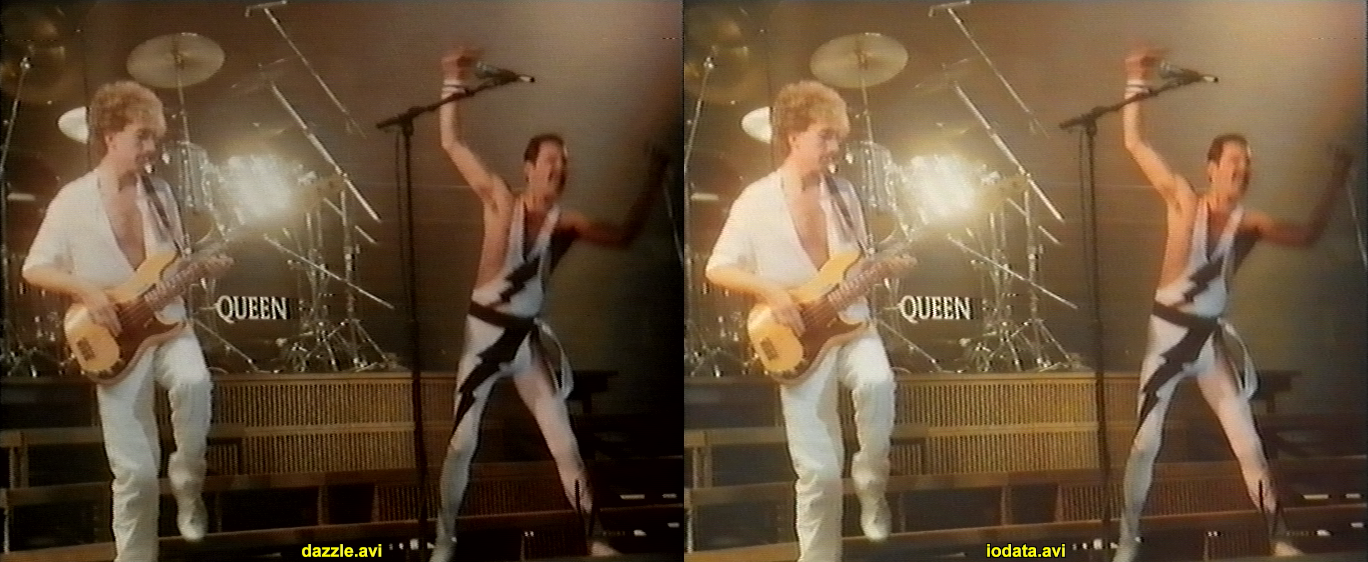

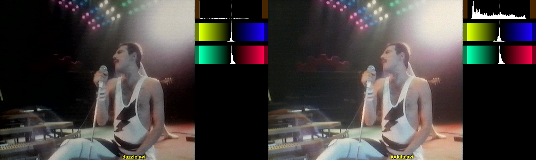

    Thanks for the feedback, i now have the I-O Data and i have captured the same video again for comparison.

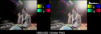

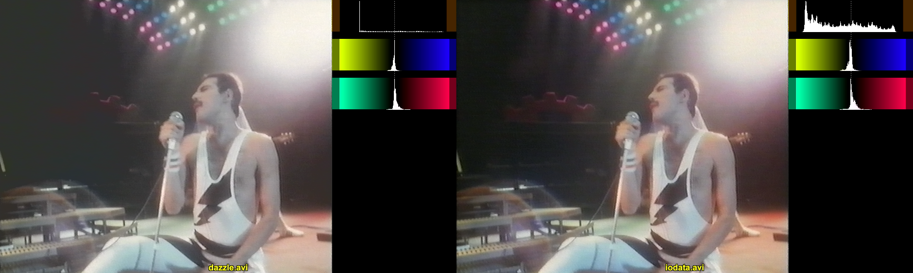

  30. Captures & Restoration lollo's Avatar
    Jul 2018
    Italy
    The dazzle capture suffers of crushed blacks, and its histogram is less convincing:
    Even trying to equalize the brigthness with a basic tweak(bright=40) command in AviSynth you cannot bring back what is lost in the dark areas:
    However, the overall quality of the Dazzle is not that bad compared to the IOData:
    with image slider: https://imgsli.com/MjU0Mzgx
    If you adjust its procamp and capture with the proper levels you'll improve a lot and make the two captures very similar for this test-bench.
