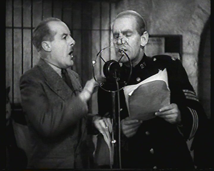

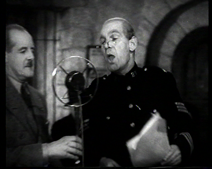

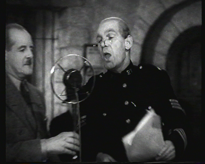

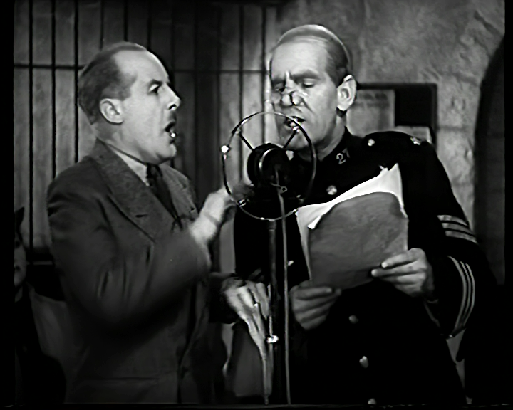

    No. It's overdenoised and oversharpened. s-mp calls it "fake" because it looks unnatural . "fake" might be a slightly confusing term in this context
    Amount of denoising is "subjective" and people prefer varying degrees - but it's indisputable that there is texture and detail loss, oversharpening with halos in that Neat Video version.
    Here are some apng's . They should animate in most browsers (if they don't click on them and open in new window). I'll also include them in a zip. The "original" levels have been adjusted similar to Truthler's version, so it's easier to compare
    Look at the stone textures in the background. There is a patch of smoothness blurred away above guy's head. Stones have details and textures around that patch and in different frames, but there is an area of ''blur" It looks very unnatural.
    [Attachment 60858 - Click to enlarge]
    Look at the loss of detail on the jacket - whereas before you can make out fabric textures, they are blurred and smeared away by those Neat Video settings. Even if you look at the Neat version alone, parts of the jacket have fabric textures, parts are blurred away - again it looks unnatural
    [Attachment 60859 - Click to enlarge]
    This happens when the temporal settings are too high. It happens with other denoisers with too strong settings as well, not just Neat Video

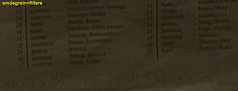

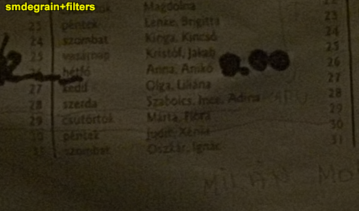

    Neat video even could give back the invisible, unreadable text of the noisy calendar video. Incredible, but the text of the calendar literally resurrected...
    There is no other denoiser on the market which can do that!
    Yes, it does a good job in terms of text/writing clarity - but free open source workflow with denoisers can get similar results on the calendar.
    I demonstrated a starting point with smdegrain in the earlier post. If you sharpen that, you get similar results to the Neat Video results posted. (e.g. add nonlinusm(str=0.6, rad=5) ) .
    Sharpening is not really the same thing "denoising" . But you can include other filters too with open source workflow too - in fact I suggested it earlier.
    The problem is the Neat Video settings you used, sharpens/enhances the noise too much and that obscures some of the typed text - so the results are not as clear
    Here are some cropped apngs. Same deal with animating, try clicking or open in new window if they don't animate, or check the zip below. The text is less clear Neat Video version. There are blurred artifacts over some, oversharpened noise artifacts around others that obscures the legibility. The handwriting is less clear too for the Neat Video version. e.g. 31 is "Farkas" on the 1st one . Or 23 "Brigitta" in the 2nd one . Check the full frame versions in the zip. This is the same 466 frame from before. Truthler's is ~453, because of his framedrops. The sharpened errors and noise around text in Neat Video reduce the text legibility
    [Attachment 60860 - Click to enlarge]
    [Attachment 60861 - Click to enlarge]
    As mentioned earlier, if you pre stabilized, apply smdegrain, sharpen, the end result in terms of typed and written text legibility is BETTER than what you used in Neat Video.
    But now we're talking about other steps, part of a full workflow, not just "denoising". Apples and oranges.
    You could improve Neat Video results too... by using it with other filters and programs.
    And you can improve all of them farther by adjusting contrast using curves in a limited range to enhance text / handwriting (you could do that for neat video too)
    Neat video is a very good denoiser and useful tool, but you can often get similar results with other free tools (albeit slower, and more difficult to use). And there are many scenarios and noise types where Neat Video just cannot compete as a denoiser, or you need or use other tools and techniques to make it more useful . I can post some examples if you want, I already mentioned a few

    The text in your example of calendar video is less clear, and a noise level is higher around it... So just you proved that you werre unable to reproduce the quality of my denoise. Why can't you admit, that free tools can not do good job?
    No. Your sample required squinting and guessing at what many of the letters might be. The smdegrain had almost none of that. I could actually read it.

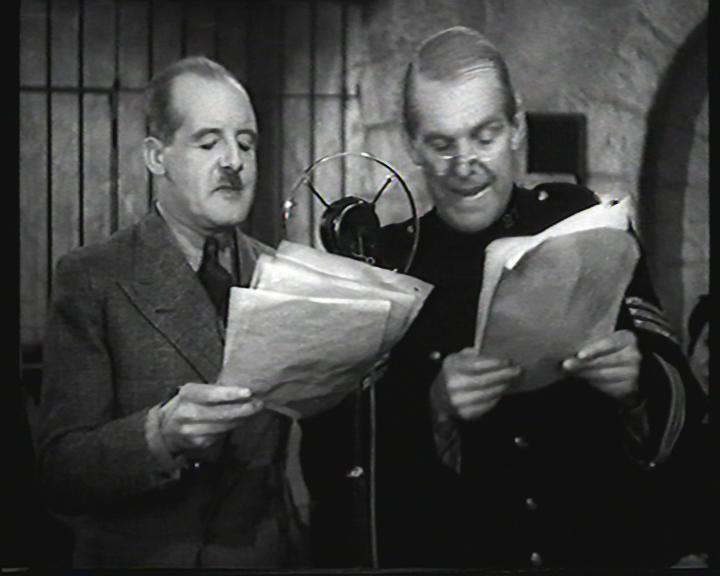

    Why do you call rapidly changing paterns on the wall as "deatail"? Real detail don1t change rapidly. So it is not detail but noise. Neat video restored the original look of the stone coverage of the wall precisely, the original video you can not see that clearly.
    Sample_3.avi is still overdenoised. It's basically the same, but the levels are more like original than Sample_2 but details are still blurred away - fabric, wall etc..
    Not all wall textures are not rapidly changing like "noise". For example, the outline edge of the brick to the man's right is blurred away - that's a real detail that has been destroyed. That brick edge is present and visible in multiple contiguous frames - it's a real detail. Also why is there some detail to the left and right of the blurry patch , even in the Neat Video version ? If that was "noise" should that not all be blurred away too ? The uneven quality of the denoising is unnerving and unnatural. There is a halo of bluriness surrounding the man's head as the head moves. This is because inaccurate and too strong temporal settings. Neat Video confuses the motion of the man's head , so there is a patch of blurriness above the head. It does not segment areas accurately enough (BTW - this is one of the tasks "AI" can be trained for - object segmentation)
    The jacket textures are still blurred away. These are real details that are present across several contiguous frames. Not all of it is "noise". It's the same phenomenon - the details around motion areas (arm moving, head moving in the other shot) are blurred away too excessively, because too strong temporal denosing settings.
    [Attachment 60873 - Click to enlarge]
    [Attachment 60874 - Click to enlarge]
    [Attachment 60875 - Click to enlarge]
    [Attachment 60876 - Click to enlarge]
    When you combine overdenoisng with oversharpening, you get that "water painting" look. Lines are thicker and coarser. BTW - QTGMC has that look too, because it denoises and oversharpens too much by default too. It's not a good look
    I'll give you another hint as to how to improve all denoising, not just Neat Video - decimate the duplicates before denoising (this is 25p content with duplicates to make up 50p) . Duplicates interfere with motion compensation and denosing quality. Also denosing 2x the number of frames will be slower. It's a win-win
    It's obvious that free tools did a better job in this case (more difficult to use, slower, multiple steps, but still better). The proof is posted above.
    You said the goal was text and handwriting clarity. The open source version is more clear and legible in this case for both. You can't even read some text in the Neat Video version which is legible in the free tools version - there are many noise and sharpening artifacts obscuring the text for the Neat Video version. The Neat Video handwriting is more faint, less clear as well.
    If you said the primary goal was denoising, not text/handwriting clarity, the settings and filters could be adjusted to reach that goal too
    You could improve the neat video version by using those other techniques and filters too - stabilizing too, increasing local contrast selectively, and not sharpening as much using that algorithm (the sharpening artifacts obscure parts of the text, it's counterproductive for "legibility") .
