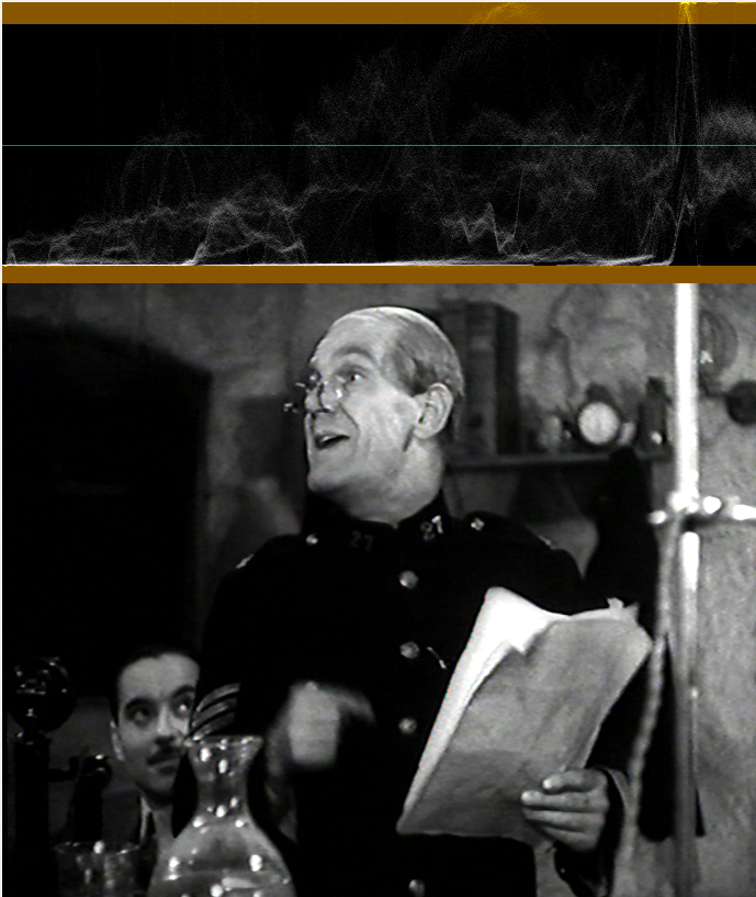

    In your video sample.avi you have clipped (clamped, crushed) blacks at Y=16 and some clipped whites at Y=255.
    [Attachment 58538 - Click to enlarge]
  12. So you have to do a clipping analysis before doing a full capture, and adjust so end capture is 16-235.
    What is the easiest way to view clipping in a GUI?
  13. Originally Posted by agisthos View Post
    Yes, a levels analysis is highly recommended.
    For example, load this script in AvsPmod
    AVISource("Sample.avi")
    turnright().histogram("classic").turnleft()
    Edit:
    I don't know what proc amp adjustments your capture infrastructure supports. The discussion here might be helpful:
    https://forum.videohelp.com/threads/401349-GV-USB2-Capture-Stick-What-s-In-It#post2615895
    Or if you can't adjust the proc amp for capturing you may try as postprocessing filter something like
    Levels(0,1.25,255,0,235,coring=false)

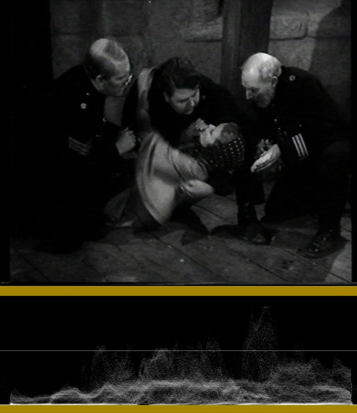

  19. The black level is way off (the brightest whites are blown out a bit too):
    [Attachment 58749 - Click to enlarge]

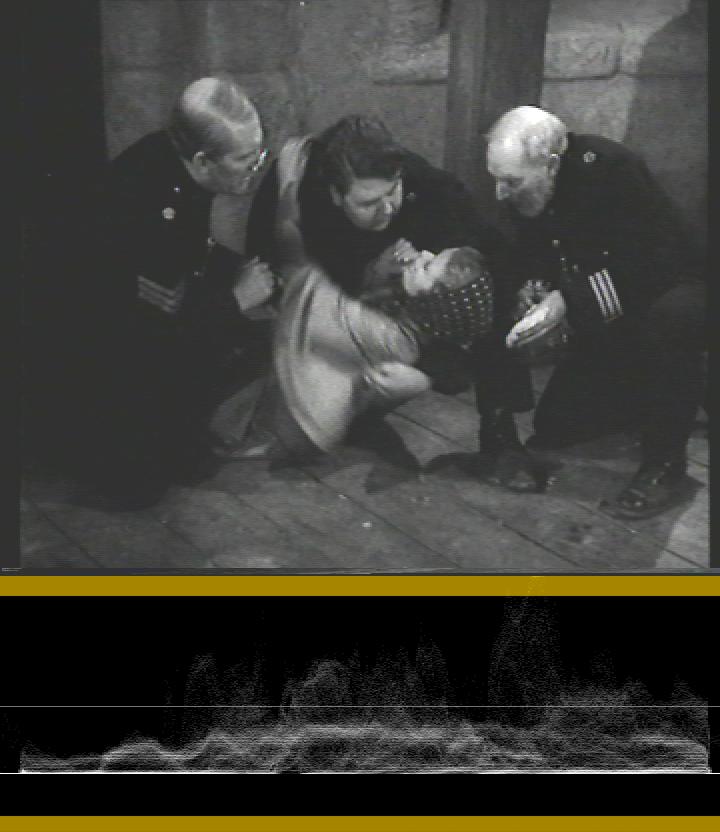

    If you pull it down to full black it gets too dark (ColorYUV(off_y=-42)):
    [Attachment 58750 - Click to enlarge]

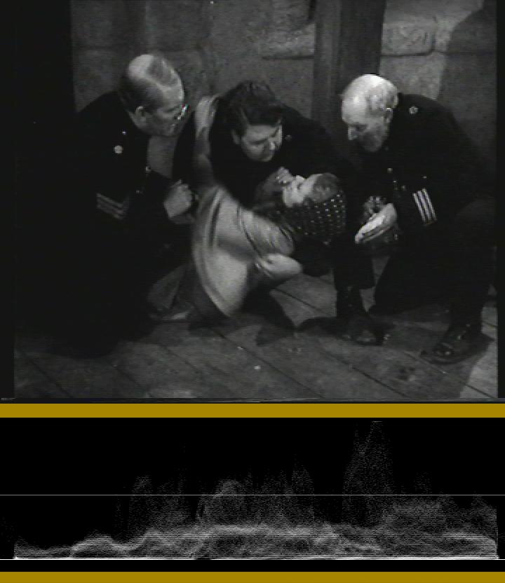

    The original film probably had darker shades that were lost in the telecine. So you might use a compromise setting (ColorYUV(off_y=-25)):
    [Attachment 58751 - Click to enlarge]
    Pick whatever compromise setting you think looks best.
