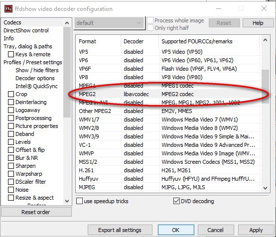

    I've looked at the MPEG 2 error message again, and I'm correct, you only need to install and enable the FFDShow MPEG 2 decoder and you will then not receive that message, and the Preview window will appear. Here's the setting you need in FFDFShow (this is the 32bit version):
    [Attachment 60209 - Click to enlarge]

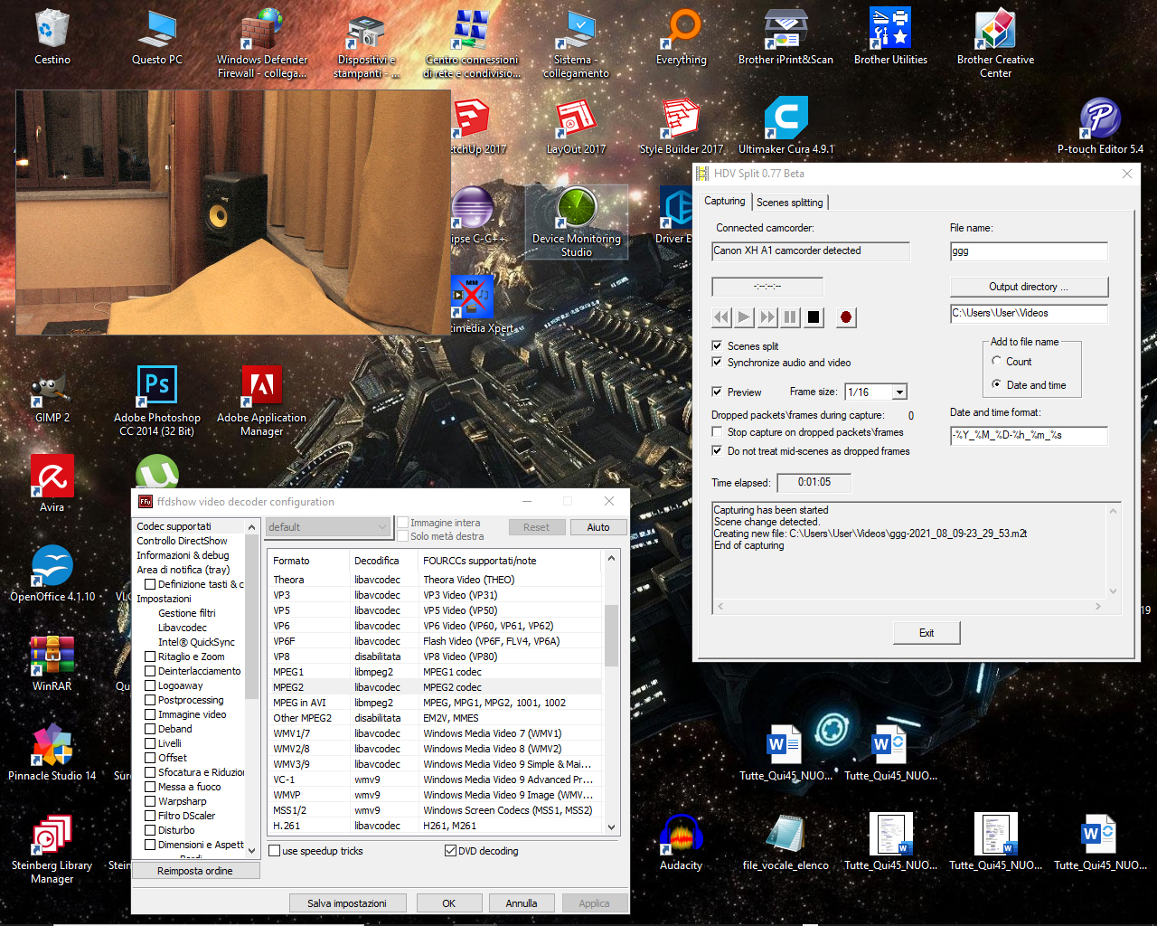

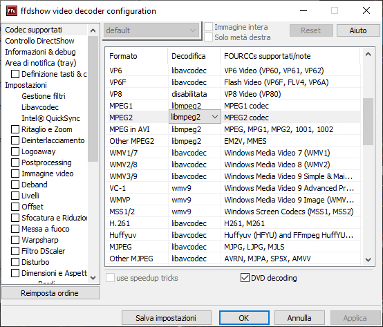

    Alwyn. I've taken a shot of my FFDShow configuration.
    very probably the problem raises for the fact that I've the 64 bit installed but...
    Why should it create problems? I copied the whole FFDShow directory from c:\Program Files to c:\Program Files (x86).
    FFDShow is just a storage for codecs, why it shouldn't work if HDVSplit searches a codec in a directory?
    Anyway, tomorrow I will try to clear and remove the directory I copied and then install the 32 bit version of FFDShow.
    [Attachment 60216 - Click to enlarge]

    yes, as I stated, it was my suspect too, and I copied the whole directory, with all the files in the c:\Program Files (x86) dir.
    If FFDSHow is just a repository of codec files, why it should not work?
    maybe that the codecs files I got (and copied) are all 64 bit versions? it does not make sense, but tomorrow morning I will install the 32 bit version of FFDShow and we'll see what happens. All in all it costs zero.

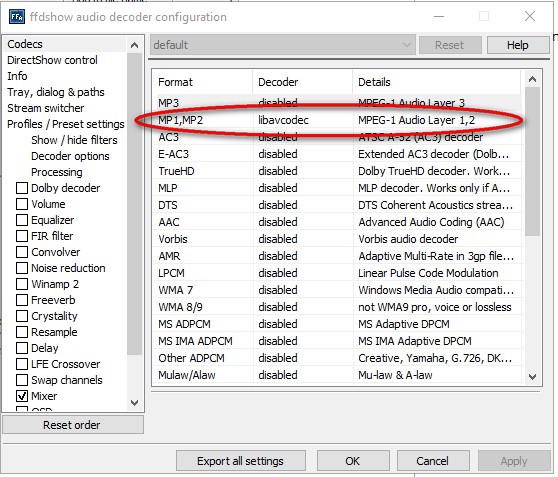

    I've done some more in-depth investigating and come up with the following:
    - You don't need the Preview function (and therefore FFDShow) to transfer video with HDVSplit. You can simply use the screen or viewfinder on the camera to locate your position on the tape.
    - FFDShow 32-bit is required. On the Videohelp download page, it is the version without the "64 bit" in the name. I do have FFDShow 64 bit installed as well with no conflicts, but the 64 bit version will not enable Preview.
    - To enable the HDVSplit video Preview function, set the FFDSHow video decoder to MPEG 2 as per this:
    [Attachment 60226 - Click to enlarge]
    - To clear the audio error message, set the FFDSHow audio decoder to MP1, 2 as per this:
    [Attachment 60227 - Click to enlarge]

    the problem was the 64 bit version.
    I already had FFDShow and the MPEG2 was already correctly configured and active.
    I installed the 32 bit version half a hour ago and HDVSplit started to work sending the videolive to monitor.
    It's really strange. FFDShow, in this particular case, works as a repository of codecs. I copied its directory into the Programs (X86) directory, the same directory that contains all the 32bit software, but it didn't work until I installed the proper 32bit version.
    all in all I didn't expect that the codecs too where released in 32 or 64 bit versions.
    In any case it does work right now, without any error.
    [Attachment 60255 - Click to enlarge]
