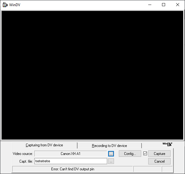

    Thank you Skiller.
    Tried WinDV few seconds ago. It does not work, unfortunately
    [Attachment 60175 - Click to enlarge]

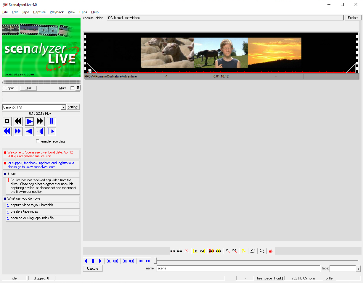

  5. Scenalyzer does not work too.
    It seems that there is no connection between the camera and the PC but VLC is able to show the video live (without to record any file) and Pinnacle saves the imported video but does not show the video live from the camera.
    This is Scenalyzer:
    [Attachment 60177 - Click to enlarge]

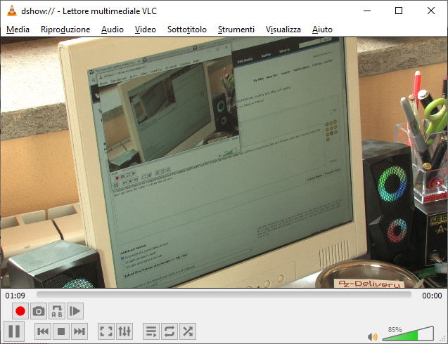

    and this is VLC, this screenshot was taken one second ago, from this page and the VLC windows opened on it.
    The video il live, it is only delayed of about a second or so, and VLC does not save the file
    [Attachment 60176 - Click to enlarge]

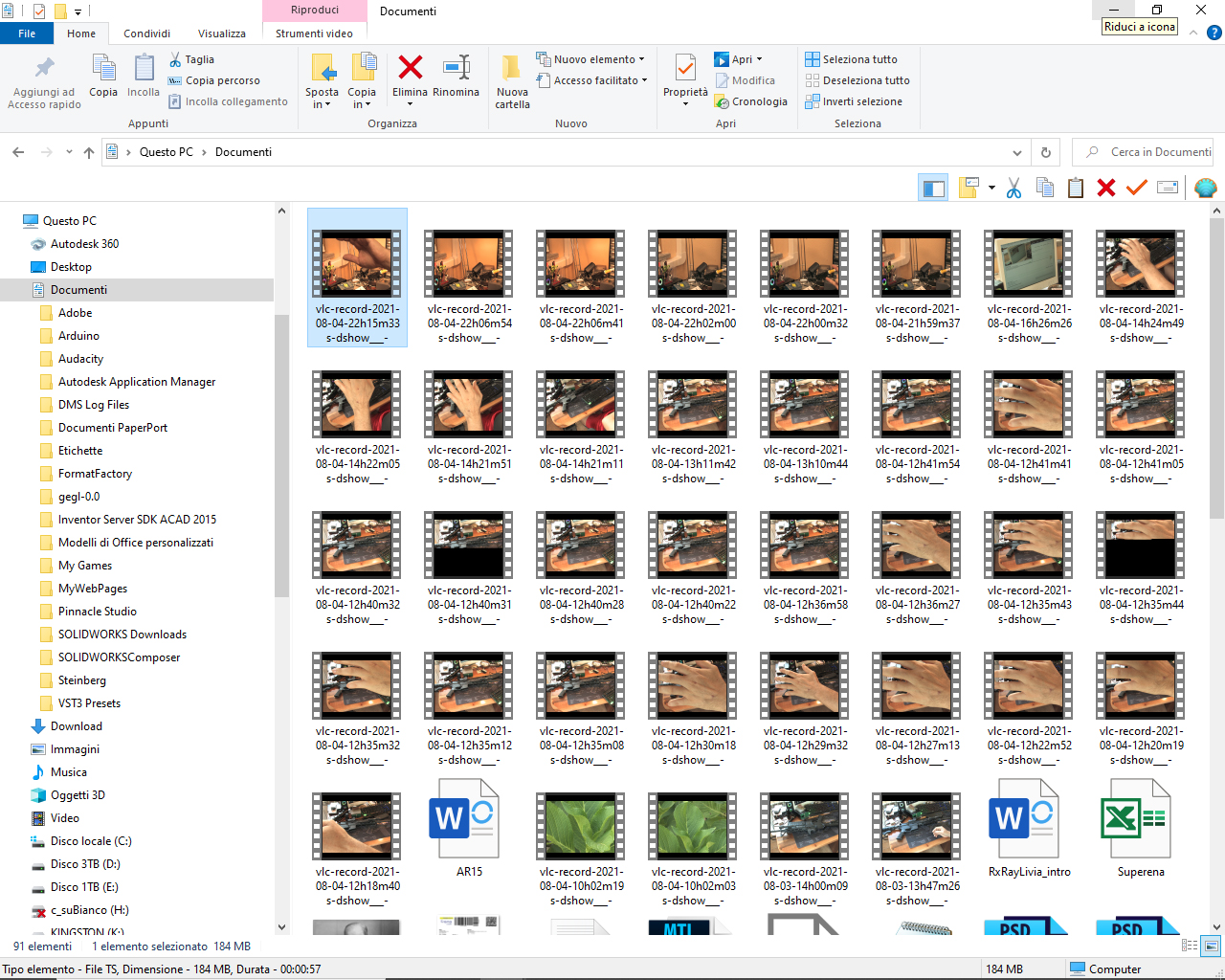

    FOUND!
    I was trying since yesterday to find a single video created by VLC, I was looking in the VIDEO and PICTURES directory.
    Of course I've chosen "advance controls" since yesterday, it was always active.
    I kept pressing the REC button since yesterday like a crazy during all my tries.
    ...But now I found on that page that VLC saves videos in the DOCUMENTS directory!
    So... since yesterday I recorded almost 40 videos all in the documents directory!
    unfortunately there are still 2 problems: my camera automatically turns off after two minutes or so, if it is not switched in REC (recording on the MiniDV tape) and the videos are still compressed in MPEG2, while I was looking to save them in AVI or any other flat, uncompressed, high quality format.
    [Attachment 60179 - Click to enlarge]

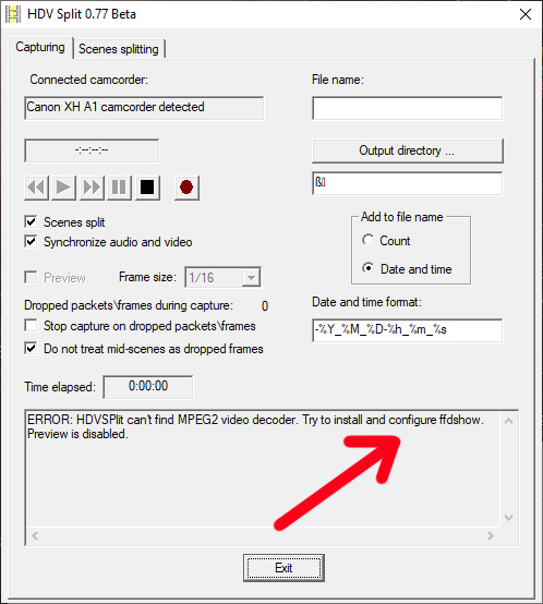

    I used that guide yesterday, suggested by its creator. it returns an error, looking for a MPEG decoder.

    Concerning HDVSplit it does not work in my computer, it asks for a MPEG2 decoder, suggesting to install FDDSHOW, but I've already installed and kept running it.

    Concerning FFDSHOW and HVDslipt, I'm not kidding and no telling lies.
    And consider that I already had FFDSHOW installed. I runned it before to run HVDSplit, and I tried more than once.
    I tried a minute ago too.
    There is no possibility to download (and monitor anything with HVDSplit in my computer.
    Look:
    [Attachment 60183 - Click to enlarge]

    Fair enough. But like I said Mpeg2 decoder is disabled in Ffdshow. Enable it and try again.
