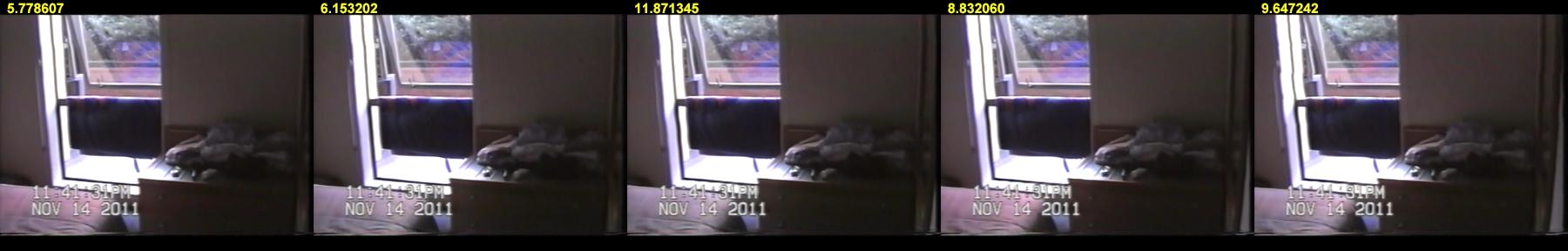

    There's a semi-automated ways to approach it: First make five clips where each clip has an interpolated frame added at a different position. Then manually go through the videos and use ReplaceFramesSimple() to select the correct clip for each segment. For short videos that's not too much work. But if there's hundreds of pattern changes over a two hour movie it's quite tedious. I've done something like this a few times myself.
    http://avisynth.nl/index.php/RemapFrames
    A possible way to fully automate it would be to look for frames where the difference between successive frames is significantly larger than the difference of the frames around it. Ie, a bigger motion will usually result in a bigger luma difference. Here are five consecutive frames with the YDifferenceFromPrevious is printed on each frame (from a video with this exact problem):
    [Attachment 59812 - Click to enlarge]
    The middle frame has a larger motion than the other four. And it's YDifferenceFromPrevious is correspondingly higher: 11.9 vs. an average of 7.6 for other four. So a motion interpolated frame would be inserted there. I have a vague notion of how to do this within the constructs of AviSynth but have never worked out all the details. And it probably won't be perfect.
