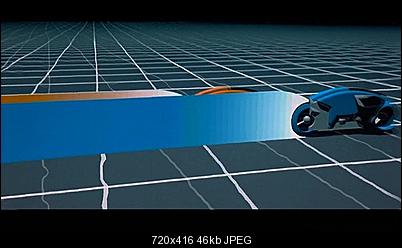

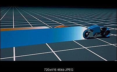

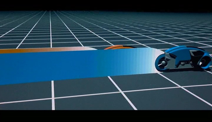

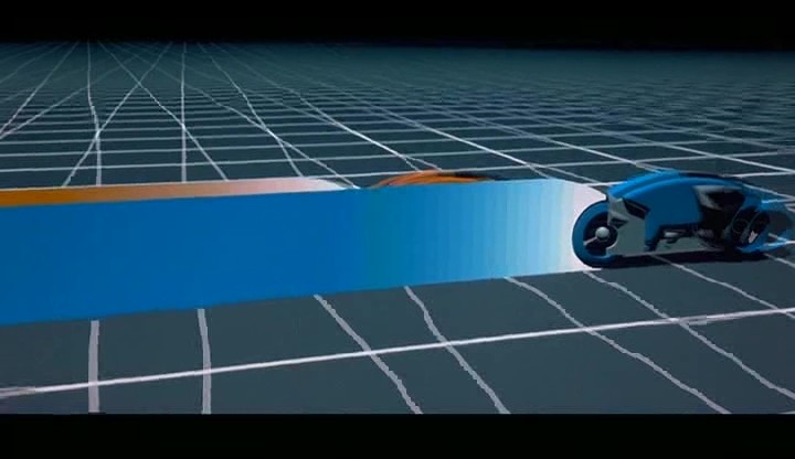

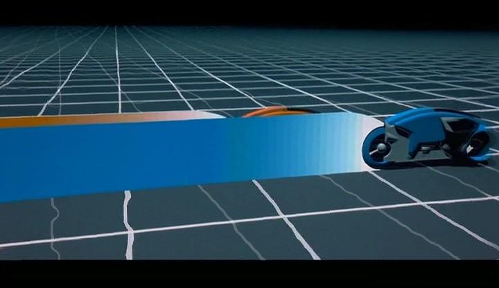

  20. Another example where neither works very well:
    Two consecutive frames from the original Tron:
    The intermediate frame from doubling the frame rate with MvTools:
    The intermediate frame from doubleing the frame rate with SVPFlow:
