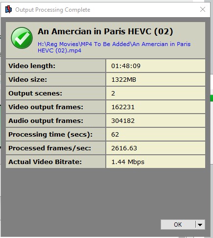

    Fair enough, we've both made our points. One last question:
    In my Videoredo flow, only the edited GOPs are re-rendered. The rest of the file is smart-copied/rendered ("Fast frame copy" in Videoredo parlance).
    In your lossless>MP4 flow, the whole file is re-rendered; "but only one of them (the last one) is lossy, so you will only incur one more generation of loss, which is the next best thing to no loss."
    It seems to me that the edited parts of my video will be the same as yours ie fully re-rendered, but the rest of mine will not be re-rendered (ie no loss) whereas yours will be (coming from lossless).
    From a video quality point of view, is your lossless flow better and if so why?
    Details of a VideoRedo "Save As" after I chopped out 60 seconds in the middle of the file:
    [Attachment 59244 - Click to enlarge]
  20. Member Cornucopia's Avatar
    That's a good point. If that were the only determiner of loss, I would say your method was preferable.
    However, it can also depend on how the loss is generated, which can affect the quality of the loss. Is VideoRedo saving in-place or is it saving-as an external (exported) file? Is it doing a full decode+encode, or is it just transcoding and modifying quantization coefficients & motion vectors while leaving the frame(s) in the compressed domain? Is it recalculating the compression using floating point, or is it taking shortcuts for speed using integer math? (This last one is similar to the quality difference seen between optimized encodings using e.g. x264 software vs. that done by hardware accelleration, e.g. nvenc).
    In those aspects, my suggestion would be considered a safe bet while yours might be a wild card, pending extensive experimentation & analysis.
    I will certainly concede that your suggestion takes somewhat less time than my suggestion does.
