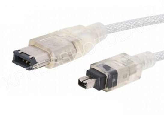

    The cable I'm using is https://www.amazon.co.uk/gp/product/B07JDVG3D1/ref=ppx_yo_dt_b_asin_title_o06_s01?ie=UTF8&psc=1 which I think should do the job? My FireWire card has 6 and 9 pin connectors on it. I'm using the 6 pin connection at the moment. Would using the 9 pin make any difference?

    4 pin to 6 pin is the correct cable and port.

    The first iteration of firewire (400), which is the one you want to use, only supports 2 kinds of cables: 4pin mini and 6pin full. The difference is that 6pin supports supplying power, 4 doesn't. But you shouldn't try to supply power to a cam anyway, just use its existing power supply. 4pin <-> 4pin, 4pin <-> 6pin, 6pin <-> 4pin, 6pin <-> 6pin are all OK.
    If you have something that is 9pin (firewire800?), almost certainly NOT gonna work.
