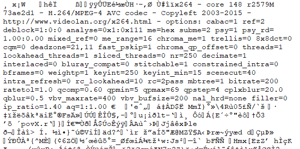

Working out the kinks, so looking at everything for a clue on what is wrong, and this seems very odd after i merge, on a windows box using copy /b.
At each merge point in the merged file, i have all of this header info, and it would seem that it would be on header block, and the rest all media data to play the file, so is the following normal, or is my merge messed up (i am a coder, but have no clue on media file workings, never really played in the area):
[Attachment 58825 - Click to enlarge]
this is at every point the next file comes in.
I thought i was close to the bottom of the hill on this project, but guess not LOL.

"Copy /B" is a quick and VERY dirty way of merging, which I've warned against for years, due to the very real possibility of encountering issues such as you are now seeing. You've probably just lucked out until now.
The problem with copy/b is that it retains all the interim headers and timings, which wouldn't exist if it was properly merged (it would/should only have the main header and have new consecutive timings). This can confuse players/editors.
I suggest you use a different method, perhaps Avidemux or some other gop-level, non-re-encoding editor, or perhaps an ffmpeg merge (concat) script.
Scott -
Normal ? Yes. The /b treats each file as binary so grabs all the bytes whether they can be used or not.
What is more critical is if the player ignores the header and just treats the data after that as part of the original.
But AFAIK it will process that data as if it was prepared in accordance with the original header. So merging files from different encoding parameters is not going to work.
Or to put all that in another way, if there is visual and/or audio disturbance at the point where you appreciate the merge has taken place a merge is not an appropriate tool and a re-encode is more appropriate. -
