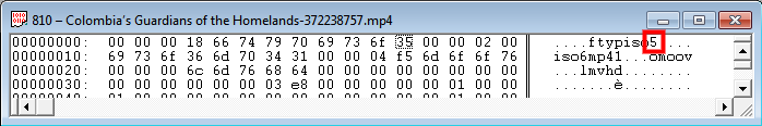

  1. I've been wanting to learn a little about mp4 file structure for a while. This seemed like a good excuse to start. I wrote a program to walk through the MP4 header chunks, find the stsd chunk, display the Profile@Level, and clear the constraints flags.
    I've seen one MOV file that had a different size stsd chunk. All the MP4 files and all the other MOV files had the same size chunk (unless they weren't AVC). I've seen a few where the two "profile-level-id" flags differ from each other. And some where the constraint byte has different bits set. I'm not sure if it's appropriate to clear the entire contraint byte or just the 0x08 bit. If you want to try the program out I'll upload a copy for you guys to test. It does an in-place change (and hence is very fast) so be sure to back up your video before proceeding.

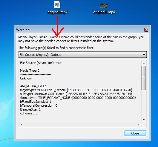

  10. Ok, your software (for my Windows 7 netbook) to play the video on the media player works perfectly. However, the video (downloaded with Tubedigger) must first be run through the Tubedigger convert tool, mp4 to mp4, (or this also works):
    ffmpeg -i original.mp4 -c copy original1.mp4
    I am a little confused about answering y/n on the second question. I tried it both ways (yes and no) and both played in the media player.
    The strange thing, whether you answer yes or no to the second question, the command output is exactly the same. See below:

  12. Why does the Tubedigger downloaded file need to be remuxed? Does it play as-is in a media player on the PC? Is it really an MP4 file (what does MediaInfo say about it)?
    I mentioned this in above post 5:
    The 720p version of the video that I got from Tubedigger (probably the same as the video from youtube-dl)
    won't play with Media Player Classic [Home Cinema]1.6.3.5818 (2320902). The video will play with VLC. If I run the video through this ffmpeg:
    ffmpeg -i video.mp4 -c copy video1.mp4
    or use the Tubedigger convert tool,
    then the video will play with Media Player Classic.

    Also, the original video from Tubedigger appears on the netbook desktop as a file, not a video, but after going through ffmpeg (or Tubedigger convert tool) then it appears as a video thumbnail. (see below screenshot).

    Looking at the chunk structure:
    downloaded:
    ftyp offset==0000 size=0018
    moov offset==0018 size=04f5
        mvhd offset==0020 size=006c
        trak offset==008c size=0208
            tkhd offset==0094 size=005c
            edts offset==00f0 size=0024

    The major difference is the mdat chunk (all the audio and video data) appears as many small segments in the download file, one single segment after remuxing with ffmpeg. I don't know if this is related to the dash segmentation or just the way the original file was produced.
    And what you can't see here is the ftyp subtype of the former is "iso5" and the latter "isom". I tried changing the 5 to an m -- the video still played in all the players I tried. It's right at the beginning of the file:
    [Attachment 51161 - Click to enlarge]
    Could you try changing that and see if it makes any difference with the set-top box? You may still have to change the Constraint byte with my program. If that works I can modify my program to change it along with the constraint bit.
    Could you try changing that and see if it makes any difference ...
    Changing that byte resulted in SMPlayer (version that I mentioned previously) having a 3-5 second delay before starting playback, to not being able to play the file at all.
