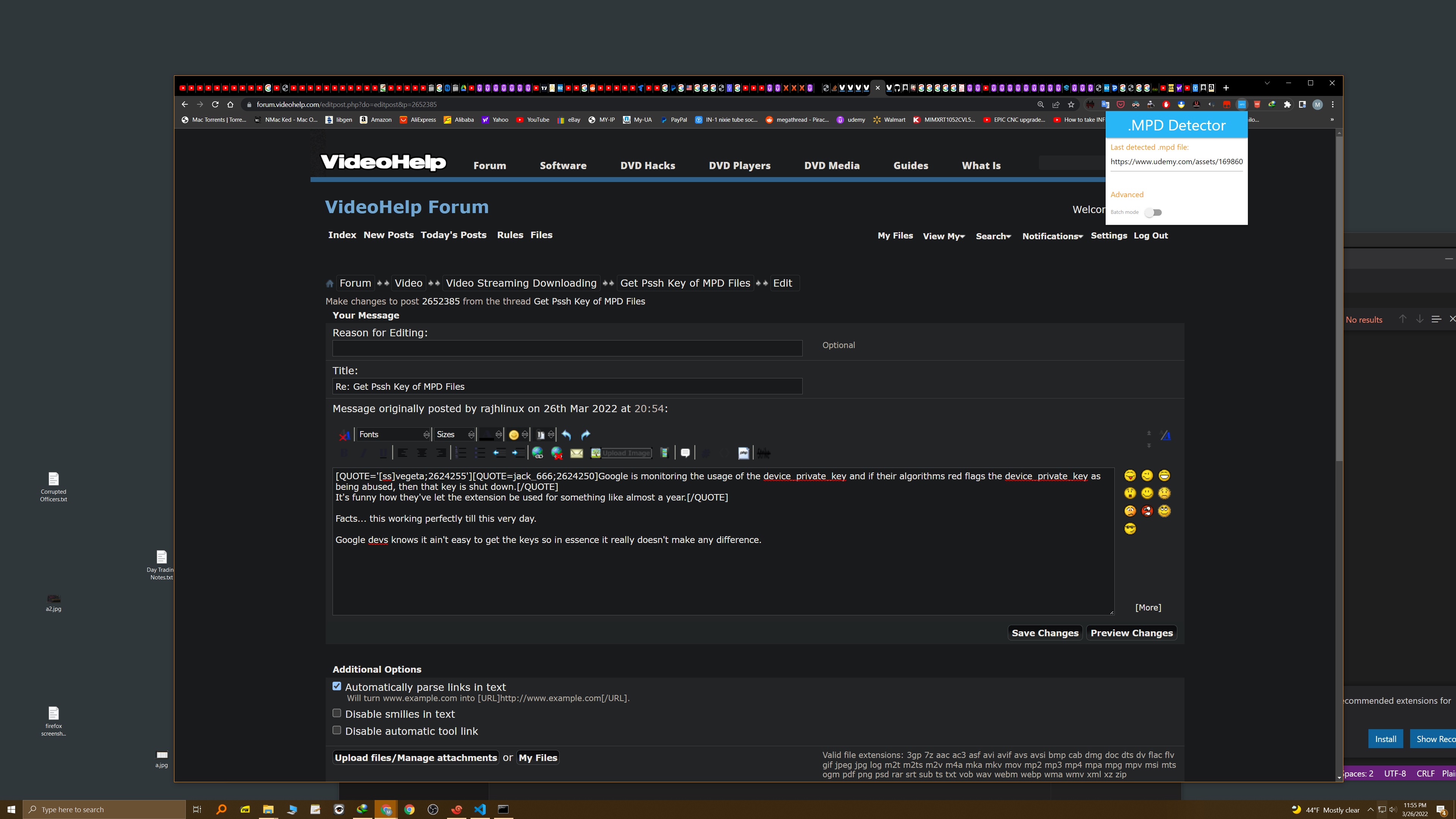

	Well said, he pretty much gave the full answer. I have read somewhere on this forum that an "android OS" for the PC can be used as a CDM and get the keys using frida-server tool... I will explore this if it is true and make a post about. Not sure if widevine CDM can be run on such custom "android OS"...
	Facts... ".mpd detector" is also still working perfectly till this very day.
 Google devs knows it ain't easy to get the keys so in essence it really doesn't make any difference.
 [Attachment 64023 - Click to enlarge]
