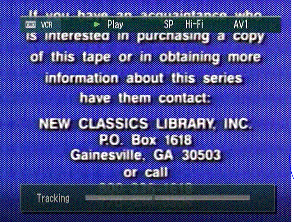

Please have a look at the attached video & let me know, what type of filter is reqd to smooth it out.
[Attachment 58400 - Click to enlarge]
Per me it is not standard interlace , what type of noise is this in the video?

What source did you capture, what device(s) did you use, what software did the capture?
Good grief man, throw us a bone -
10xDVDRip | AVI/XviD, ~800 kb/s | 720x576 ( Robert Prechter – Elliott Wave International Educational DVD Series )
[Attachment 58402 - Click to enlarge]
These were originally AVI, not sure how they were converted from VHS though.
i converted them to MP4 ( lossless ) using this command : ffmpeg -i 01.avi -c:v libx264 -c:a aac -vf scale=720:576 01.mp4 -
OK. This is your source, that's all you have. Do you not the tapes to recapture?
Can you post a clip that has a bit of live action, something to give some context -
That's not what you uploaded. Upload a part of the video you're starting with, with no reencoding. You can use Video -> Direct Stream Copy in VirtualDub(2). Mark-in and Mark-out on keyframes. Save.

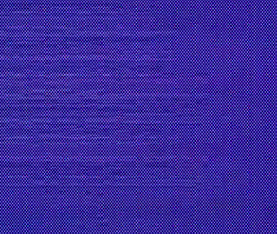

Thx for the tip, found this thread on the topic: https://forum.videohelp.com/threads/398728-Avisynth-herringbone-removal
Here's an example using defreq. Only about half the noise is removed. You might be able to remove a little more with some tuning and a few more defreq() calls.
Another example with resizing and blurring:Code:LWLibavVideoSource("Video.mp4", cache=false, prefer_hw=2) Crop(2,2,-0,-0) ConvertToYV12() defreq(fx=35.4, fy=27.8, dx=2.0, dy=2.5, sharp=0, info=false, show=0) defreq(fx=35.4, fy=-27.6, dx=2.0, dy=2.5, sharp=0, info=false, show=0)
Some decimation (to remove duplicate frames) and temporal noise reduction would help too.Code:LWLibavVideoSource("Video.mp4", cache=false, prefer_hw=2) ConvertToYV24() PointResize(365, 214).Crop(1,0,-0,-0) Blur(1.0).Sharpen(0.7) ConvertToYV12() nnedi3_rpow2(4, cshift="Spline36Resize", fwidth=960, fheight=720) CAS(0.6) -
Hi Jagabo,
Thank you for the code snippet above.
This is what I finally adopted:
LoadPlugin("C:\Program Files (x86)\AviSynth 2.5\plugins\LSMASHSource.dll")
loadPlugin("C:\Program Files (x86)\AviSynth 2.5\plugins\defreq.dll")
source = LWLibavVideoSource("C:\Downloads\10_DVD_Set\DVD3.m p4")
even=separatefields(source).selecteven()
odd=separatefields(source).selectodd()
outputeven = defreq(even,fx=35.4, fy=27.8, dx=2.0, dy=2.5, sharp=0, info=false, show=0)
outputodd = defreq(odd,fx=35.4, fy=27.8, dx=2.0, dy=2.5, sharp=0, info=false, show=0)
interleave(outputeven,outputodd)
output = weave()
return output
