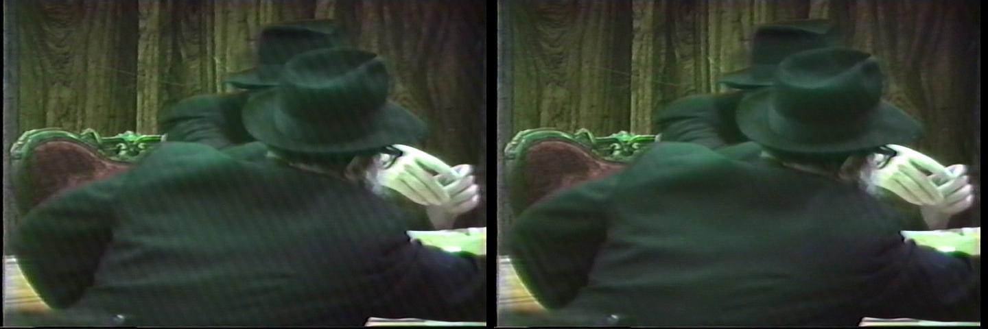

  2. DeFreq() can be good at removing noise like that. I'm not very good with it but here's an example:
    LWLibavVideoSource("herringbone-sample.avi")
    AssumeTFF()
    ConvertToYV12(interlaced=true)
    SeparateFields()
    #Defreq(info=true) # enable this to get numbers for the next line
    Defreq(fx=9.7,fy=-10.0, sharp=71.9)
    Weave()
    QTGMC()
    Original on the left, defreq on the right (QTGMC for both):
    [Attachment 54815 - Click to enlarge]
    Unfortunately it didn't work as well on other frames. I don't know how to fix that.

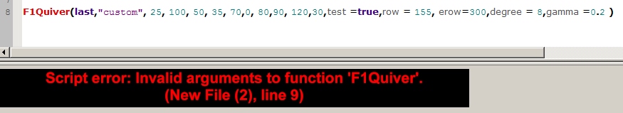

  8. F1quiver is good at removing hbones:
    F1Quiver(last,"custom", 25, 100, 50, 35, 70,0, 80,90, 120,30,test =true,row = 155, erow=300,degree = 8,gamma =0.2 )
    I don't know what's wrong.
Name:	2020-09-09 13_45_06-_ New File (2) - AvsPmod.jpg

    For anyone trying this, this line is for the older version (listed here as 2.5.8 avisynth version) of f1quiver, the newer(current) one has different parameters.
