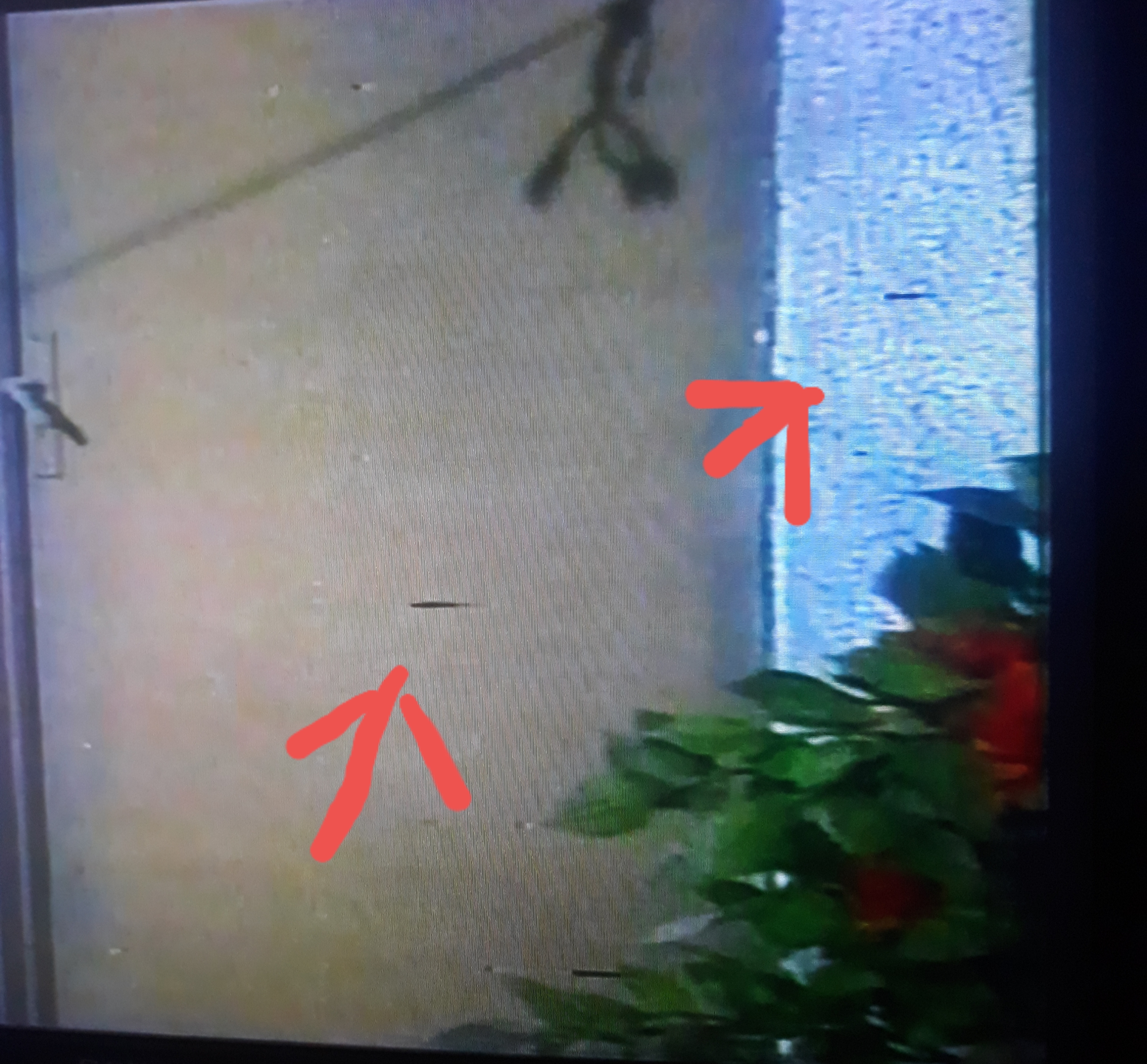

    [Attachment 58326 - Click to enlarge]
    In the case of these risks that appear throughout the video. Give to remove them? Is there a code to take?
  5. Originally Posted by kelvin View Post
    How do I use this code in the episodes I have here? I'm a newbie.
    I see you started a new thread about this. I replied there. https://forum.videohelp.com/threads/401428-script-error-Help#post2616342
    You can probably just blur them away. Need a video sample...

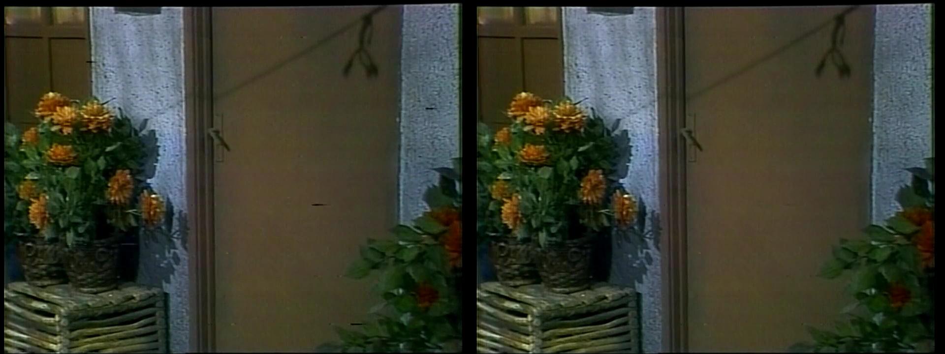

  7. At first I though you meant all those very thin vertical and horizontal lines in the sample image. But I see now those are a result of your camera photographing the screen. I think what you really mean the comets? Those two short black streaks in the image. You can get rid of most of those with RemoveDirt():
    LWLibavVideoSource("1978x29a.mkv")
    RemoveDirtMC(limit=10)
    I think this is the same frame as your image (before filtering on the left, after on the right):
    [Attachment 58335 - Click to enlarge]
    Using a higher limit will remove more of them (but possibly mess up other things occasionally), a lower limit will remove less.

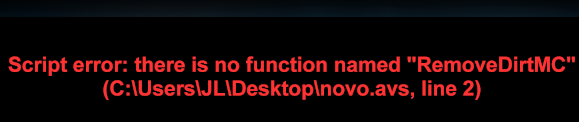

    Yes.The comets.
    [Attachment 58336 - Click to enlarge]
    error

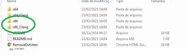

    I downloaded RemoveDirt-0.9.3
    [Attachment 58337 - Click to enlarge]
    which one should I use and where to put it ?
  9. RemoveDirtMC is a third party filter. You will need to download it and install any other third party filters it requires (that you don't already have). There are several variations around. The one I used comes from this thread:
    https://forum.videohelp.com/threads/382527-Need-help-setting-up-avisynth-pls!#post2477423
    Near the end of the big script there you'll see RemoveDirt() and RemoveDirtMC(). You can copy/paste from there into your script. I see they use RemoveGrain, fft3dfilter, and mvtools...

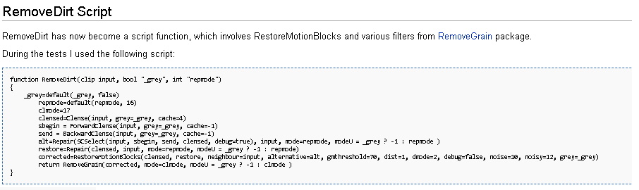

  14. Kélvin
    Apr 2021
    Brazil
    [Attachment 58424 - Click to enlarge]
    function RemoveDirt(clip input, bool "_grey", int "repmode")
    _grey=default(_grey, false)
    repmode=default(repmode, 16)
    clmode=17
    clensed=Clense(input, grey=_grey, cache=4)
    sbegin = ForwardClense(input, grey=_grey, cache=-1)
    send = BackwardClense(input, grey=_grey, cache=-1)
    alt=Repair(SCSelect(input, sbegin, send, clensed, debug=true), input, mode=repmode, modeU = _grey ? -1 : repmode )
    restore=Repair(clensed, input, mode=repmode, modeU = _grey ? -1 : repmode)
    corrected=RestoreMotionBlocks(clensed, restore, neighbour=input, alternative=alt, gmthreshold=70, dist=1, dmode=2, debug=false, noise=10, noisy=12, grey=_grey)
    return RemoveGrain(corrected, mode=clmode, modeU = _grey ? -1 : clmode )
    If I'm going to use the demovedirt, is that the scrit I use?
    Where do I put the source filter?
    For example if it were "Teste.mkv"
    #would that be correct?
    LWLibavVideoSource("teste.mkv")
    clmode=17
  15. Using something like:
    function Myfunction(clip c...)
        filters...
    creates a function called MyFunction. The function isn't used in your script unless you explicitly call it. I like to import stuff and create functions at the start of my script, then follow with the actual script commands I want to use:
    function MyFunction(clip c...)
        filters...
    LWLibavVideoSource("input.mkv")
    MyFunction(...)
    Note that your function definition is missing the final close curly brace, }.
    # create a function called RemoverDirt
        clmode=17
    # open your source and apply RemoveDirt:
    RemoveDirt()
    Note that when you fail to name a stream explicitly AviSynth assume the name "last" so the script:
    RemoveDirt()
    is equivalent to:
    last = LWLibavVideoSource("teste.mkv") # create a video stream from test2.mkv, explicitly name it last
    last = RemoveDirt(last) # apply RemoveDirt to last, creating a new filtered stream called again called last

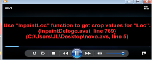

    LWLibavVideoSource("teste2.mkv")
    InpaintDelogo( mask="c:\test\mymask.bmp",
    \ Automask=0, aMix=0, Loc="100,100,-100,-100",
    \ Mode="Inpaint",
    \ Analyze=1, FrB=0, FrW=0, FrS=0)
    InpaintDelogo ()
    I made this script but it is not working.
    [Attachment 58428 - Click to enlarge]
  17. I'm not familiar with InpaintDelogo() but does c:\test\mymask.bmp exist? And the Loc="100,100,-100,-100" probably isn't right as that has something to do with the location of the logo.

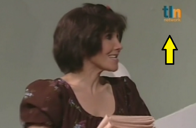

  18. Kélvin
    Apr 2021
    Brazil
    Do you have a script to remove the logo?
    [Attachment 58448 - Click to enlarge]

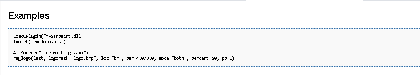

  19. I have AvsInpaint:
    http://avisynth.nl/index.php/AvsInpaint
    which can be simple to use:
    #  Fill a rectangular box with a specified color.
    function BoxFill(clip v, int x, int y, int w, int h, int color)
       BlankClip(v, color=color)
       Crop(0, 0, w, h)
       Overlay(v, last, x, y)
    ImageSource("logo.png", start=0, end=23, fps=23.976)
    Crop(0,0,-1,-1) # need even frame dimensions
    ConvertToYV12() # and YV12
    #mask = ImageSource("mask.bmp", start=0, end=23, fps=23.976).ConvertToYV12(matrix="pc.601")
    mask = Overlay(mt_binarize(130),mt_binarize(100).Invert(), mode="add").mt_expand().mt_expand().mt_expand().mt_expand().mt_expand().mt_expand().GreyScale()
    mask = mask.BoxFill(0,0, 500, mask.height, $000000)
    mask = mask.BoxFill(500, 80, mask.width-500, mask.height-80, $000000)
    mask = mask.ColorYUV(cont_y=50)
    InpaintLogo(mask=mask, radius=5.0)
    The code is complicated by the fact that I built a mask based on the logo in the image. You could just import an image to use as a mask (as in the commented out (mask = ImageSource...) line.
