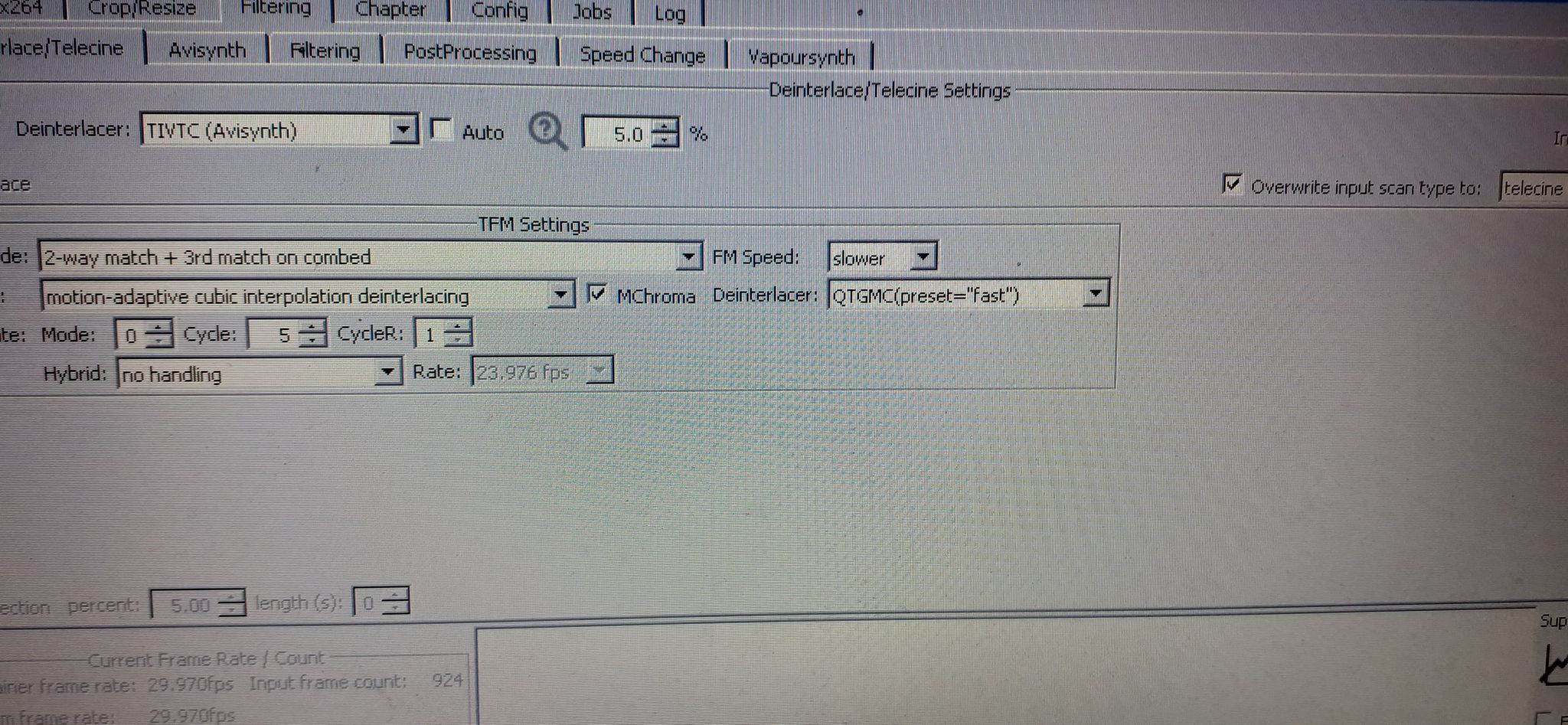

Something i do wrong , the motion is not smooth , is 23.976 constant but time is 25 s , original video is 31s.
[Attachment 57888 - Click to enlarge] -
Strange assuming the source is a DVD.
You could bob it for example with QTGMC and look at the bobbed content and decide whether it's telecined or may be some mixed content,...
