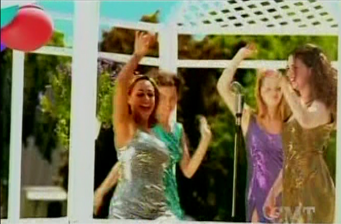

    I'm wondering if there's a way to remove the horizontal lines in a video like this

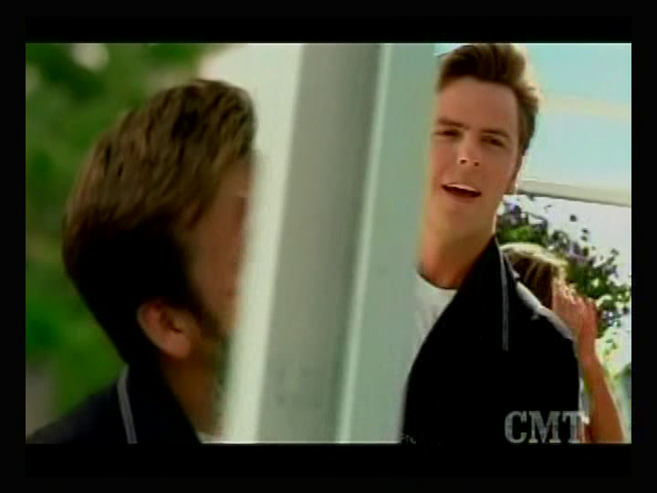

    what horizontal lines? played with vlc.
    [Attachment 56999 - Click to enlarge]
  9. Originally Posted by aedipuss View Post
    VLC is deinterlacing on the fly. And the playback is still full of blending artifacts and jerky motion.

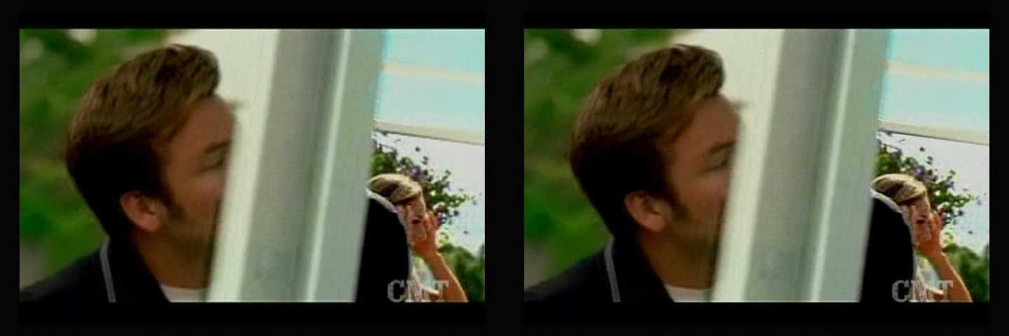

    You are wrong. Good deinterlacing algorithms use both fields in areas where there is no motion -- so you get a full 480 lines of resolution (filters like Yadif and QTGMC do this). In areas of motion they vary depending on the algorithms used. It can be anywhere from 240 to 480. Or at least, the 240 lines can be more smoothly interpolated, better approximating the missing field. Compare Bob() on the left to nnedi3(field=-2) on the right:
    [Attachment 57001 - Click to enlarge]
    Be sure to view the image full size. Note the near horizontal bar near the right edge of the frame. nnedi3 delivers a more realistic estimation of the missing field -- the bar is smooth rather than aliased.

    part of the problem is that it was badly cropped/resized with black bars. the actual video is only like 660x430.
    but yes interlaced vid is 2 half sized fields shown every other line.
    [Attachment 57006 - Click to enlarge]
