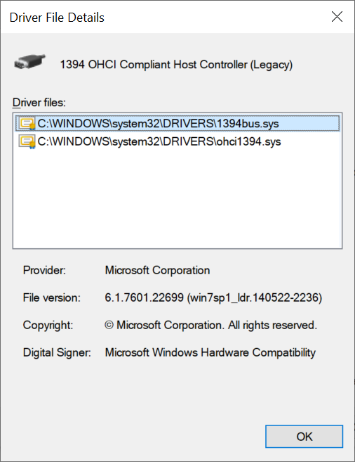

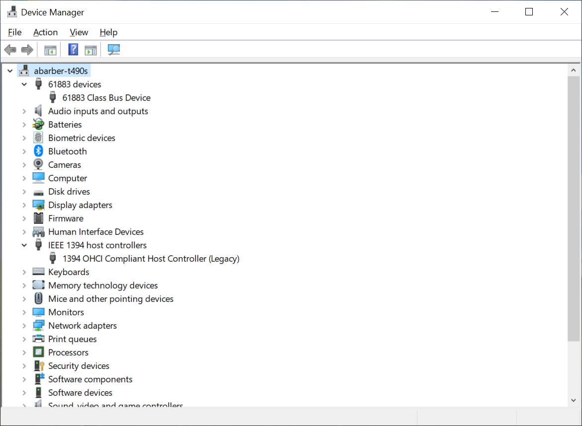

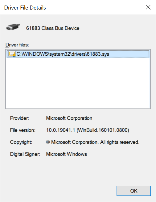

    All of my adapters, cables, and ports seem to work, as both "1394 OHCI Compliant Host Controller (Legacy)" (adapter/cable chain) and "61883 Class Bus Device" (D-VHS player) appear in Device Manager; I'm just having trouble getting Windows/HDVSplit to recognize the D-VHS player as an AV/C or imaging device. However, I did see this post on the AVS Forum that claims a bad cable will cause the device to appear as "61883" and not "AV/C." Is this true?
Name:	Device Manager.png

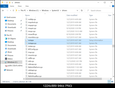

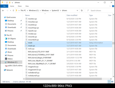

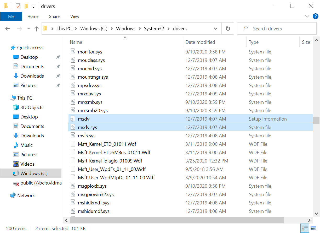

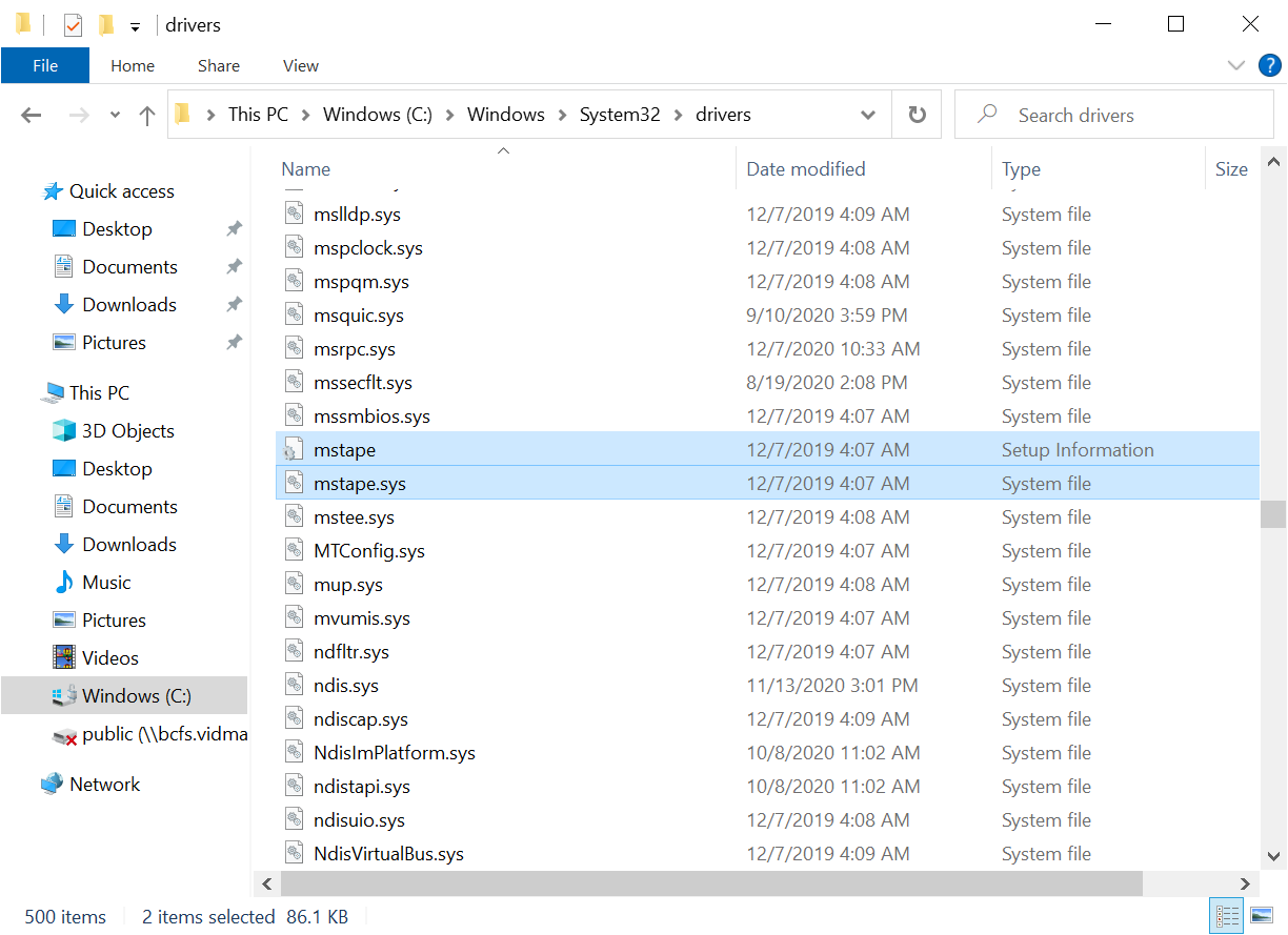

    I've also made sure that the "msdv" and "mstape" drivers are in C:\Windows\System32\drivers.

    You are doing it all wrong my friend and that is because you are ignoring a simple fact that D-VHS is neither DV nor HDV not even D1 standard, It's MPEG-2 SD or full HD 1920x1080. I wish I could have saved you all this headache.
    I don't know about MAC but in Windows the only OS I could make to work with D-VHS is Win 7. Oh and you cannot transfer pre-recorded D-VHS tapes due to digital copy protection and you cannot capture analog tapes with Macrovision, only home recorded tapes.
    CapDVHS is the software for transferring videos, VLC works as well.
