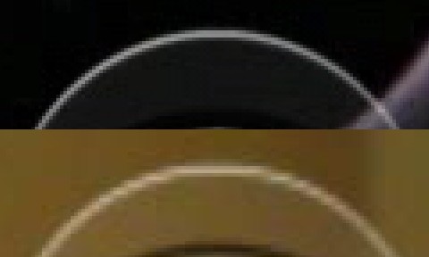

    Visually. Compare the ematic cap on the left to the HDMI cap on the right:
    [Attachment 56909 - Click to enlarge]
    If you zoom in on the images it's very obvious the HDMI cap is missing every other scan line (4x point enlargement):
    [Attachment 56910 - Click to enlarge]
    You can see it all all sharp near-horizontal edges. Apply the Deinterlace filter (bob, keep top or bottom) and you'll see exactly the same thing. And this type of deinterlacing leads to jerky playback as it leaves you with a a duplicate frame every 5 frames. It's very easy to see in panning shots.

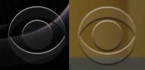

    What was your precise method to get snapshots and enlarging to post the CBS logo? I know VLC takes snapshots, but absolute clarity is a must here, and different methods yield different results. For example, when you are playing the video, do you pause it, and then take the
    the snapshot, or do you take the snapshot as the video is playing?
  22. I opened the videos in VirtualDub2, copied the desired frame to the Clipboard buffer (Video -> Copy Source Frame To Clipboard), then pasted that as a new image in an image editor (a very old copy of PhotoImpact). But you could do it in an AviSynth script too:
    v1 = LWLibavVideoSource("Ematic1080.mts")
    v2 = LWLibavVideoSource("HDMIcapture1080.avi").ConvertToYV12()
    v1 = v1.Crop(1596,896, 140, 140) # just the logo
    v2 = v2.Crop(1596,896, 140, 140) # just the logo
    StackHorizontal(v1, v2)
    # PointResize(width*4, height*4) # enable this line if you want a 4x enlargement
