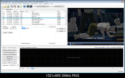

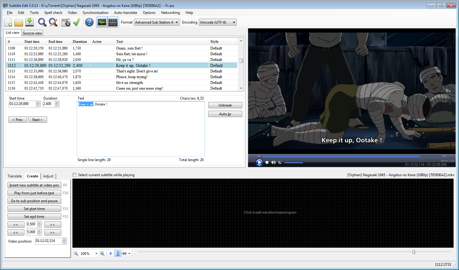

    (Right now I'm translating a scene of a movie called Nagasaki 1945 – Angelus no Kane, where a character who was badly burned following the nuclear blast is urged by the young doctor — whose ensuing books the movie is based on — to crawl from his bed to a stretcher, so that he can be transported to the basement, as a huge storm is hitting the upper floors, since it's too painful if someone helps him... to put things in perspective.)
Name:	Nagasaki 1945 -- 01h12m29s.png
