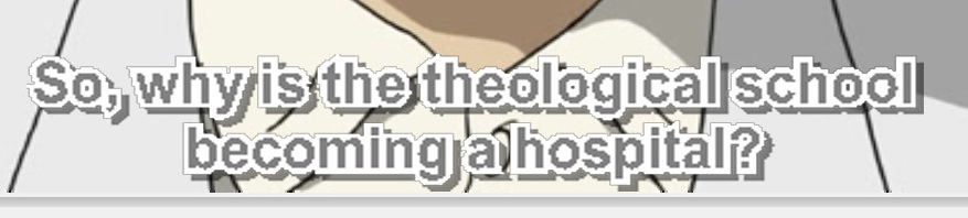

    Original:
    [Attachment 56145 - Click to enlarge]
    After conversion into VOB:
    [Attachment 56146 - Click to enlarge]
    I don't really see any options to format and preview the text using Subtitle Workshop - or at least not the way, I have been using it (loading only the STR or ASS file in question).
    If only the damn original subtitles worked in AVStoDVD

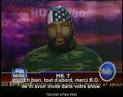

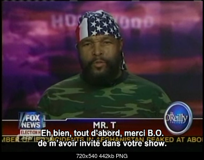

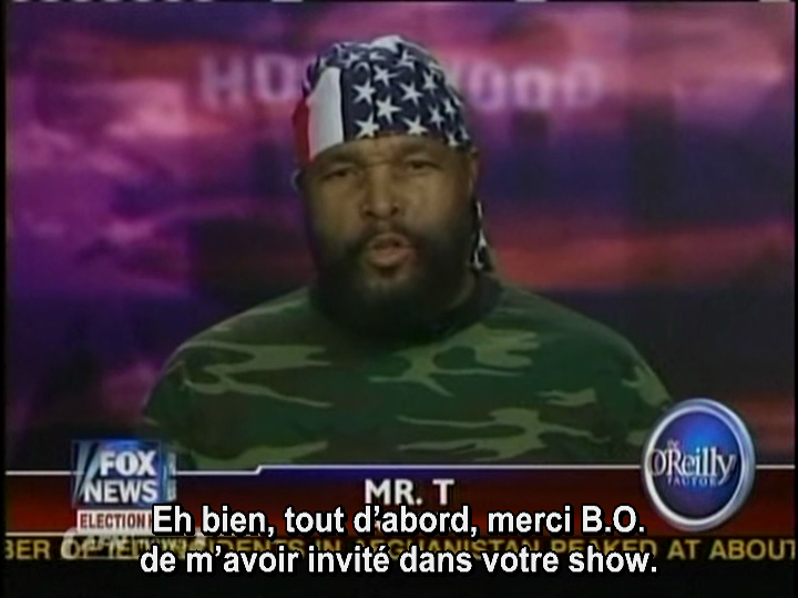

  4. Struggling with a similar task a few months ago, after some messy attempts with MaestroSBT, DVDSubEdit and SubtitleCreator, I got both a smoother experience and smoother results with EasySUP.
Name:	AVStoDVD - 2. Mr. T et Bill O'Reilly 2008.mkv - 00_01_00 -_2020-06-01-23h36m46s832 Subtitle Crea.png
    [SubtitleCreator]
Name:	AVStoDVD - 2. Mr. T et Bill O'Reilly 2008.mkv - 00_01_01 -_2020-06-01-23h36m13s345 EasySUP.png
    [EasySUP]
    I had the same kind of problem with the aspect of the subtitles on the DVD structure generated by DVDStyler not matching the aspect of the presumed “WYSIWYG” subtitles exported in VobSub format (wrong colors). The solution was to create a “palette”, and load it into the DVDStyler project. There should be something similar in AVStoDVD (I only used the latter to create DVD-compliant MPG files).
    As for the subtitles being cut off, it could be caused by a wrong frame size setting, e.g. if the subtitles were exported in PAL / 720x576 but the DVD is actually NTSC / 720x480. You can open the .idx files with a text editor (Notepad or whatnot) and check the “# Original frame size” field. Otherwise, EasySUP has a “margin” setting which can be used to place the lines further from the bottom edge.

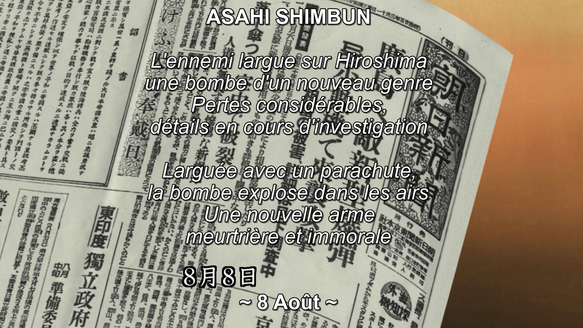

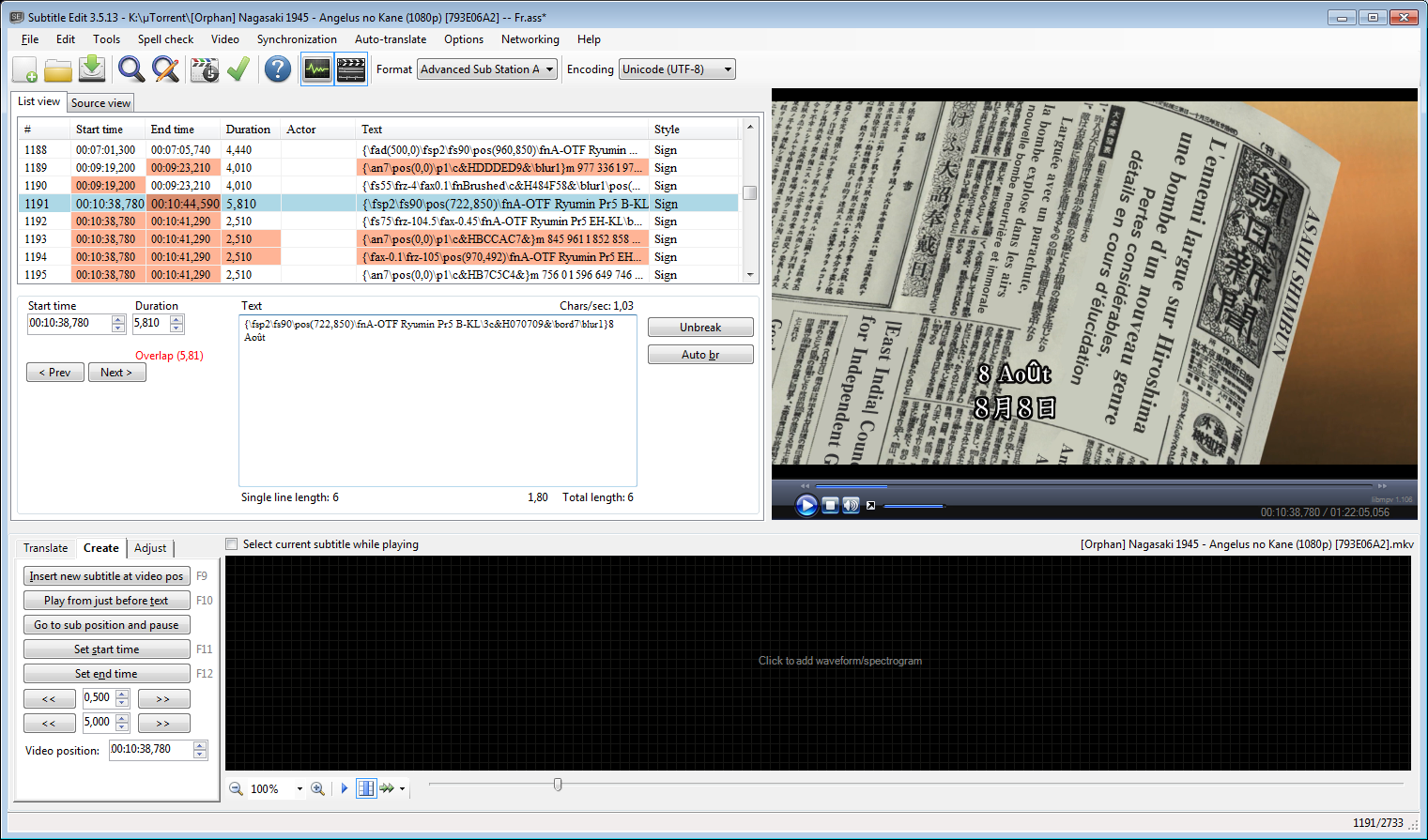

  14. Well, got it (thanks!) (also found at nyaa.si, so no need to get accustomed to a brand new method just for that one file), and even started translating it (it's definitely worth sharing indeed), so now I am in trouble...
    I'm getting that kind of display for accentuated characters, but only for dates, names of places, stuff like that. Is it caused by a missing font ? As a matter of fact, there are several fonts attached with the MKV. What is the best way to fix this everywhere it's needed ? And how do ASS subtitles work outside of a MKV file when they rely on a specific font which is not installed on the system ? Are (software) media players able to play them correctly if the font file is placed in the same folder ?
Name:	Nagasaki 1945 -- problème d'affichage des caractères accentués 3 + journal.png
    The code for this is :
    {\fsp2\fs90\pos(722,850)\fnA-OTF Ryumin Pr5 B-KL\3c&H070709&\bord7\blur1}8 Aoűt
    Also, there's the issue of those fancy rotated subtitles which mimic the titles on the newspaper, and move perfectly in sync with the backward zoom plus left panning : it's impressive, but not practical (a bit like an atomic bomb now that I think of it — sorry for the black humor) ; I would prefer to change it into regular subtitles at the bottom of the screen. Problem is, the lines corresponding to those fancy subtitles are grouped in a distinct part of the file, separated from the dialogs, which may or may not be part of the ASS specifications, so I'm not sure how to do it without breaking anything.
    Beyond that, is the ASS format likely to be recognized by a recent TV or a not-so-recent blu-ray player, or would it be necessary to convert to SRT for that purpose ?

    Regarding your new-found problems, I would suspect the letter ű didn't appear in the font used, and that the letter therefore was susbstituted with your systems' standard font - which seems to be somewhat bigger. I don't think, it's a capital letter.
    But these are guesses - hopefully someone with more insight may chime in.
  16. So, here are my french subtitles, if anyone is interested...
    https://subscene.com/subtitles/nagasaki-1945-the-angelus-bells/french/2362411 [ASS]
    https://subscene.com/subtitles/nagasaki-1945-the-angelus-bells/french/2362413 [SRT]
    As a quick follow-up : I managed to solve the font issue by simply replacing the name of the problematic font (\fnA-OTF Ryumin Pr5 B-KL\) by that of a standard font which looks about as good and has all the required accentuated characters.
    Dialogue: 10,0:10:38.78,0:10:44.59,Sign,,0,0,0,,{\fsp2\fs90\pos(722,850)\fnTimes New Roman\3c&H070709&\bord7\blur1}8 Aoűt

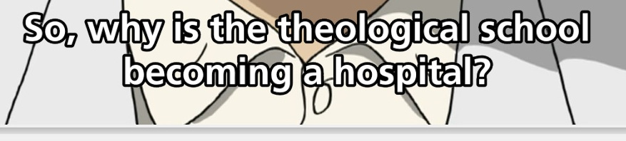

    A question if anyone subtitling-savvy cares to reply : I first translated in the ASS format used for the english subtitles, then also made a SRT version, for which I tried to retain as much information as possible from the ASS version, in particular for newspaper titles. Which means that at some points there are as many as 14 lines, with some lines left blank by adding a non-breaking space (a normal space would be ignored and the line omitted), or I used non-breaking spaces to sort-of reproduce the alignment for the credits at the very end. (I also had to add a dummy blank last subtitle after that one — which has 12 lines, with the 12th line separated by 4 blank lines with 1 non-breaking space from the group of lines above — otherwise it would be cut short.) It looks correct in SubtitleEdit, and in VLC Media Player, but I have the feeling that it breaks the rules of the SubRip standard. Is it bound to cause issues on standalone players, or even on other software players ? Are there specific limits as to what is or is not allowed within SubRip / SRT specifications ?
