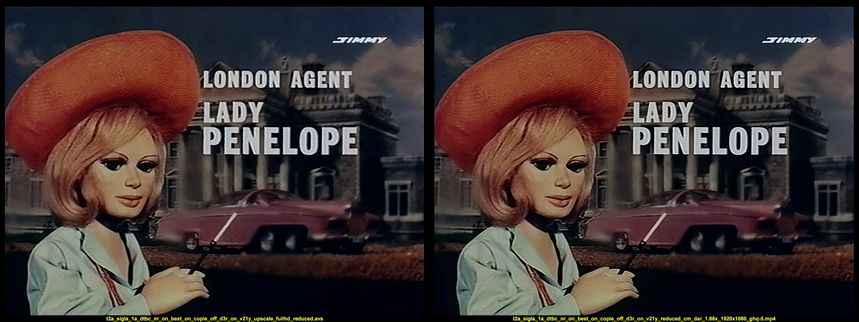

Some example of videos before/after restoration done long time ago:
transition_mc_ufo_sII2a_spot_amtv_2_cut.mp4
compare_t2a_sigla_1a_dtbc_nr_on_best_on_copie_off_d3r_on_org_v16ad-muxed.mp4
compare_thor_fc05_thor1_amtv_3_cut_org_v17.mp4
On top of the restoration, I checked Avisynth upscale versus Topaz upscale. First was the winner (small comparison in the first link)
Also understand that my videos are s-vhs captures, so my "world" can be different, and YMMV! -

I'd like to know how you processed "compare_t2a_sigla_1a_dtbc_nr_on_best_on_copie_off _d3r_on_org_v16ad-muxed.mp4" and the Thor footage. Those are both excellent. (Not saying the first link isn't, but those two really jumped out at me).
The more damaged your footage is, the more important AviSynth often is before applying TVEAI. I have seen one instance in which a direct Topaz ingestion yielded superior output to anything I attempted in AviSynth (this was not DS9 or any TV show). I don't think TVEAI is particularly optimized for VHS-derived video right now. It's much easier to get good results from 640x480 than 320x240.I haven't experimented with VCR footage specifically, but given that I've seen the application struggle with 320x240 it makes sense that it would also have a tougher time with VCR output.
"Topaz (in first instance) is "only" a resizer+sharpener, anc cannot compete with the first, especially on noisy sources requiring restoration."

Attached the avisynth scripts. They do not precisely refer to the posted comparisons (old experiments), because they changed a little bit since then.I'd like to know how you processed
They are very simple, and based on two filters developed by Didèe: TemporalDegrain and LimitedSharpenFaster.
The script for the Ufo spot deals with progressive (fields from the same moment in time) and interlaced sequences, so I lossless deinterlace the second before filtering and interlace back at the end.
The script for the Thunderbirds video adds some stabilization with LordSmurf StabMod and de-haloing with Didèe Dehalo_alpha, because the original broadcasted master has some shot with evident halo. Used with caution, because it is a destructive filter.
The script for Thor (commercial vhs) adds RemoveDirtSMC, as used by videofred.
All the filters are constantly under evolution, and more effective versions are discussed in doom9 forums (i.e. SpotLess replacing RemoveDirtSMC).
On the other side, I am not a big fan of deinterlacing and upscaling, so I am not sure you'll find any utility in the scripts.
For sure, I will follow your astonishing work on improving DS9, my PAL DVDs are also not good in quality, and the show deserves much much better
ufo_sII2a_spot_amtv_2_cut_v19.avs
t2a_sigla_1a_dtbc_nr_on_best_on_copie_off_d3r_on_v21x.avs
thor_fc05_thor1_amtv_3_cut_v22y.avsLast edited by lollo; 27th Jul 2021 at 04:24.

Comparisons. So, to be clear: This is your resizing script ("nnedi3_rpow2(rfactor=2, nns=4, qual=2, cshift="Spline36Resize", fwidth=1440, fheight=1080)" appended to my own script above. I also color graded the output so the comparisons would be apples-to-apples in that regard.
https://imgsli.com/NjI5MDI
AviSynth-alone on the left, Topaz on the right. I think this output is quite good. TVEAI is cleaning up noise, but it doesn't offer an improvement in terms of detail.
https://imgsli.com/NjI5MDM
This frame shows what some genuine improvement from Topaz, but it isn't huge. Her com badge is somewhat sharper from TVEAI, though I could compensate for this by increasing sharpening in my own filter. Hit Zoom and take a look at her eyes with the slider, though -- I like how TVEAI handles them.
https://imgsli.com/NjI5MDQ
This is one shot where I think TVEAI is cleanly better.
Here's an OG, unmodified frame (except for color) against your script recommendation:
https://imgsli.com/NjI5MDU
There's definitely improvement. Her badge and eyes are both sharper.
I tested the idea of throwing your 1440x1080 output through Topaz just to see what happened. Nothing really happened. After resize, the footage isn't any better, but it's not really worse, either. -

I agree. However, I do not know if you used some noise reduction for the AviSynth part. If your TVEAI model uses some noise reduction, you should also have some on the right part for a better comparison.https://imgsli.com/NjI5MDI
I assume here the flow is the same as before. Same considerations from my side.https://imgsli.com/NjI5MDM
Agree.
Yes, it is. But the sharpening I use on my videos is very soft, because I do not want artifacts. On your material you can maybe push a lot the sharpening and get better results also with AviSynth.Here's an OG, unmodified frame (except for color) against your script recommendation:
My impression, is that on your material, my AviSynth filtering is not completely adequate, which is normal: every video, sometimes every scene, requires dedicated procedures...
A small contribution also on my side: I compared again the full "Avisynth flow (filtering + upscale)" with a "Avisynth (filtering) + TVEAI (upscale) flow" on one of my capture. Here the result:
https://imgsli.com/NjI5Njc
I did not play a lot with TVEAI options, so the comparison is not accurate (and to be honest I compare a HuffYUV compression versus a x264 compression to save time), but I do not see a major difference, so I still prefere the free full Avisynth flow for my videos. For your work I think you should continue with your existing flow, it seems more appropriate and easier to implement.
[Attachment 60083 - Click to enlarge]
Thanks a lot for the pleasant and interesting discussion. Until next time!Last edited by lollo; 28th Jul 2021 at 10:57.
