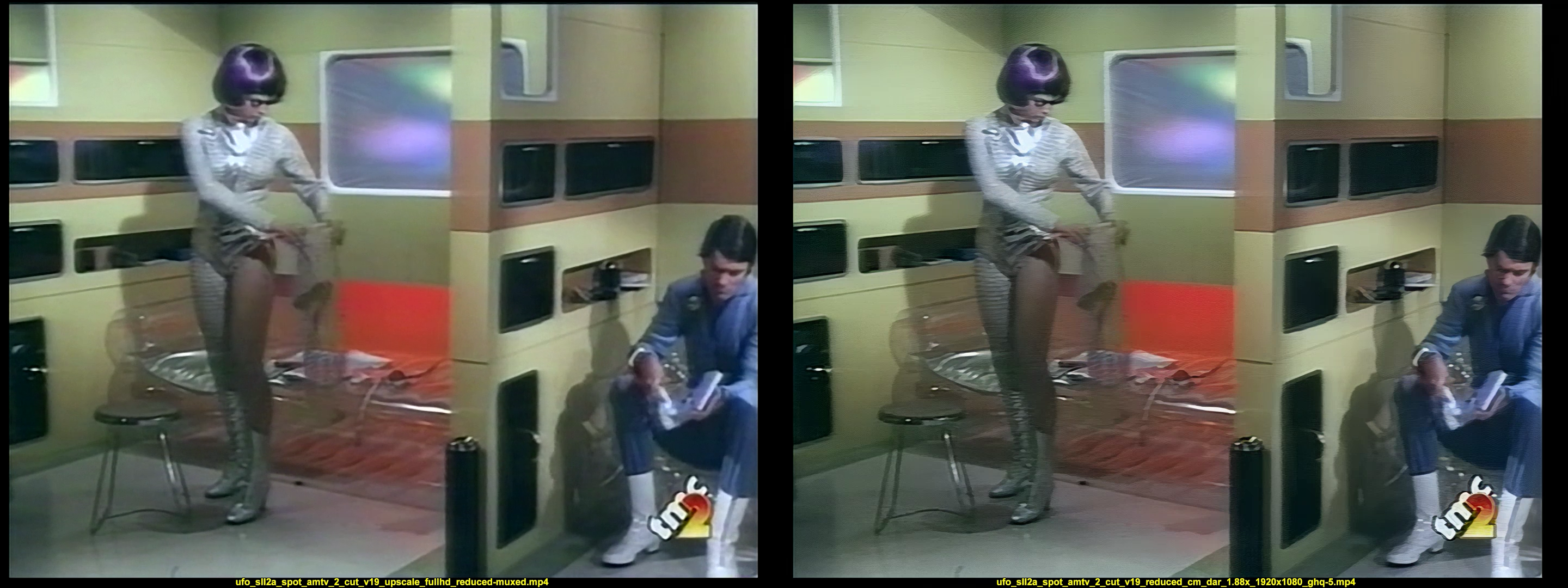

    Some details:
    workflow 1
    restoration and upscale with AviSynth
    - levels and colors correction before filtering
    - denoising
    - change color matrix
    - upscale with nnedi3_rpow2
    - sharpening
    - levels correction after filtering
    - compression with h264 (just to compare and upload the sample)
    workflow 2
    restoration with AviSynth (as per workflow 1)
    - denoising
    - sharpening
    upscale with Topaz Video Enhance AI
    -- avisynth output of previous steps is the input for Topaz
    Some remarks
    - Upscale is from 720x576 4:3 to 1920x1080 full HD
    - I only used progressive videos; I ignore Topaz deinterlacing procedures, but I doubt it can be any better than QTGMC in AviSYnth
    - The sharpening in the AviSynth step of workflow 2 should probably be slightly reduced to compensate sharpening occurring in Topaz
    - It appears to me that some (additional) desoining is happening in Topaz
    - The h264 compression done inside Topaz is out of control, you can only choose "Compression Factor" (bitrate allocation, I used middle setting)
    - DAR parameter (4:3) has been added to the video input of Topaz with ffmpeg, otherwise Topaz will not respect width proportion
    - For the attached sample I used Gaia High Quality model
    Attached the results. The starting video capture is not that good, and the bitrate for workflow 1 is lower, but you can compare yourself
    workflow1:
    ufo_sII2a_spot_amtv_2_cut_v19_upscale_fullhd_reduced-muxed.mp4
    workflow2:
    ufo_sII2a_spot_amtv_2_cut_v19_reduced_cm_dar_1.88x_1920x1080_ghq-5.mp4

    This is not a valid comparison, workflow 1 and workflow 2 do not follow the same order, in W1 you upscale after you change the color matrix but before sharpening yet in W2 the upscale is the last thing you do. You can't make a valid Topaz vs nnedi3_rpow2 comparison under these conditions.
    More importantly, and I'm sure that many people will disagree with me, I would think the best results would be to upscale first then do all the restoration that you do.
  17. Captures & Restoration lollo's Avatar
    Jul 2018
    Italy
    In W1 I change color matrix and then upscale, as, if I am not wrong, it is supposed to be. I experimented that a sharpening after upscale gives better results than doing it before, so this is my reference flow for this video.
    In W2 I change the color matrix and then upscale, as, if I am not wrong, it is supposed to be.
    I have no control on Topaz sharpening: as I said I can only guess its "procedures" based on the results, and try to adapt the avisynth sharpening step to do not interfere too much.
    I also tried to completely remove the AviSynth LSFmod sharpening step rather than playing with its parameters, but still Topaz is not a clear winner.
    If you can suggest a better comparison flow, please do so.
    I am one of them
