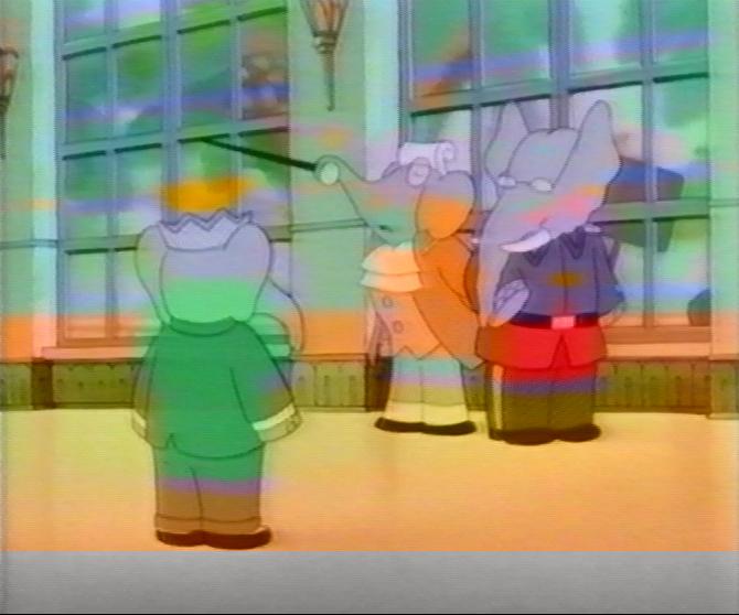

  6. OK. Having Chroma Offset after QTGMC makes much more sense now. I can actually see Black and White section on the lower part of the video (I shifted 3 pixels up with Y=3). Which makes sense makes sense as all the Chroma shifted up! So I cropped by 4 more pixel on the bottom to negate that. It pretty much means that if I am to use Chrome Shift, no AutoCrop pluging will work. Will have to do it manually.
    Some else I noticed when playing around with Crop and Chroma Sharping. I noticed that specific video I masked, wasn't perfectly masked. I could have masked 2 pixel extra to the right to make it looks better. So I adjust the cropping level:
    crop(26, 8, -24, -10)
    Instead of:
    crop(24, 8, -24, -10)
    But this break Chroma Sharping. Because "Planet Destination Size must be a multiple of 2". But it's already is it right? because I change from 24 to 26? so the Total is still a multiple of 2? It wasn't the first time, I see a similar thing once using perfect crop(26, 6, -26, -6): "nnedi3_rpow2: YV16 input width must be mod 4 (334). I can make it mod 334 and it will work, but it means I'm cropping more then I want.
    I wasn't able to detect a change when using "Grain" on a carton (and the file is almost double the size). I will see how it work with Camcorder footage next.
    Thanks!
  7. When you shift the chroma up by three pixels the bottom 3 pixels of the frame are unchanged. So the solution is to crop away the black borders, shift the chroma, then add the borders back (if necessary).
    Yes tune=grain is expensive in terms of bitrate (it takes a lot of bitrate to retain grain/noise). But it will prevent posterization artifacts in shallow gradients. This is most visible in dark areas and blue skies. Whether it's of benefit with VHS depends on how much noise you remove.
  8. When you shift the chroma up by three pixels the bottom 3 pixels of the frame are unchanged.

  9. Originally Posted by Okiba View Post
    What do you mean by "unchanged"? attached you can find the original video (720x576) without any cropping (but with black bars/masking), with Shift L=3. This makes sense to me before all the chroma shifted up - so it means the bottom 3 pixel no longer had Chroma. So instead of cropping just the black bottom bar - I also crop the the 3 extra pixels (4 technically speaking).
    I was wrong about the unchanged chroma -- what happens is the chroma from the very last line is repeated to cover the are for which there would be no chroma. Here I first cropped the frame to eliminate the black borders but then added a single pixel thick black border to the bottom and shifted the chroma up by 30 lines:
    [Attachment 55317 - Click to enlarge]
    You can see that the chroma from the black line was used to fill the bottom 30 lines.

  10. what happens is the chroma from the very last line is repeated to cover the are for which there would be no chroma
    Oh, OK. That makes sense. So In case I Shifted 3 lines up, the 3 bottom lines will be looking strange (as they are being repeated). So the only reason solution here is to crop those 3 bottom pixels?
    I'm swinging about playing around with Chroma Offset, at least when the pixel count is low. For example, It's clear there's a Chroma Offset on the Crown (the attached NoShift.jpg). However - on the other scene (NoShift2.jpg), there still some point where you see the Chroma Offset (like the brown strike on top right). But the Grey faces, and the cloths - not so much. It's looks like Chroma Offset is very visible on specific colors, or on contrasted background. Is it worth cropping 3 pixels from the bottom? Maybe?
    The error message is because of the Spline36Resize(width/2, height) on that line. After cropping, downscaling the 670 pixel wide frame would result in 335 pixels wide

  11. Originally Posted by Okiba View Post
    The chroma is shifted down on everything -- it's just not as noticeable in some areas.
    I would just crop away black borders before the shift (and restore the border afterward if you need it). That will keep the last lines of the active picture from becoming greyscale (which can be very obvious). With most picture content the fact the last 3 rows have the same chroma won't be very obvious -- especially with the very blurry chroma of VHS.
    Crop(0,0,0,N).ChromaShiftSP(y=3).AddBorders(0,0,0,N)

  12. With most picture content the fact the last 3 rows have the same chroma won't be very obvious -- especially with the very blurry chroma of VHS.
    It indeed depends on the content I guess. I crop before saving it as view-able x264. So I don't need the black bars back. Attaching two pictures (same video, same AviSynth script). One one picture is visible, but not much (you can see black dots on a yellow background, but that's OKish). The other one you is much more harsh (that's without borders, I even 2 extra pixels just in case the preview doesn't some some black section). I also guess it's more prominent on cartoons.
    Spline36Resize() failed because it could not produce the 335 pixel wide output.
    My bad was that I took the original width and adding the cropping: 720-24-26 = 670. 670 can be divided by two, so I wasn't sure whats up. I wasn't taking in mind the second divide that brings it into 355 Learn new stuff everyday!
    So I changed to Spline36Resize(width/8*4, height) (which always results in a mod4 width)
    I don't yet know how it being processed in the background, so I wondered if the resize working differently if the width is different variant of mod4. But if it's the same, I can just replace:
    MergeChroma(last, Spline36Resize(width/2, height).aWarpSharp(20).Sharpen(1.0).nnedi3_rpow2(2, cshift="Spline36Resize", fwidth=width, fheight=height))
    With this:
    MergeChroma(last, Spline36Resize(width/8*4, height).aWarpSharp(20).Sharpen(1.0).nnedi3_rpow2(2, cshift="Spline36Resize", fwidth=width, fheight=height))
    And I should be good Sharping any resolution

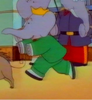

  13. Following on that problem. I think it's the video fault. Attached is the Loseless file. I'm not sure what exactly is happening at the bottom. But it looks like strange dots. I tried a different cartoon, and as you said - it's not that major like the pig picture on the post above.
  14. Those are dot crawl artifacts from incomplete removal of the chroma carrier from the luma in a composite video source. They appear in many places in your videos, in and near areas of high color saturation. The more saturated the colors the stronger the dots can be. Some capture devices are better able to filter them out.
    https://en.wikipedia.org/wiki/Dot_crawl
    Another way to reduce them is to downscale horizontally then upscale:
    Spline36Resize(width/2, height).Spline36Resize(width, height)
    That usually doesn't hurt VHS too much because of the generally low resolution of VHS.
    Using an S-VHS deck for playback can eliminate them entirely.

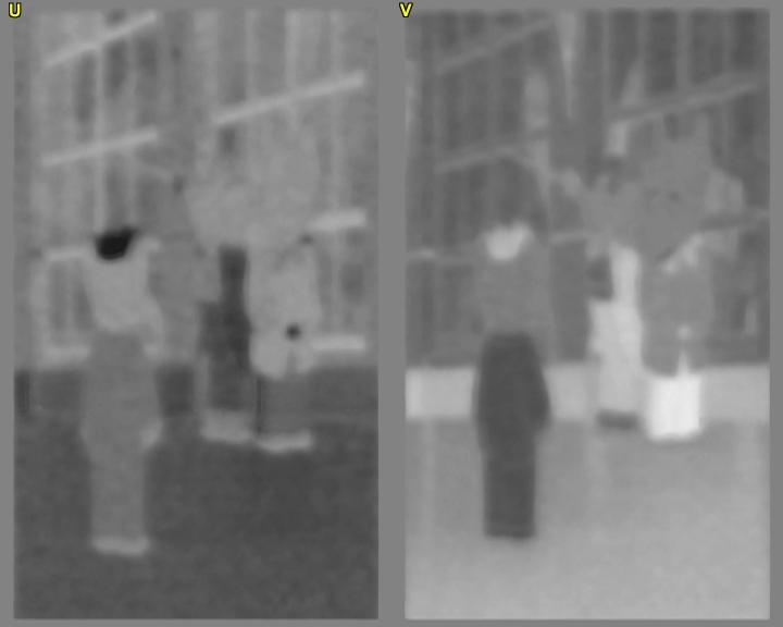

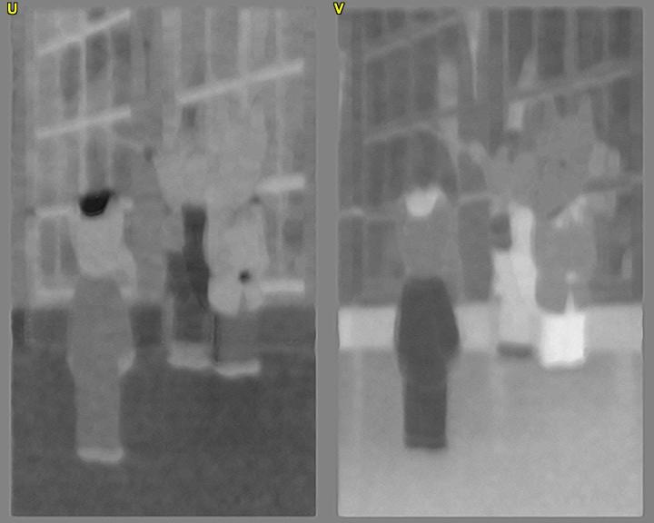

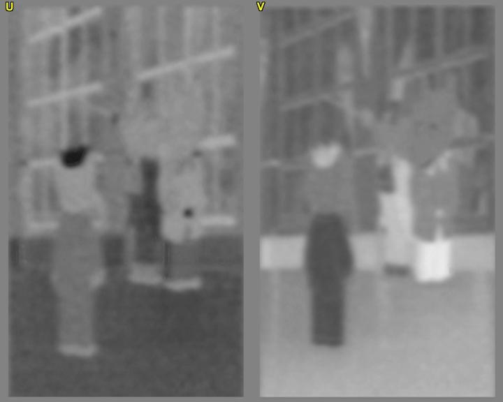

  18. A dumb question:
    What's the idea behind using aWarpSharp at half horizontal resolution with MergeChroma, like
    rather than just
    aWarpSharp(20)
    I tried to compare using the script
    v0=AviSource(.....).converttoYV16(interlaced=true).separatefields()
    v1=v0.ChromaShiftSP(x=0, y=1)
    a=v1.aWarpSharp2(depth=20).subtitle("a")
    b=MergeChroma(v1,v1.aWarpSharp2(depth=0)).subtitle("b")
    c=MergeChroma(v1,v1.aWarpSharp2(depth=20)).subtitle("c")
    d=MergeChroma(v1,v1.Spline36Resize(width(v1)/8*4, height(v1)).aWarpSharp2(depth=20).Sharpen(1.0).nnedi3_rpow2(2, cshift="Spline36Resize", fwidth=width(v1), fheight=height(v1))).Subtitle("d")  #mod4 compliant
    return interleave(v1,a,b,c,d)
    The sharpest (.... oversharpened, "thinned") picture with my 'natural' test video is from a. Is the script ok at all, or do I miss something (I probably do...) ?
    Thanks.

  21. Originally Posted by Sharc View Post
    With VHS the chroma resolution is usually far less horizontally than vertically. The idea is to get the horizontal and vertical resolution of the chroma closer to the same so that the sharpening and warping is more similar on both axis.
    Source chroma:
    [Attachment 55360 - Click to enlarge]
    aWarpSharp(depth=20) only:
    [Attachment 55362 - Click to enlarge]
    Spline36Resize(width/8*4, height).aWarpSharp(20).Sharpen(1.0).nnedi3_rpow2(2 , cshift="Spline36Resize", fwidth=width, fheight=height)
    [Attachment 55363 - Click to enlarge]
    Though looking more closely at the OP's video the vertical chroma resolution is pretty low too. So it may have worked better reducing both axis.
  22. Originally Posted by jagabo View Post
    Ah I see. Thank you.
    Maybe the OP's source was 4:2:0 (even interlaced) at some stage.

  29. Here's an example with your Barbar video.
    # simple saturation-like mask
    function Saturation(clip vid)
        U = Overlay(vid.UtoY().ColorYUV(off_y=-128), vid.UtoY().Invert().ColorYUV(off_y=-128), mode="add")
        V = Overlay(vid.VtoY().ColorYUV(off_y=-128), vid.VtoY().Invert().ColorYUV(off_y=-128), mode="add")
        Overlay(U, V, mode="add")
        Spline36Resize(vid.width, vid.height)
    LWlibavVideoSource("Babarraw.avi")
    AssumeBFF()
    src = last
    SeparateFields()
    blur = Spline36Resize(width/4*2, height).Spline36Resize(width,height)
    smask = Saturation().ColorYUV(gain_y=1100, off_y=-50)
    #return(Interleave(last, smask))
    Overlay(last, blur, mask=smask)
    Weave()
    Interleave(src.Bob(), last.Bob())
    Enable the return line to see the mask (alternates between field and mask).
  30. I didn't have a lot of time to play around with it (more like Copy-paste and compare the results). The upper section is indeed less harsh. But everything else is also soft. Are the dots in the Crown are also Dot Crawling? Also - this is baseline. No Croping/QTGMC etc.
    It's probably the fault of this specific video. While I do see dots crawls in other videos, it's no where near this one. It's possible the original broadcasted video was just plain bad.
    Thanks!
    EDIT: Well, I play around with the Chroma Shift (x), and those dots are almost gone when I set it back to 0. So I'm assuming that not dot crawling but another problem. or moving the chrome on the X makes it worse.
