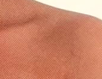

  1. I have this old DVD footage that exhibits a severe moiré-like pattern and I have no idea how to work with it. I've tried running TemporalDegrain and Santiag just to see, but as I expected they didn't really improved the picture. Thoughts?
    [Attachment 52030 - Click to enlarge]
    (an upscaled version)
    [Attachment 52031 - Click to enlarge]
  2. That's not moire. It's dot crawl artifacts -- the chroma carrier has not be separated from the luma.
    https://en.wikipedia.org/wiki/Dot_crawl
    There are many dot crawl filters available for AviSynth.
    http://avisynth.nl/index.php/External_filters#Rainbow_.26_Dot_Crawl_Removal
    If the video isn't real sharp (for example a VHS recording) you can downscale to about half width, then upscale again.
    Spline36Resize(width/2,height).Spline36Resize(width,height)
    That eliminates most of the dot crawl. But sharper sources will be blurred.
  3. Are you certain this is dot crawl? I've tried LUTDeCrawl and Checkmate but both fail to improve the picture in any significant way which I find surprising. I'm having more luck with rescaling though.

  4. I'm pretty sure jagabo's diagnosis is correct: dot crawl.
    You should do a quick search in this forum, and also over at doom9.org. Just enter "dot crawl" and see what solutions are posted.
    I first had to deal with this when fixing an old Kinescope. I posted about it here:
    Remove cross hatch pattern from Kinescope
    I had really good luck using a simple convolution kernel. That link will provide you with the details.
  5. Thank you, using the custom matrix worked out much better than any decrawlers I tried and the result ends up being quite acceptable. I guess I can't do much more without managing to locate the original VHS source now.
