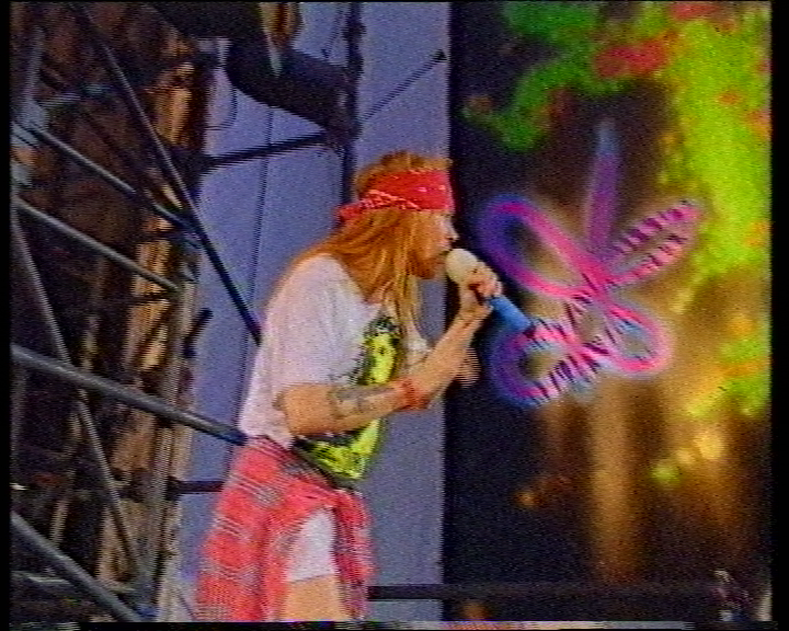

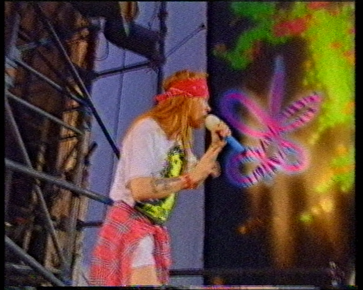

Firstly, two captures without the ES10 in the chain - just the JVC plugged straight into the Hauppauge (always S-video), once with the TBC on and once with it off. The JVC is in EDIT mode, and always is unless otherwise stated. Screenshots here, video samples attached below.
01 Axl direct, TBC ON, EDIT
[Attachment 55187 - Click to enlarge]

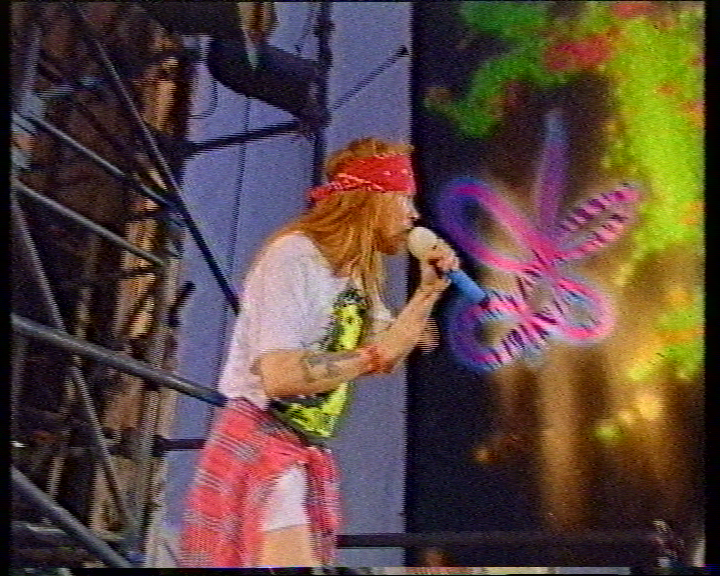

02 Axl direct, tbc off, EDIT
[Attachment 55188 - Click to enlarge]
Now the same thing, but adding the ES10 into the chain:
03 Axl TBC ON, EDIT
[Attachment 55189 - Click to enlarge]
04 Axl tbc off, EDIT
[Attachment 55190 - Click to enlarge]
Now the same as previous, but with the so-called B.E.S.T. mode enabled. (That's its name in PAL regions - I think it's called something else in NTSC models.)
05 Axl TBC ON, EDIT plus BEST
[Attachment 55191 - Click to enlarge]
06 Axl tbc off, EDIT plus BEST
[Attachment 55192 - Click to enlarge]
What do you think? I'm not keen, so that's the last we'll see of B.E.S.T. mode in this test. Now let's compare EDIT mode versus NORMAL mode. 03 and 04 above are in EDIT mode; the following are the same in every other respect, but switched to NORMAL mode.
07 Axl TBC ON, NORMAL
[Attachment 55193 - Click to enlarge]
08 Axl tbc off, NORMAL
[Attachment 55195 - Click to enlarge]

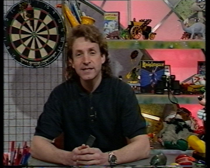

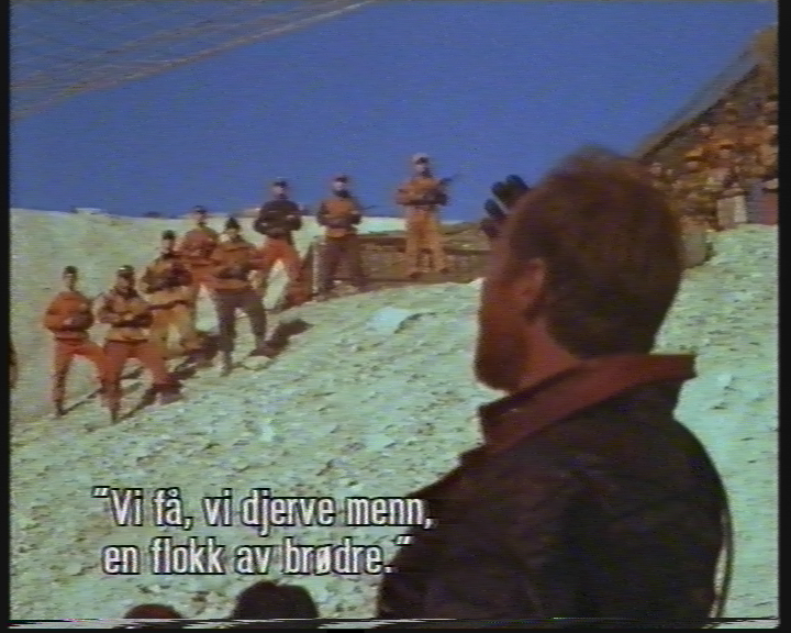

Let's explore this further with different clips. These next four are worth lining up in an NLE, zooming in to 400% on that grating and dartboard behind the presenter, and comparing. These two are EDIT mode with the TBC on and off:
09 CITV TBC ON, EDIT
[Attachment 55197 - Click to enlarge]
10 CITV tbc off, EDIT
[Attachment 55198 - Click to enlarge]
And these two are in NORMAL mode with the TBC on and off.
11 CITV TBC ON, NORMAL
[Attachment 55199 - Click to enlarge]
12 CITV tbc off, NORMAL
[Attachment 55200 - Click to enlarge]

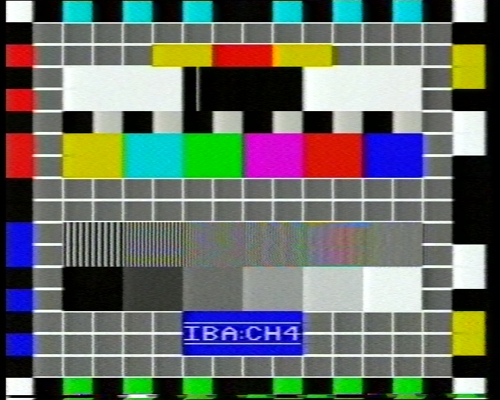

I just happen to have an ancient test card on a tape, so same again. EDIT mode:
13 Test card TBC ON, EDIT
[Attachment 55201 - Click to enlarge]
14 Test card tbc off, EDIT
[Attachment 55202 - Click to enlarge]

Taking stock so far, to my eyes the best-looking chain is to have the TBC switched on in EDIT mode. However, this also comes with a downside, which I posted about here a while back. That is to say, switching on the TBC also enables the unit's noise reduction filters, which can cause a sort of temporal smearing that's sometimes noticeable at scene changes. Turning the TBC off reduces the problem so that it's rarely noticeable to me on playback.
That said, turning the TBC off comes with its own problems, including the obvious slight overall reduction in picture quality (as evidenced above), and also the stability of the playback. You're going to have to trust me on this, but I did a few stress tests of capturing entire four-hour tapes in one go; those with the TBC off tended to either skip or duplicate a frame on average every 12 to 13 minutes or so, even though I was using a relatively pristine tape. With the TBC on, the capture was rock solid, with the only variations (versus with TBC off - I lined them up in Premiere) coming around breaks in the recordings.

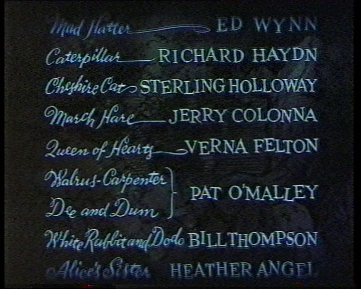

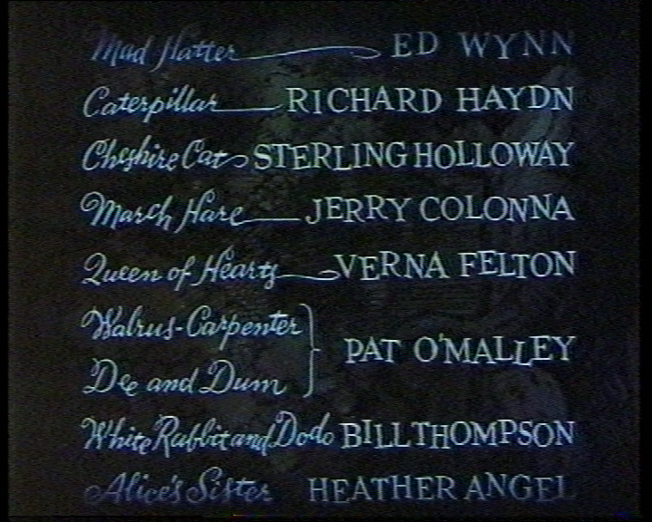

Back to downsides of having the TBC switched on, things get a bit iffy when it comes to rather more battered old tapes. We're sticking with EDIT mode here, going through the ES10, and the TBC is on:
17 Alice TBC ON, EDIT
[Attachment 55205 - Click to enlarge]
See all those single-field up-and-down jumps in the video sample? (Do they have proper name, by the way?) Well, let's turn off the TBC and see what happens:
18 Alice tbc off, EDIT
[Attachment 55206 - Click to enlarge]
What an improvement! It's not quite perfect, but that, in a nutshell, is the ES10 earning its keep. Feed it a dirty signal, and it stabilises the picture superbly - far better than I'd have imagined - but it does have to be a dirty signal. Feed it something already TBC'd and it doesn't detect anything that needs stabilising. The trade-off of picture stability versus overall quality is a bit of a quandary, especially when you factor in those occasional skipped/duplicated frames, but in all honesty I'll take the non-jumpy version every time, regardless of the other issues introduced.
So, in conclusion, EDIT mode, TBC on if the tape is in good condition, and you'll get fantastic captures, as long as you can live with that temporal smearing. If the tape is less well-behaved, EDIT mode, TBC off gets the best results possible.
Agree or disagree? Am I going wrong anywhere? Should I be adding anything to the chain after the ES10 to help matters when the JVC's TBC is off? Any further observations or suggested improvements will be very welcome.
