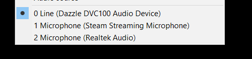

    Thanks for this, i did manage to install the Dazzle Audio Driver but when i go in to Virtualdub2 the Audio Capture USB WDM source is not there to select and the video source is black if i select the Line Source. I also tried it in VirtualDub 1.9 and amarectv 310 and get the same results.

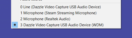

    If i re-install the Microsoft Audio Driver, i can select the WDM Audio source and the video source comes back, but the audio goes out of sync after a few seconds of capture, and gets worse the longer it goes on.

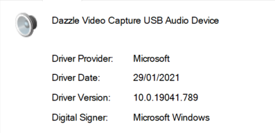

    This is the the Audio Driver that installs automatically if you just plug the device in.

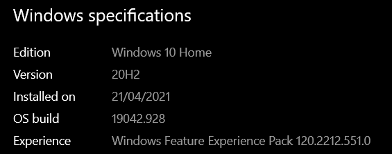

    This is the Windows Version
