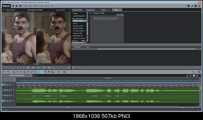

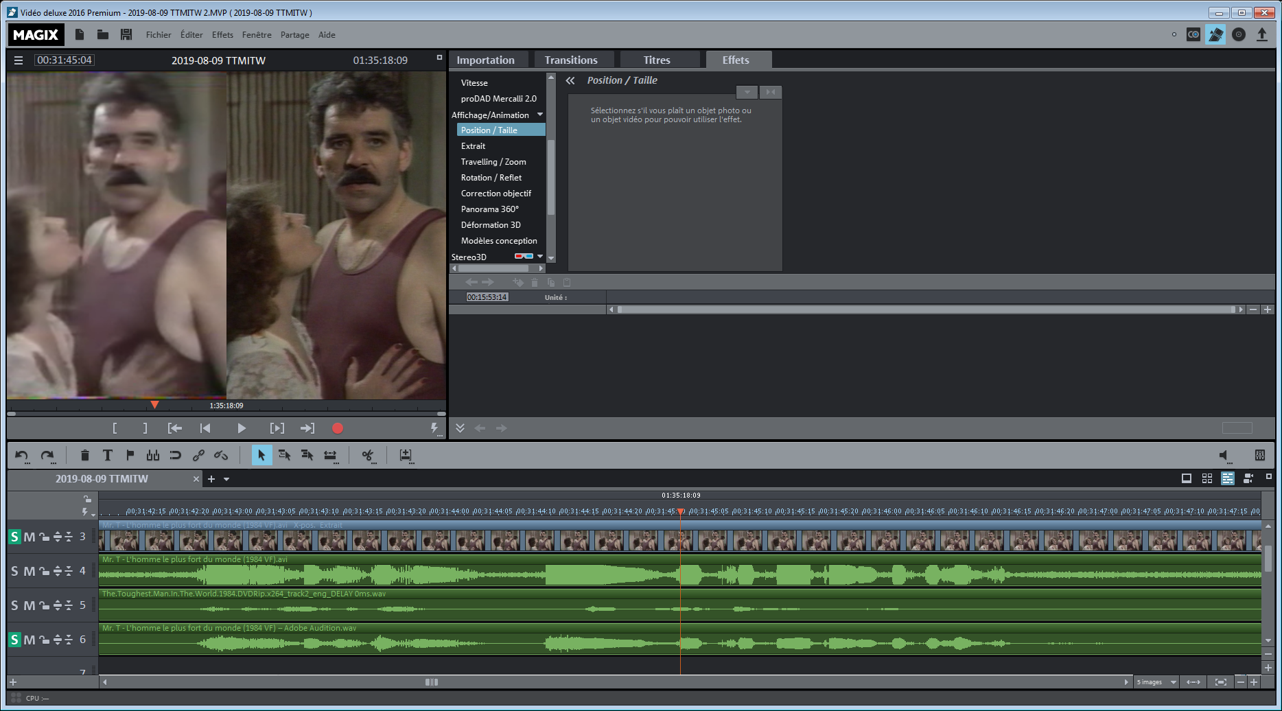

  6. I had a similar issue about a year ago, after some unsuccesful fiddling with Avisynth I managed to get it done with the method suggested above : adding both files on the timeline of a non-linear editor (the one I currently use being Magix Video Deluxe but any other decent recent editor should have the required features), cropping each video so that they appear as the left half and right half of the picture, then scrub quickly until I notice a discrepancy, then go back slowly to pinpoint where the discrepancy actually is and adjust accordingly.
Name:	TTMITW 31;45.04 (il semblerait que des images intermédiaires soient manquantes).png
    I found out that the original language version, although a much better quality DVD transfer, had a few shots missing compared with the french dubbed TV recording, and also at one point it was missing just a few frames, perhaps 4 or 5 (those were present in the dubbed TV recording), which was barely noticeable as it's in a scene with little motion (the screenshot above was made to keep a record of that glitch : both halves were in sync 1 frame before, but then on the right half the male actor suddenly moved forward, while the movement was smooth on the left side), but it was enough to cause a significant desynchronization. A situation like this would be very difficult to detect automatically, considering how different the picture quality is when comparing strictly identical frames (without even considering the fact that the dubbed version had blended frames and duplicated frames).
