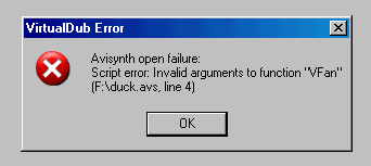

Trying to use this filter here:Code:LoadPlugin("c:\program files\avisynth2\plugins\MPEGDecoder.dll") MPEGSource("f:\duck.mpg") LoadPlugin("c:\program files\avisynth2\plugins\fanfilter.dll") VFan(yuy,0,1,"pass",32,gyplus=8,gyminus=8) ConvertToYUY2()
http://www.avisynth.org/warpenterprises#fanfilter
Trying to do what it shows at the top of page 3 in the Word DOC that comes in the zip file with the filters. It's just super-barebones and doesn't tell you much AT ALL, in terms of usage for writing the scripts.
Just really at a loss for what to fix where. Help!?
I get this:

The first argument to almost any AVISynth call usually refers to a clip reference, which you are not using in this case. I have not tried this myself, but either of these might work...
Or,Code:LoadPlugin("c:\program files\avisynth2\plugins\MPEGDecoder.dll") LoadPlugin("c:\program files\avisynth2\plugins\fanfilter.dll") MPEGSource("f:\duck.mpg") VFan(0,1,"pass",32,gyplus=8,gyminus=8) ConvertToYUY2()
Give is a shot. Sorry I can't test now 'cause I'm not at home.Code:LoadPlugin("c:\program files\avisynth2\plugins\MPEGDecoder.dll") LoadPlugin("c:\program files\avisynth2\plugins\fanfilter.dll") clip = MPEGSource("f:\duck.mpg") VFan(clip,0,1,"pass",32,gyplus=8,gyminus=8) ConvertToYUY2(clip)

Well, "yuy" is not something I wrote. Did you glance at the DOC file in the ZIP file for the filter? That's the only line he wrote, for an example. None of the preceeding code was written.
VFan(yuy,0,1,"pass",32,gyplus=8,gyminus=8 )
That's the only thing that was pre-written.
The rest is what I had to write, guessing mostly.Want my help? Ask here! (not via PM!)
While this loads the file, the filter is not doing anything.Originally Posted by tdanWant my help? Ask here! (not via PM!)
Yes, I saw that. I also looked at the source code and found that "yuy" should have been "yuy2" (no mentions of yuy but plenty of yuy2). Maybe the script shown has a typo.

Alright SLK001, I tried it:
YUY2
Code:LoadPlugin("c:\program files\avisynth2\plugins\MPEGDecoder.dll") LoadPlugin("c:\program files\avisynth2\plugins\fanfilter.dll") MPEGSource("f:\duck.mpg") VFan(yuy2,0,1,"pass",32,gyplus=8,gyminus=8) ConvertToYUY2()
"YUY2"
Code:LoadPlugin("c:\program files\avisynth2\plugins\MPEGDecoder.dll") LoadPlugin("c:\program files\avisynth2\plugins\fanfilter.dll") MPEGSource("f:\duck.mpg") VFan("yuy2",0,1,"pass",32,gyplus=8,gyminus=8) ConvertToYUY2()
Apparently, you don't have to specify the colorspace value - I guess that it is passed from AVISynth. Also, this newer version seems to require a clip name. This script works (doesn't crash):

I looked at the source code and the following should work (the filter requires YV12, YUY2 or RGB):
Code:LoadPlugin("c:\program files\avisynth2\plugins\MPEGDecoder.dll") LoadPlugin("c:\program files\avisynth2\plugins\fanfilter.dll") MPEGSource("f:\duck.mpg") VFan(0,1,"pass",32,gyplus=8,gyminus=8)An error in his doc. I will tell himDid you glance at the DOC file in the ZIP file for the filter? That's the only line he wrote, for an example. None of the preceeding code was written.
My bad. I got it to work last night, but I posted the wrong code. Here is something that is working:
Code:v1=mpeg2source("d:\Experiment\CHHTEST.D2V") VFan(v1,0,1000,opt="pass",gyplus=8,gyminus=8) ConvertToYUY2()ICBM target coordinates:
