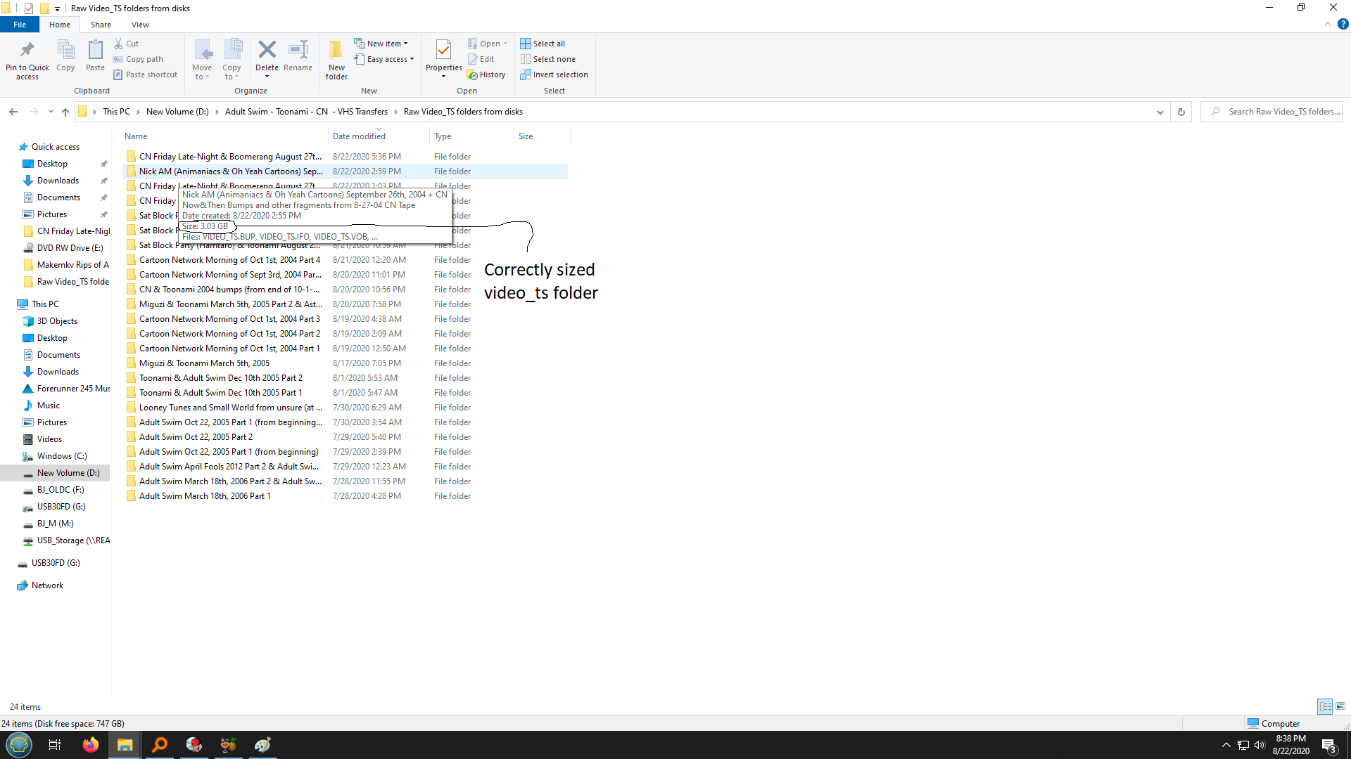

    I have been transferring some of my old VHS tapes to DVD-R's recently with my Panasonic combo player. From there, I have been copying the contents of the disks onto my hard drive, by making a copies of the "Video_TS" folders. However, it appears that only some of these disks are copying correctly to my hard drive. Instead of being between 3-4gb (depending on how much VHS material was transferred onto the disk) as it should be, some of them are only 120-200mb large. That being said, I know that all the contents were copied over in the the latter's case, because the whole movie plays fine as long as I play it straight from the disk on my pc.
    Any ideas as to what could be causing this? Could it have to do with something going wrong during the VHS to DVD transferring process? I have attached some screenshots to show the discrepancies in files sizes in the Video_TS folders (which I renamed to reflect the contents from the disks).

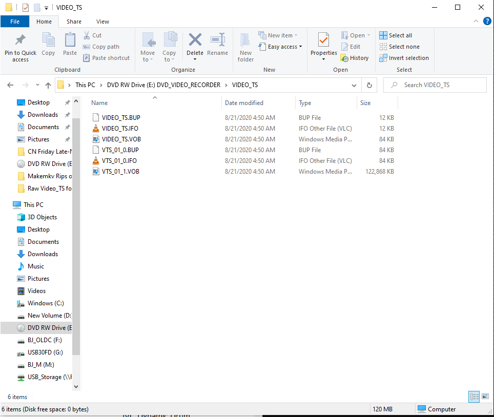

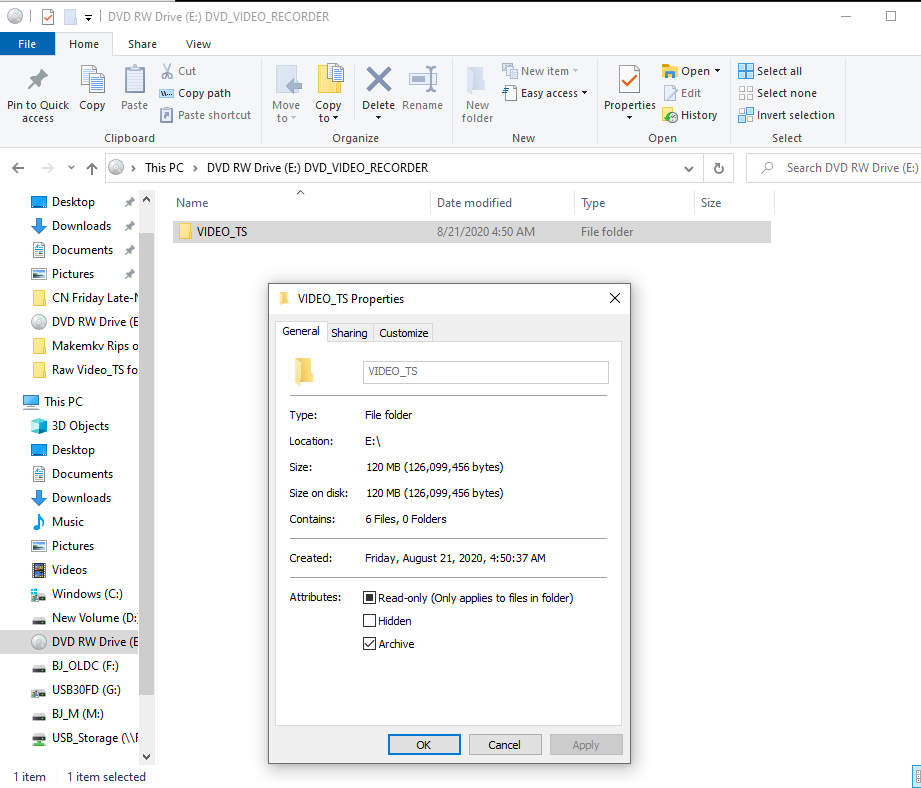

    Ok, this is one of the the affected disks that is not copying correctly. It is also is showing as being only 120mb, just as it is when I copy it to my hard drive. However, the full 2 hours of content of the disk are playing fine.

    Oh, I'm sorry. Here you are.

    If you attempt to play that 120 MB file by itself by double clicking on it or by dragging it to mpc-hc, mpc-be, VLC or similar player,
    Does it play? Is it the movie? How many minutes long is it?

    No, it apparently only plays for about three minutes (I'm using VLC player as default by the way). However, when I first stick the disk in and it launches automatically (also from VLC player), the whole two hours of content are playable.
    I also noticed from one of the the working copied Video_TS folders that there are files called VTS_01_2.VOB, VTS_01_3.VOB and VTS_01_4.VOB that are not present in the ones not working.

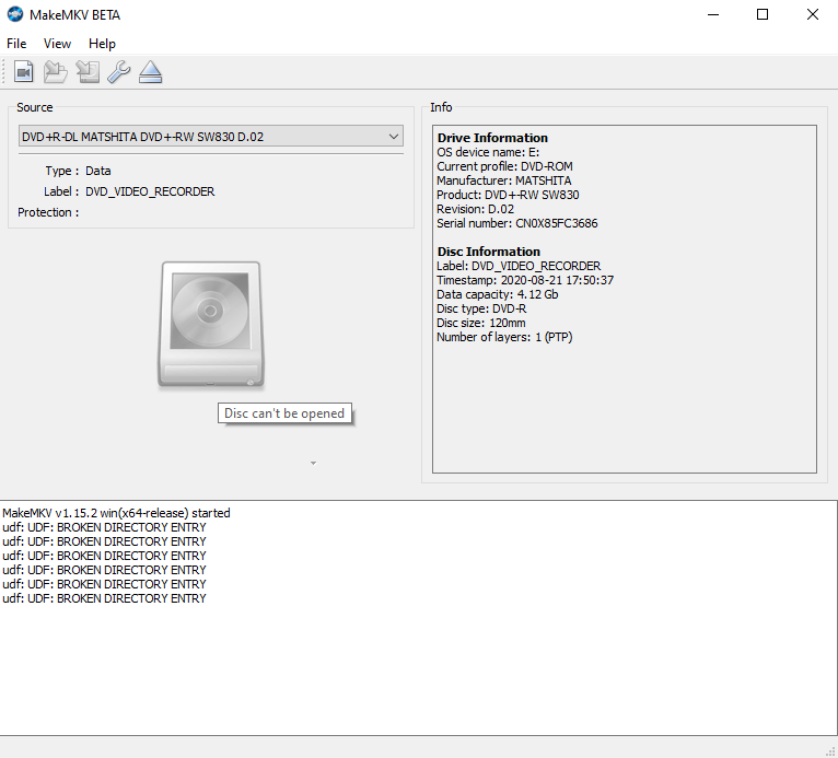

    I actually have an unrelated issue with MakeMkv. It apparently doesn't want to read straight from the disk in any case (even on the disks where the 4gb show up) giving a "udf: UDF: BROKEN DIRECTORY ENTRY" error code (it also shows this when I use my external disk drive). However, if it's a disk where the 4gb video_ts folder copies over correctly to my harddrive, and I go to file>open files and put in the video_ts folder, it successfully makes .mkv files. I've attached screenshots.
    I have not use dvdfab yet though.
    I should have also mentioned that I was using a program called handbrake, and the whole disk seemed to transfer when I hit encode, but I was told not to use that program because it doesn't make an exact 1:1 copy as it would through makemkv or copying the video_ts straight from the disk drive. The quiailty of the encoded version is not bad, but as these are low quality recording to begin with, I would prefer not to lose anymore quality if I can help it, hence wanting to have a copy of the raw video_ts folders on my hard drive.

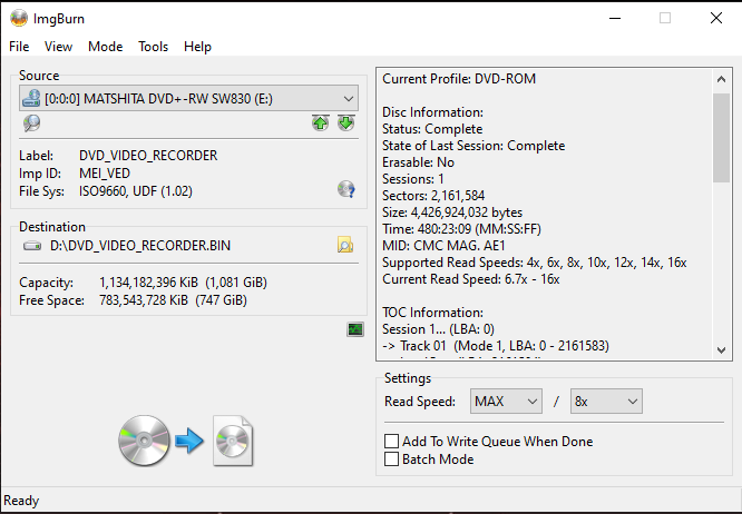

    It would be interesting to see if Imgburn "sees" the whole disk.
    You could use it to create an iso image, then right click the image in Explorer and mount it.

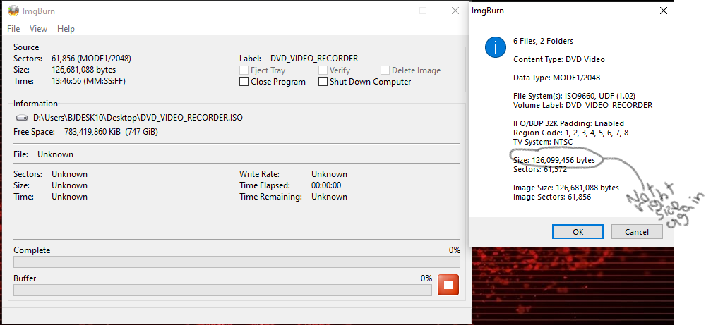

    Imgburn may have worked, but I get an error saying "Sorry, using Read mode to create an image file from a multi-track DVD-ROM disc is not currently supported. Instead use Build mode to create a 'clean' image based on the contents of the disc". When I do use build mode, it also spits out a 120mb file though (screenshots attached).
