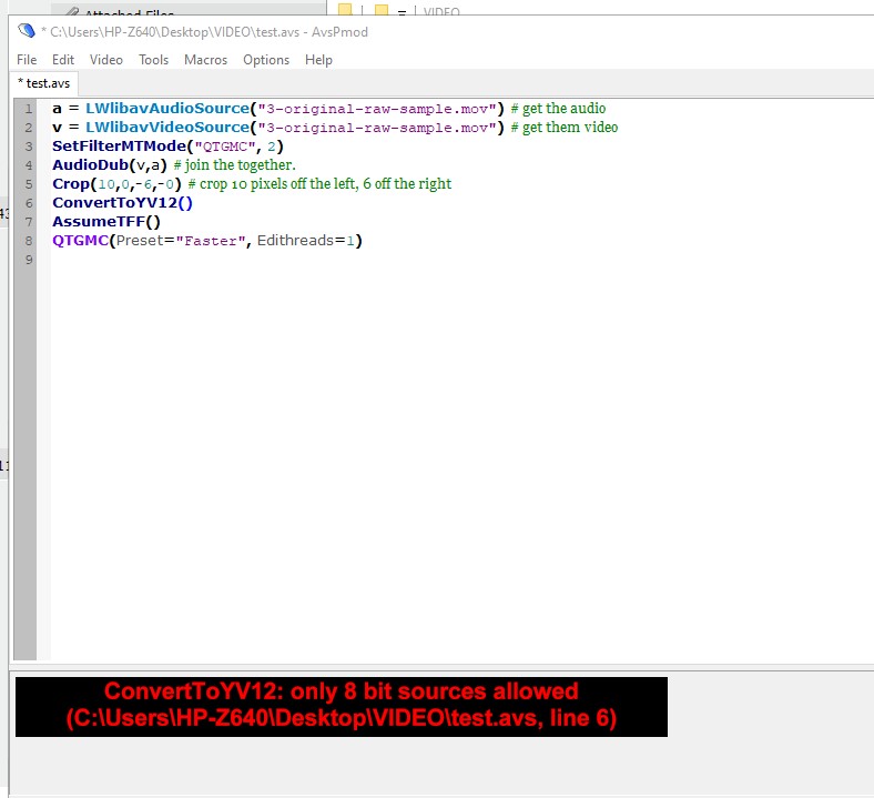

    Having issues using #ConvertToYV12() as this only works with 8bit ???
    so have discarded this command
    [Attachment 53615 - Click to enlarge]

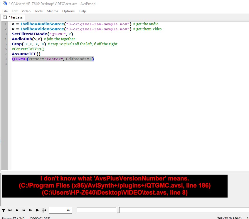

    Now when I try to use QTGMC with or without additional presets I get this STRANGE ERROR
    I don't know what 'AvsPlusVersionNumber' means ????
    [Attachment 53614 - Click to enlarge]
    Can anybody please shine any light please
    Thank you

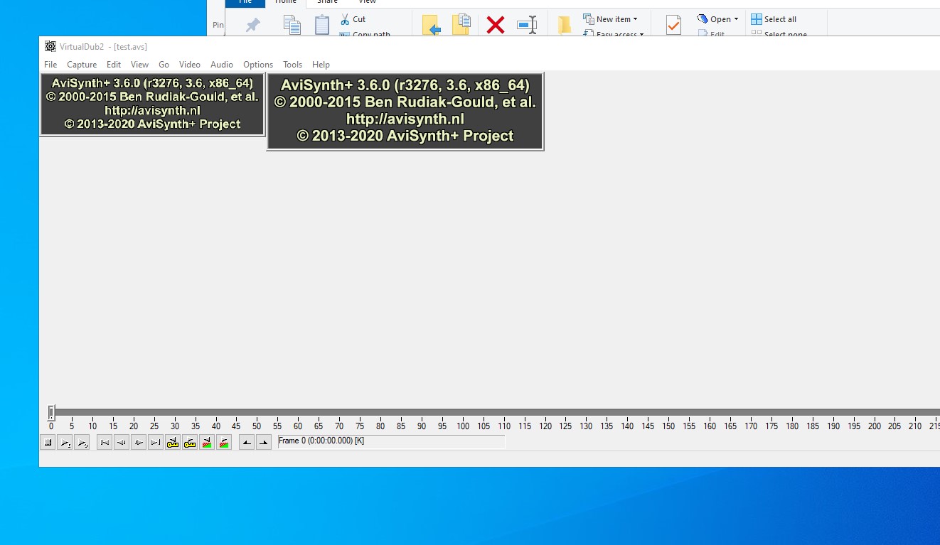

  2. Start with a simple script:
    Version()
    If you want to use both 32 bit and 64 bit AviSynth: open that script in a 32 bit editor and a 64 bit editor. I use VirtualDub2 for both. But I think avspmod will work (I don't use it). You should see something like:
    [Attachment 53616 - Click to enlarge]
    That will verify that both versions of AviSynth are installed and working.

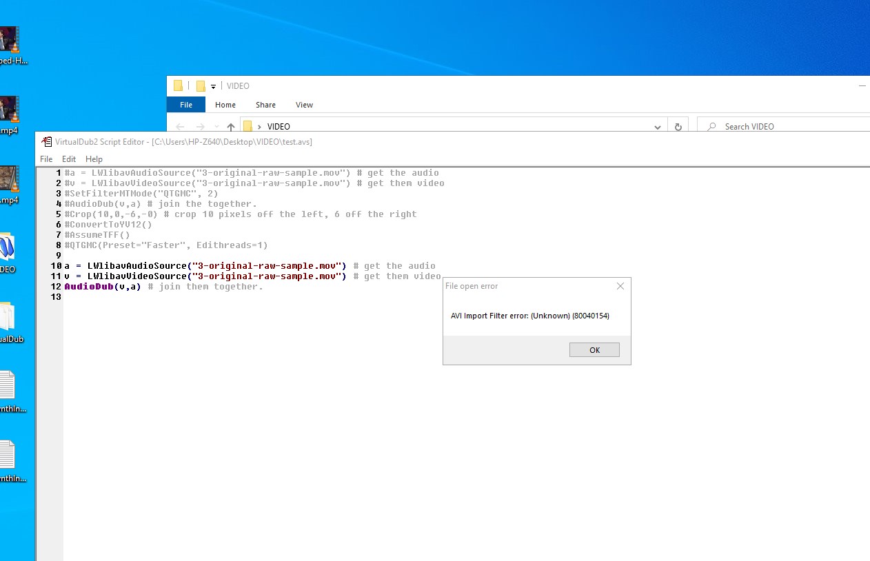

    running this script in vudub2 32bit works, plays video and sound
    but will not work in 64bit

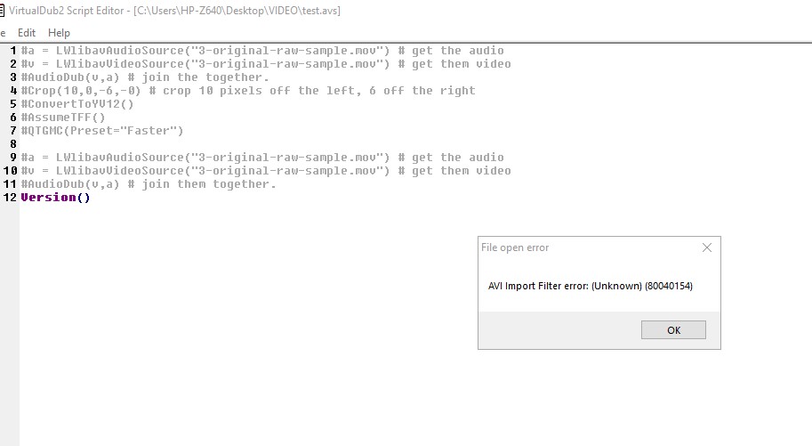

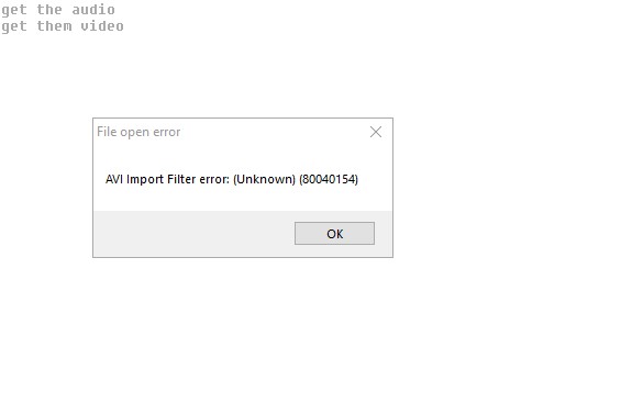

    generates this error
    [Attachment 53617 - Click to enlarge]

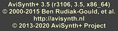

  4. Did you check both the Version script in both 64 bit and 32 bit? I believe that error means 64 bit AviSynth(+) is not installed. Look in C:\Windows\System32 and see if avisynth.dll is there. If so, view its properties, Details tab:
    [Attachment 53618 - Click to enlarge]
  5. Yes, it looks like avisynth+ x64 is not installed
    For the AvsPlusVersionNumber error , download Zs_RF_Shared.avsi and put it in the plugins directory
    https://forum.doom9.org/showthread.php?t=174121
    ConvertToYV12() - should be ConvertToYV12(interlaced=true) ; but avs+ and newer versions of QTGMC can work with 10bit422 . YV12 is 8bit 4:2:0 . It's not going to make a big difference quality wise with VHS input to keep 10bit or 4:2:2 ; but interlaced=false (the default setting) will cause chroma notching artifacts

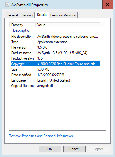

    [Attachment 53628 - Click to enlarge]
    this is the file I have in my system32
    I CAN NOT get it work with VUDUB2 64 only 32bit version work
    I have even uninstalled AVIsynth+ and all the plugins and reinstalled again
    still does not work on 64bit ? I am running windows 10 latest version fully updated

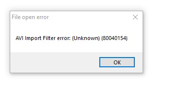

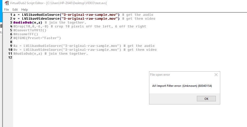

    This is the error I get
    [Attachment 53630 - Click to enlarge]

  7. Originally Posted by Johnnysh View Post
    If you use a 64 bit editor you must have 64 bit AviSynth installed and 64 bit AviSynth filters. If you use a 32 bit editor you must have 32 bit AviSynth installed and 32 bit AviSynth filters.
    That's VirtualDub telling you that it can't read the AVS file -- presumably because the right AvISynth version isn't installed.
    That problem will go away once you have all the right filter versions installed.

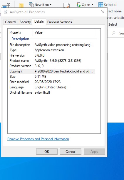

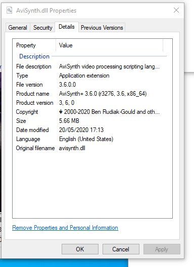

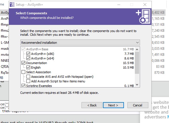

    Ok this is what I get by default when I install AVISynth+
    [Attachment 53631 - Click to enlarge]
    and I also leave both 32 & 64 ticked, yet it still will not work in VUDUB2 64 ??
    this is no installing AviSynth to program files only to the x86 programs folder
    just tried unticking the x86 which uninstalled the x86 version, yet VUDUB 32 still works ? and VUDUB 64 still not work ?
    Is it because I am loading both 64 & 32, should I only choose one out of the two to use / install
    here is the version I have under my syswow64
    [Attachment 53632 - Click to enlarge]

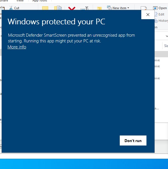

  9. Another install method you can try is groucho's universal avisynth installer
    https://forum.doom9.org/showthread.php?t=172124
    Apr 2010
    London
    Thank you for the help
    ok have tried installing / uninstalling AVISynth with that new installer and still no good ??
    is there something wrong with VUDUB do I need to add any 64bit plugins ??
    could never imagine this could be so difficult
    please just remind me why we are using AVIsynth and VUDUB

  11. Try running the AviSynth+ installer as Admin?
    As noted earlier the AviSynth+ installation doesn't write anything to the "C:\Prorgram Files\", all the support files go in "C:\Program Files (x86)\". If there isn't an avisynth.dll in C:\Windows\System32\ 64 bit AviSynth isn't installed.
    And I don't think you ever answered the question of whether the Version() script ran in both 32 bit and 64 bit.
    Apr 2010
    London
    Hi
    Ok just tried running AVISynth installer as admin and.......
    [Attachment 53633 - Click to enlarge]
    is this normal ???
    Oh I have overrid this and installed even with this error ??
    and yes when I try and run the scrip in 32bit mode it work in VUDUB
    yet this script generates this error when trying to run it in 64bit VUDUB
    [Attachment 53634 - Click to enlarge]
    Regards
  13. Originally Posted by Johnnysh View Post
    What script? The script I'm talking about is the simple Version() script in post #2. That doesn't require any plugins. If that doesn't work 64 bit AviSynth is definitely NOT installed.
    And that error MS Defender message probably related to the problem. Where did you get the install file?
  14. Not sure why x64 avisynth will not install for you...
    Was the reason for this "adventure" just QTGMC ? Another approach would be to use some GUI like hybrid , or staxrip, or megui , which can run on "portable" avisynth versions. I think Hybrid and staxrip can also use vapoursynth version of QTGMC
  15. Another thing to try is 3.5.1
    That newer 3.6 version breaks compatibility with many plugins and programs . It's a lot of headache and growing pains right now . (I'd actually recommend not using it unless you're helping debug things for developers)

    Hi
    ok
    script that will not work in 64bit
    is simple script
    a = LWlibavAudioSource("3-original-raw-sample.mov") # get the audio
    v = LWlibavVideoSource("3-original-raw-sample.mov") # get them video
    AudioDub(v,a) # join the together.
    I get this error
    [Attachment 53635 - Click to enlarge]
    I did try Hybrid and staxrip can also use vapoursynth version of QTGMC
    it did work but lots of setting and was under the impression that AVISynth was the way to go for the best results
    but not sure now, just seems headaches all the way
    will TMPENC do the job, I was going to purchase that
    but just was hoping for the very very best results, thats why I have spent 5 days trying with AVISYNTH
    but now starting to get very very deflated with AVISYNTH
    regards
  17. Originally Posted by Johnnysh View Post
    is simple script
    I get this error
    That's not the simple script. It requires a 3rd party plugin -- a plugin that doesn't come with AviSynth+. This is the simplest script, from post #2:
    Version()
    It doesn't require anything other than AviSynth+ be installed. This is probably going to give you the same error but it's the first step in analyzing the problem.

    Hello
    Thank you for the reply
    Ok simply script and same error
    [Attachment 53636 - Click to enlarge]
    Regards
  19. So it's certain that 64 bit AviSynth(+) is not installed.
    Windows is much pickier about installing 64 bit software (depending on version and settings). I think you're going to need to run the install as Admin and by pass the warning.
    But first, from where did you get the version you're trying to install? From this web site?
    https://www.videohelp.com/software/AviSynth-Plus
    On the other hand, 32 bit AviSynth is apparently working. Why don't you just use that?

    London
    HI Guys
    Happy Days are here again
    ok after much much playing around in win 10 I have managed to get the 64 bit version of AVISynth in and running in VUDUB2
    with the very basic script
    #a = LWlibavAudioSource("3-original-raw-sample.mov") # get the audio
    #v = LWlibavVideoSource("3-original-raw-sample.mov") # get them video
    #AudioDub(v,a) # join the together.
    #Crop(10,0,-6,-0) # crop 10 pixels off the left, 6 off the right
    #ConvertToYV12()
    #AssumeTFF()
    #QTGMC(Preset="Faster")
    #AudioDub(v,a) # join them together.
    Version()
    VERSION()
    this is what I get in the 64bit version of VUDUB2 when I drag the script (VERSION) over VUDUB2
    [Attachment 53695 - Click to enlarge]

    the only error is ConvertToYV12()
    it complains it only works with 8bit video

  22. Originally Posted by Johnnysh View Post
    So is there a 10bit solution for ConvertToYV
    and the aim is to convert to 50fps deinterlaced at the VERY VERY best quality I can achieve from my 10bit captured video
    File size is not important also would like the best audio quality too guess this will be 360Kps mp3
    See post #5 . You don't need ConvertToYV12() . And if you include it before deinterlacing, it should be interlaced=true
    If you want to convert to 4:2:0 8bit, then
    ConvertToYUV420(interlaced=true)
    ConvertBits(8)
    Technically if you wanted the "best", you started at 10bit 4:2:2. But it's not going to make much of a difference for your source
    You can add prefetch(some number) at the end to multithread for faster processing
    eg.
    prefetch(4)
    mp3 is lossy audio, so technically not the "best". But it's not going to make much of a difference for your source
