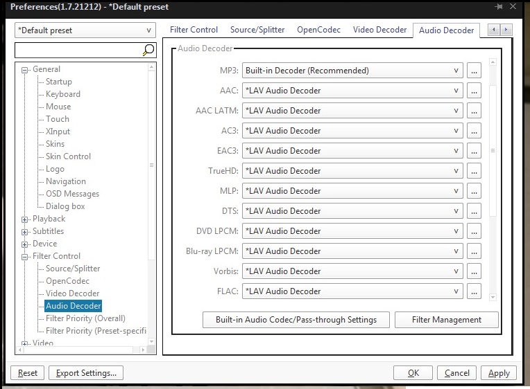

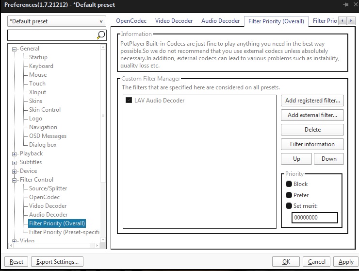

  15. One last question if I may
    [Attachment 53556 - Click to enlarge]
    [Attachment 53557 - Click to enlarge]
    [Attachment 53558 - Click to enlarge]
    As you can see the current player ONLY has lav filters added as external filters and ONLY has lav in the drop down menu for audio formats, yet for some reason, somehow is using ffdshow filter and at the time of typing this message atleast is actually working, all formats are being sent correctly, I am expecting them to break any second. FFDshow isnt even supposed to be installed on my system anymore it was all uninstalled with revo yesterday, just downloaded an older version of potplayer whilst downloading jriver to have one last crack at getting things back to how they use to be.
    But does anybody have any idea what the hell is going on with my system?

  16. Maybe potplayer uses it, JRiver doesn't
