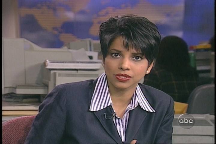

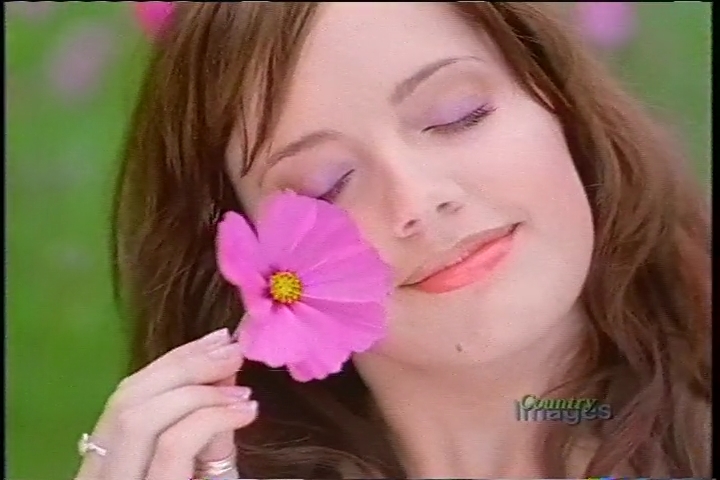

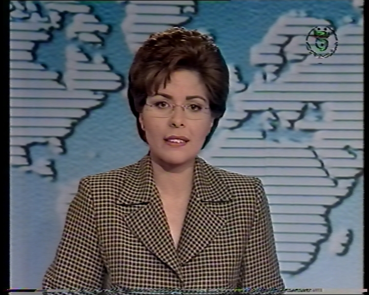

    I capture from different sources (VHS, S-VHS, Betacam, PAL, NTSC...) and I find it hard to make a rule on which one to go for since some of the videos will loose some of the active video information if cropped all the way down to 704 with a fixed area of cropping (some videos have more black pixels on the right, some on the left). Cropping the 486 to 480 is a no brainer but I'm kind of lost when it comes to the horizontal resolution, I guess the old saying one size fits all doesn't really apply here.
    Here are some of frame grabs of some projects I'm working on right now:
    VHS NTSC
    S-VHS NTSC
    BetacamSP NTSC
    VHS PAL

  4. What capture cards actually do depends on the drivers and on the chipset, despite all standards and known PARs, DARs etc. One usually does not know the details about how the analog signal is captured, hence a general recommendation other than doing the circle test cannot be given IMHO.
    Looking at your pictures I would say that the 3rd picture (BetacamNTSC) is stretched slightly horizontally. You should probably resize the active picture to 704 pixels horizontally and add left and right borders of 8 pixels width each to make it 720 overall in this case. It would also return the abc logo with a circular shape rather than an ellipse.
    Jan 2016
    All images are stretched horizontally except the PAL one, that is because the aspect ratio flag is not active in jpeg picture file, But that's not the problem, The question is whether to crop the side borders to 704 or leave them alone as 720.

    I picked a video with a large circle for testing and I measured the circle in 720 mode with 4:3 aspect ratio flag and then from the master files I made a sample that I cropped to 704 with the same 4:3 flag (SAR 10/11) and the 704 sample gives a perfect circle with an almost identical H and V diameters to the mm precision on a 24" monitor so this confirms the ITU-Rec 601 (CCIR-601 or D1) standards is adopted by my capture device which is a good news, I will test with PAL files later.

    720 resolution later in the digital production used the full 720 as active video pixels for anamorphic materials known as widescreen DVD's and 16/9 camcorders. It would have been better if they set the standard to 720(active video)+16 lines but they didn't so when we crop the captures to 704 we have to give each pixel an aspect ratio of 10/11, a slight horizontal squeeze to fit in the 4/3 frame which is the reverse action of what was done by the capture card, that's why the circle checked out.
