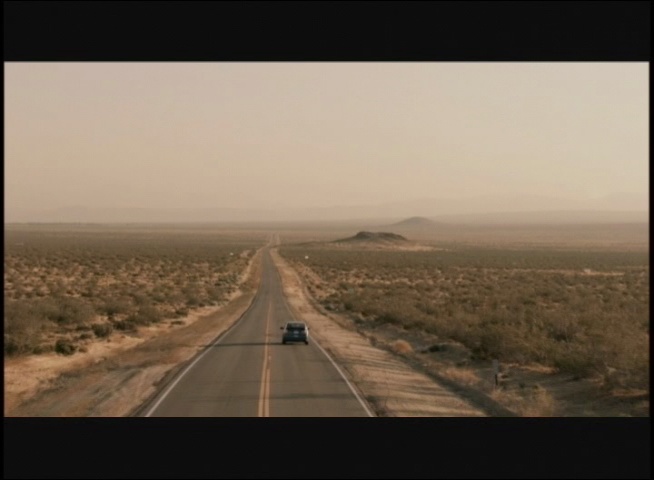

    4:3
    16:9 (letterbox)
    When DVD standards were set, 704 was included for legacy compatability with D1 (including Digital Betacam and other derived digital 4:2:2 formats). The black side bars were dealt with during authoring. For context, keep in mind that the entire SD film transfer library (4:3, 16:9 or 16:9 letterbox) existed on D1 or Digital Betacam tape.
    If I recall correctly, DVD kept 704 PAR for 4:3 but allowed for 720x480/576 PAR for 16:9 to fill out the width. I need to look into this.

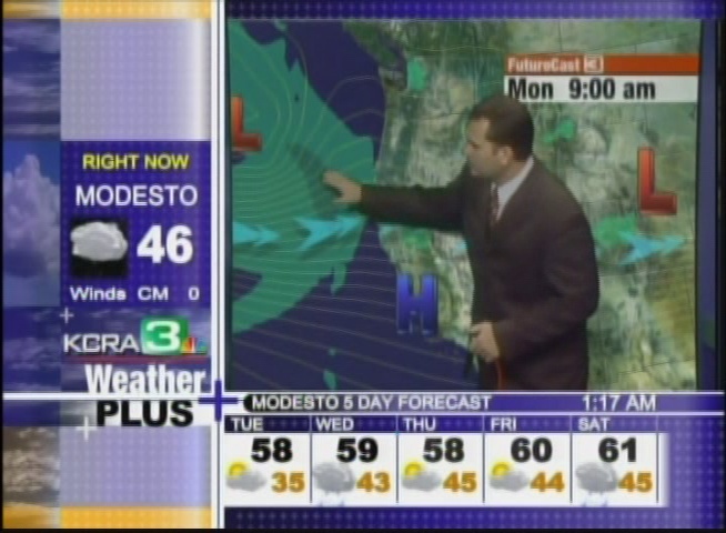

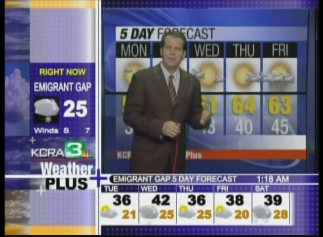

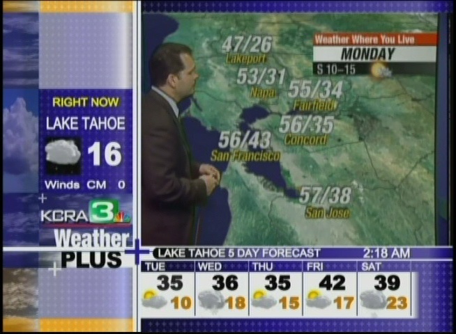

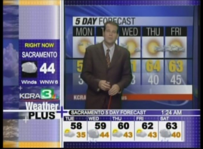

    I tested 352x480, 704x480 and 720x480 on a ATI AIW-8500DV using a SD composite input off the cable box. I captured to DVD MPeg2 in these cases and saved frames from the Vegas timeline with 720x480 project settings.
    352x480 and 704x480 scaled to look identical. 352x480 uses pixels exactly 2x width vs. 704.
    352x480 (AIW-8500DV)
    704x480 (AIW-8500DV)
    720x480 uses a wider PAR (pixel aspect ratio) to fill out the 720 pixels.
    720x480 (AIW-8500DV)
    The Canopus ADVC-100 also uses 720x480 PAR with no options.
    Added:
    Here is AIW 704x480 capture with 704x480 Vegas project setting resulting in a true 4:3 aspect ratio.
